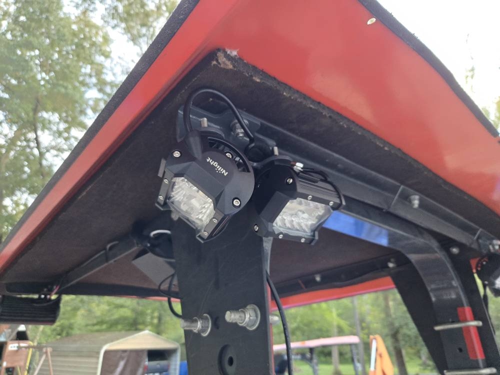

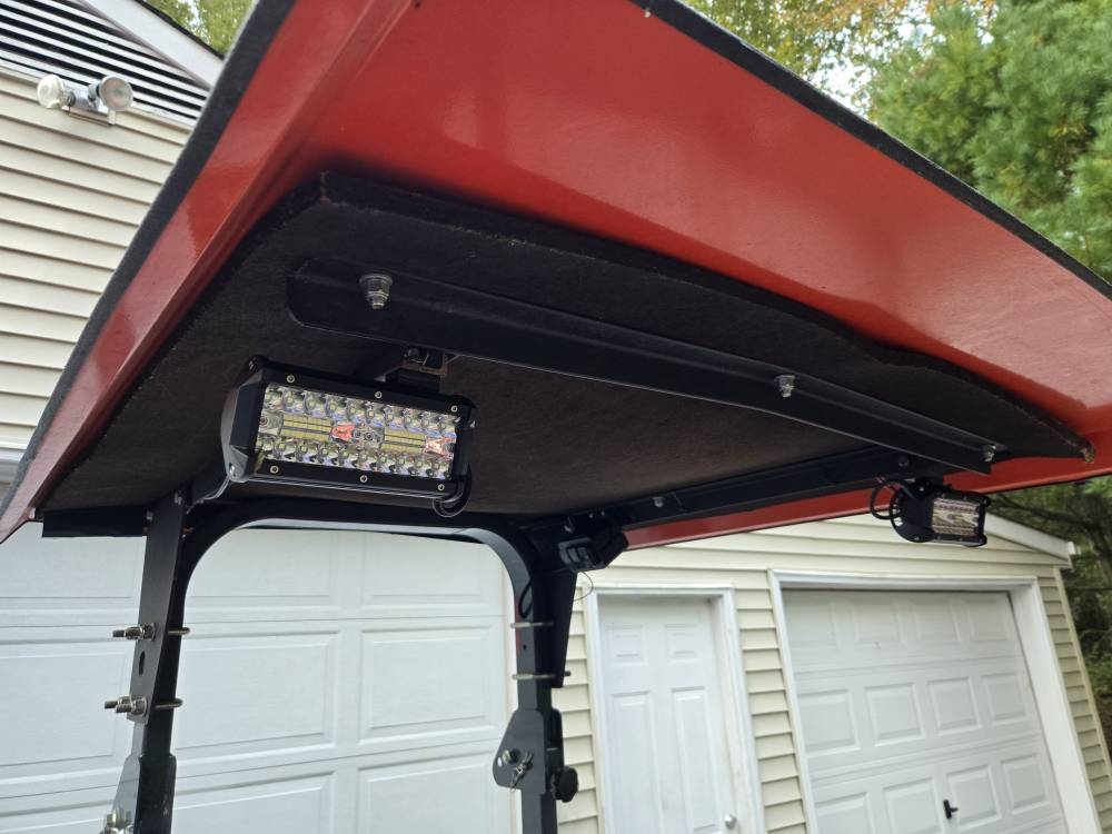

Do you have a canopy? This is what I did on my bx2680 for lighting.
Front:
Rear/side:
(there is a pair on each side)
Fantastic light coverage! Total load is 8amps measured.
