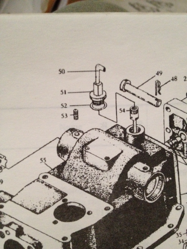

While doing ground work it developed some hydraulic fluid leaks. The hotter it got the more it leaked. . Two of the leaks were two missing plugs on top of rear axles. I plugged them with bolts. I assume these were to bleed air out??
My main problem is that it's leaking out the bottom of steering box above shifter. Doesn't appear to be a line connection, but leaking around bottom plate. How do you get access to the bottom bolts to tighten? I can get a wrench in it, but no room to turn. It looks like they'd have to be a lot of parts taken off to tighten bolts?

Now I've noticed my PTO is not working. Tractor drives fine and lift arms work. I had a fluid leak but have stopped that pretty much. I've added some fluid and adjusted clutch out but still does not work. It was working before I used a dirt scoop a few hours. Is there anything else I can check?

#9
Must be my lucky day. It WAS the lever by lower right heel. So many levers guess I got confused.
I'm still wondering about the two small threaded holes are for on top of rear axles? I plugged them so fluid wasn't coming out. It was just strange that they were both missing.
Still looking for best way to get to bottom of steering box too under dash.
Is there a good diagram somewhere of parts exploded view

/ Leaking steering box on farm pro 2425
Ok, I've got the diagrams. Part 53 is just listed as a screw.

/ Leaking steering box on farm pro 2425 #11
Sent from the mountains
Have pics? There are two grease zerks on back of my axle housings that I put a few pumps in a year never seems to fill up lol...
