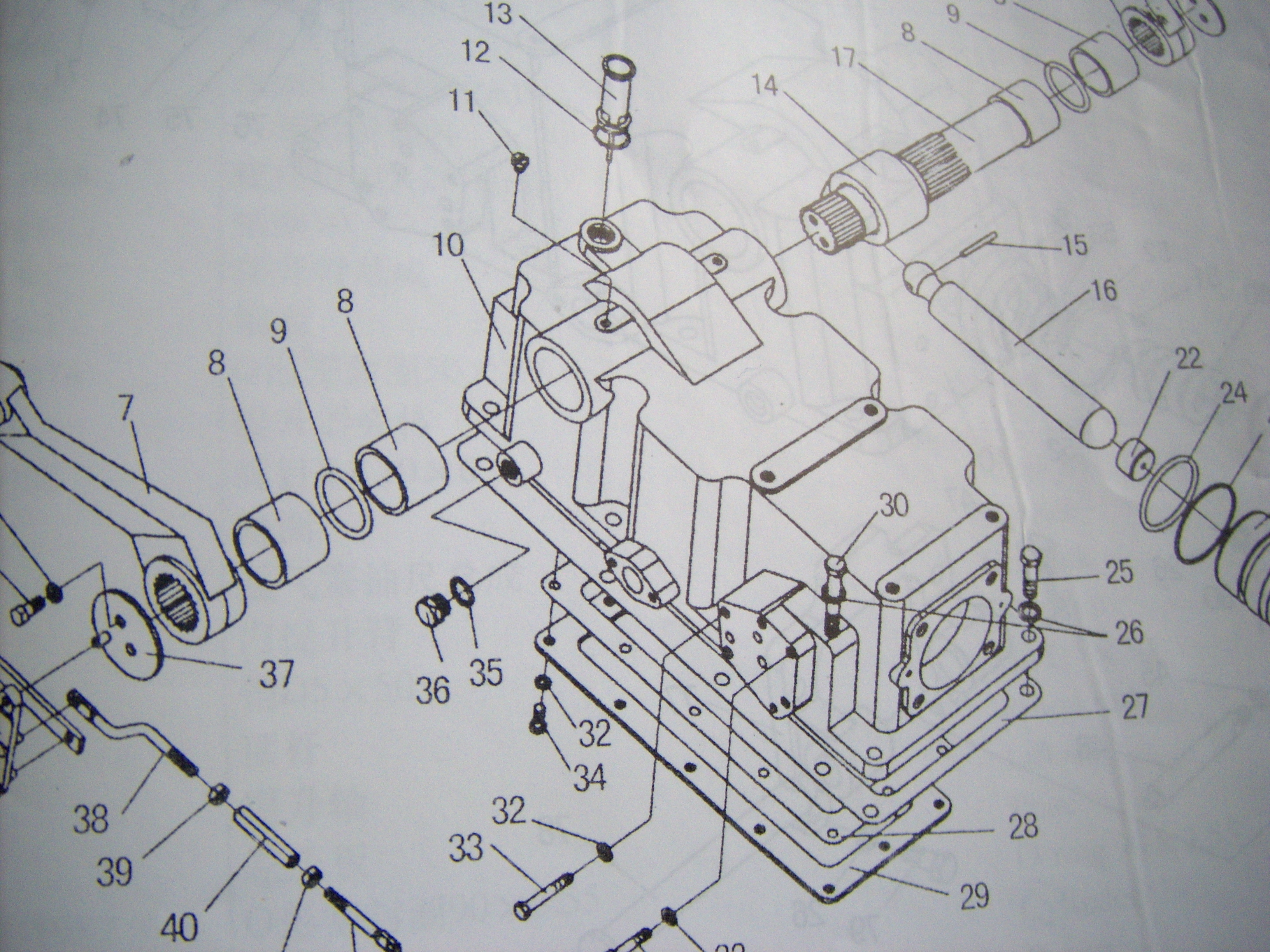

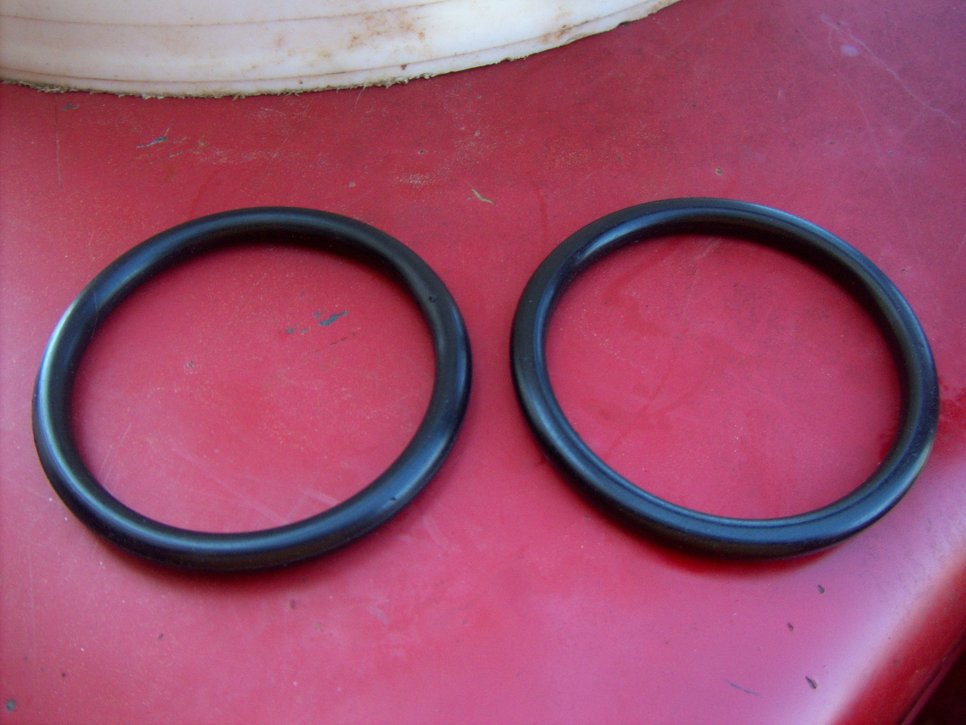

Have a light leak from where the lift arm attaches
Diagram shows o-ring on both sides of shaft that controls lift
Just wondering if a complete dis-assembly is required to get to the o-ring (If that is cause) ?
I see that o-ring & gasket "Kits" are available for rebuild but lift works great otherwise
Thanks, David

On this 300 series tractor diagram shows a couple bushings & o-ring on each lift shaft
Just wondering if o-ring is inside or outside of box
Probably remove seat & top for more closer observation
Lift works great, so I was not gonna do a complete dis-assembly
David

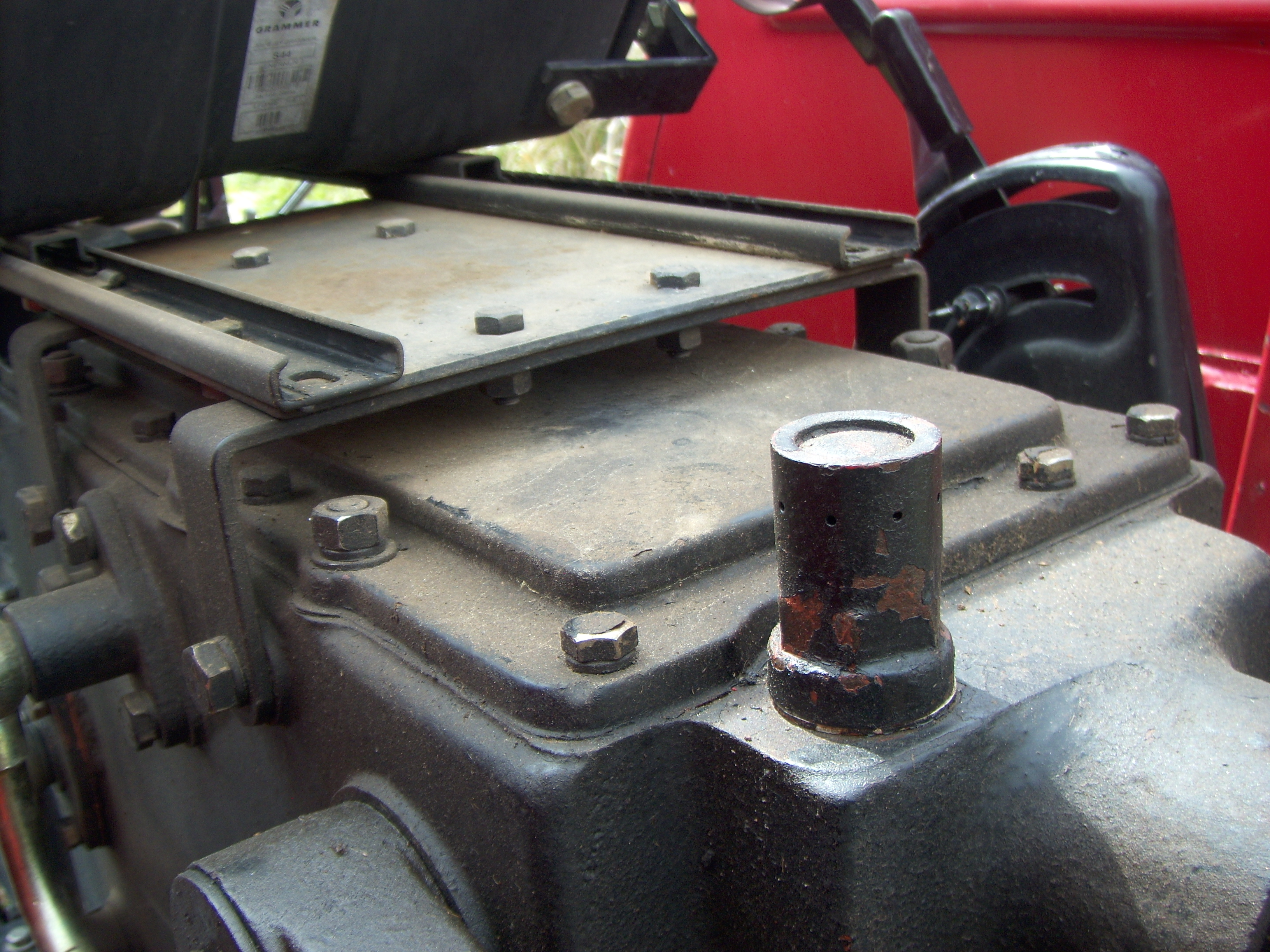

As pictured, this Jinma has a top cover on the tank
The diagram in manual does not show the top cover
I have drained & replaced filter & new fluid when I first bought tractor, draining is no problem
Just not wanting to get in to a major rebuild over a small leak (I have about 8/9 gal fluid)
David
Gotcha - yours is definitely different than mine. The manual is pretty accurate for my 2004 model. It looks like they made some improvements on later models - removing the tank cover without draining the fluid would really save time (and fluid) compared to the way I have to do it. Good luck with it - hope it's an easy fix for you.

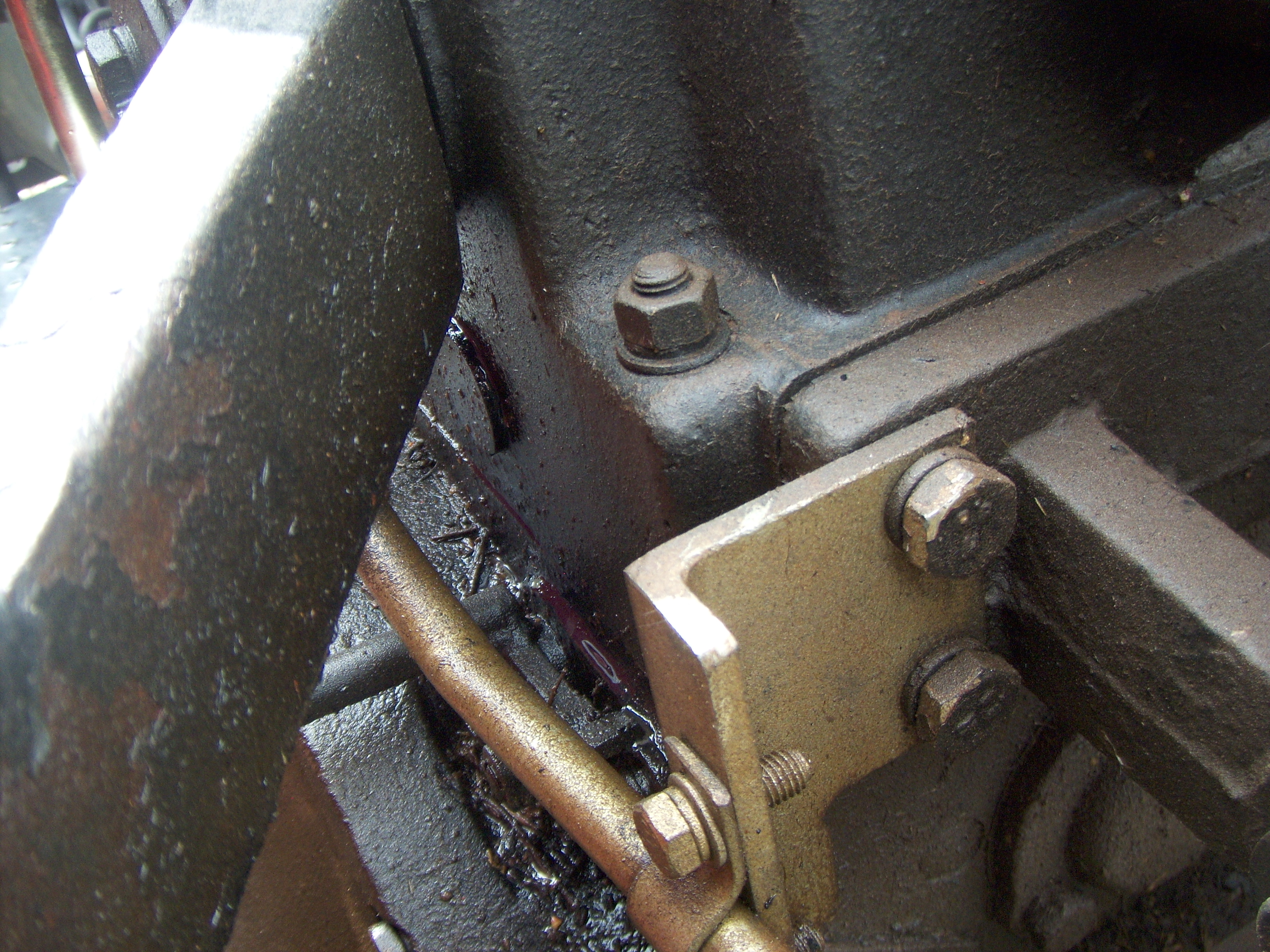

It was a pretty simple fix on my JD 4300. I took off the lift arms and removed the bushings and O-rings. Put the new ones in and tighten back up. Took about 15 minutes. In my case, there was a slight leak and after a quick investigation, the bolt holding the lift arm on backed off a bit and the O- ring jumped the bushing. The schematic on yours doesn't look that different than mine.
This is how I found it
Fixed

I ordered the 2 O-rings from the parts schematic I have, hope they are right ones
David

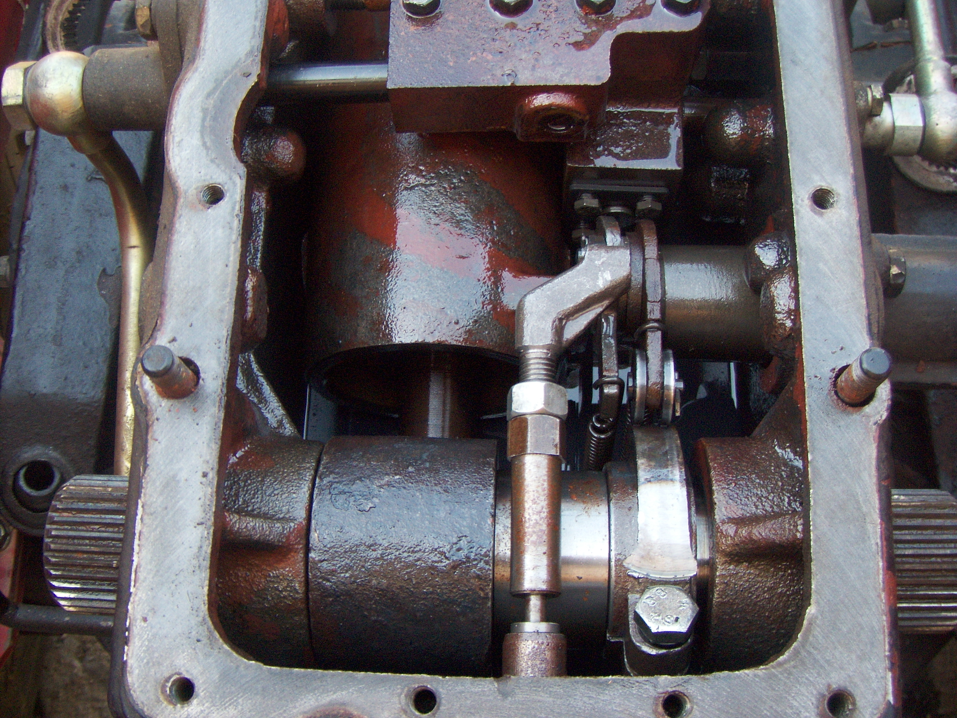

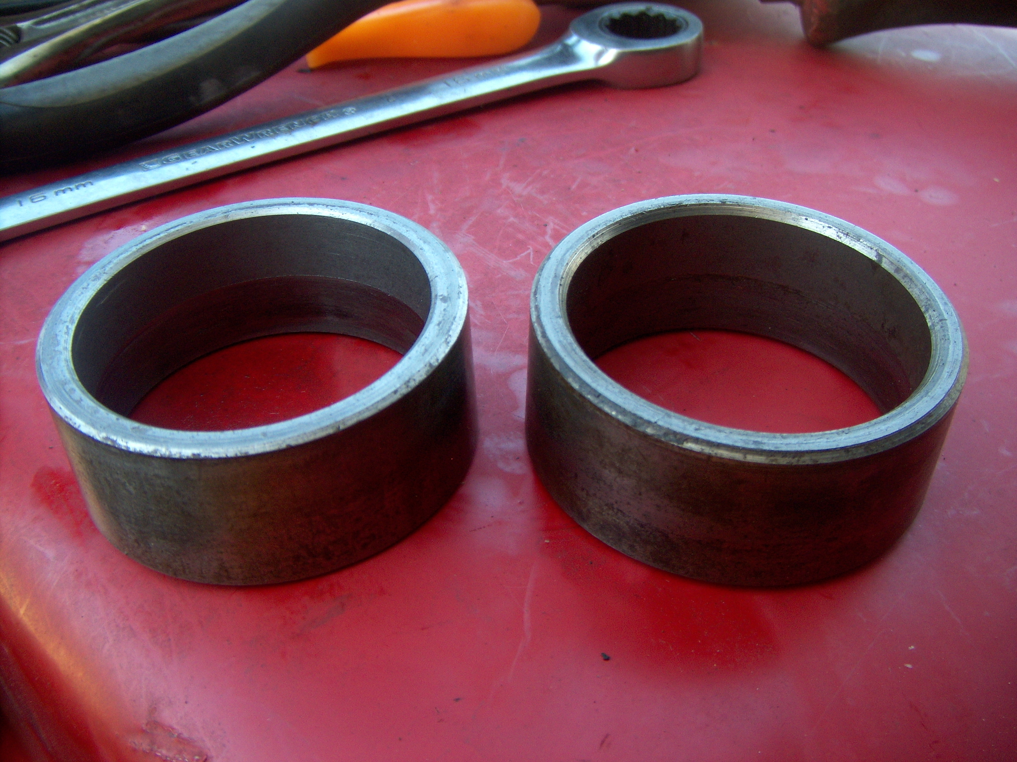

Well, of course the O-rings were too small will try to match at local hydraulics shop tomorrow
I did dis-mantle & got a look inside & I am a little confused.
I got the outside bushings & the O-rings out, but could nor figure out how to remove the inside bushings, removal not needed anyway to replace just the O-rings.
Pictures added
Looks like the insides have to be removed to get shaft out.
The O-rings looked pretty good, the leaky side had a lot of oil on it, the non leaky side was dryer, bushings look like no wear also.
Can't figure out why this set-up doesn't leak anyway, after removing O-rings & outside bushings, arms & shaft had some play on both sides, vertical & horizontal.
I think I should have lived with the leak, or waited until leak much worse
David

OK, Thanks to Circle G I did get right O-Rings
I marked the lift arms when removed, but I must have re-installed wrong.
Lift now does not engage until nearly at top, Pressure is great "Too Much"
