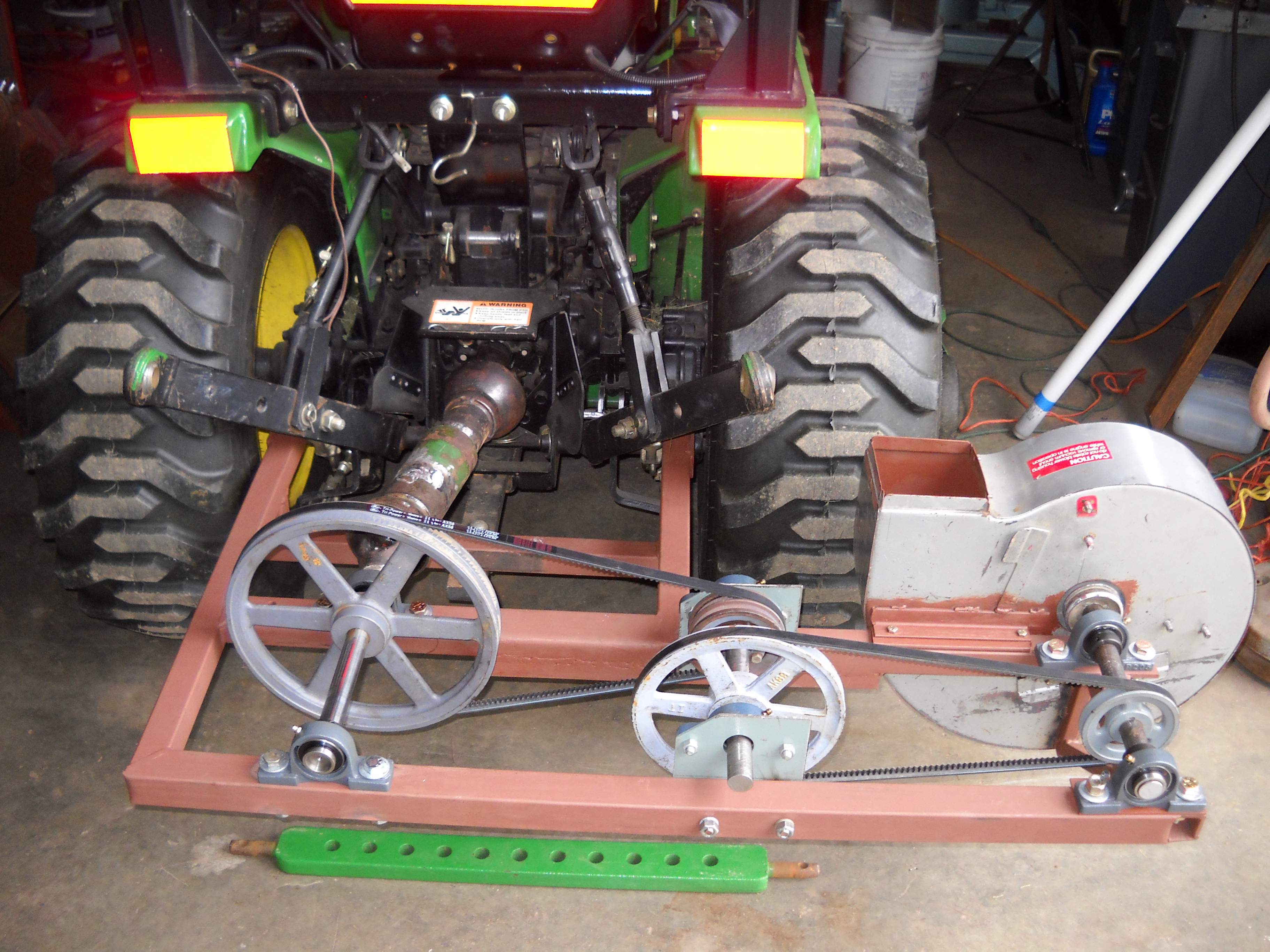

Not to hijack your thread but someone mentioned powering a leaf vac with a PTO. This is my version of PTO power without the added expense / maint, of a seperate motor. I have the basic platform finished along with the 8" take offs for a flex hose to connect the 4110s mid mounted mower to the vacuum. I was planning on a similar trash can holding containers due to compactness and ability to grab and unload onto the transport trailer. I also built a 14k 12' dump trailer so it will eliminate the hand unloading. I am primarily interested in vacuuming pine needles that I am so blessed with. This is a cheap and easy build ( if it works out properly ) less that seventy dollars so far. This is a great site to share and learn new approaches to everyday problems.

That is a great Job. :thumbsup:
