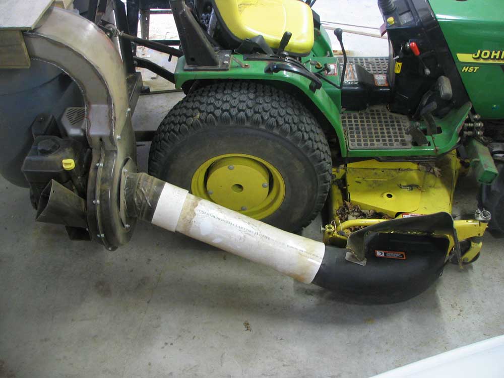

Side view showing 6" PVC pipe connecting JD mower boot to intake of blower housing. Also shows welded sheet-metal output chute.

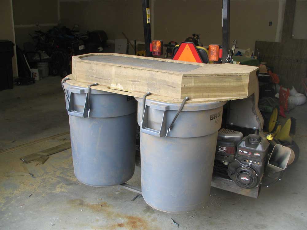

Rear quarter view showing plywood box on top of Rubbermaid trash cans. Vent screen is visible on top.

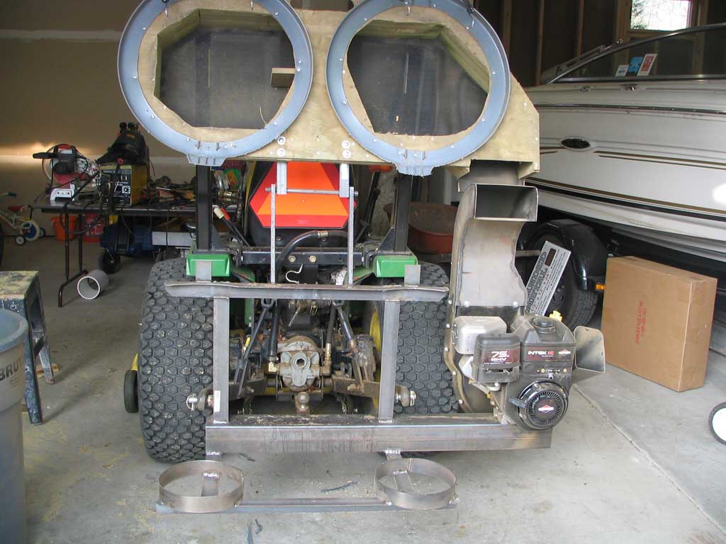

Cans removed to show frame. Cans rest on the edges of flats bent into hoops. The hoops fit into a round recess on the bottom of the Rubbermaid cans. The trash can handles fit over a vertical tab on the frame, but now with the hinged top, I am thinking of removing the tabs.
I used it to vac all the leaves in my yard abd it worked well. Because the grass had not been mowed in a few weeks while I was constructing this, I picked up a lot more grass clippings than leaves. I filled my 78" x 10' trailer about 18" high with clippings and leaves from my 1/2 acre yard.
Hopefully I will get around to painting the frame and metal parts before I put the unit away until next mowing season!
