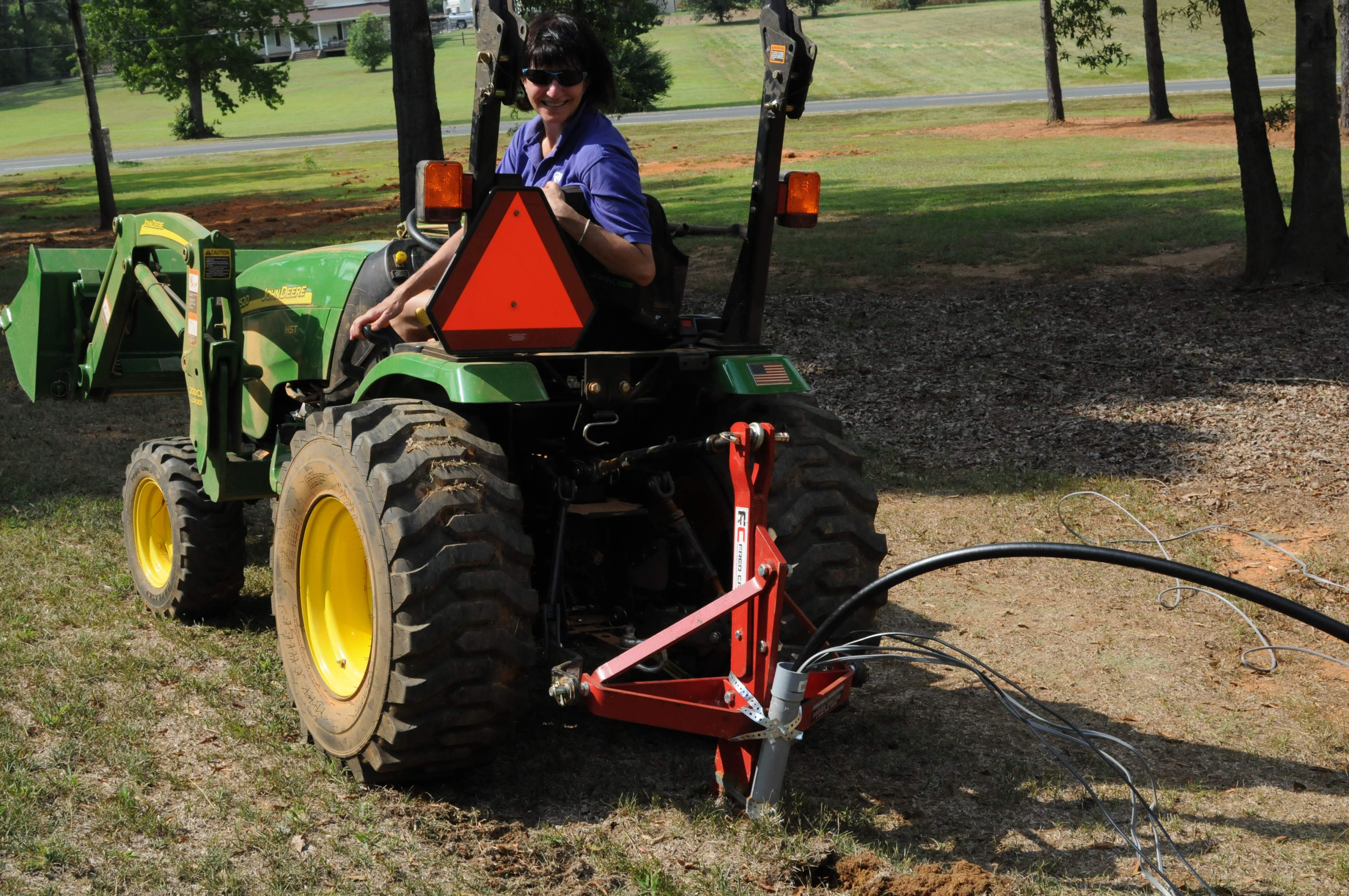

   / Laying water line across pasture #10
Here is what we use - a sub soiler with 2 inch PVC attached.......
