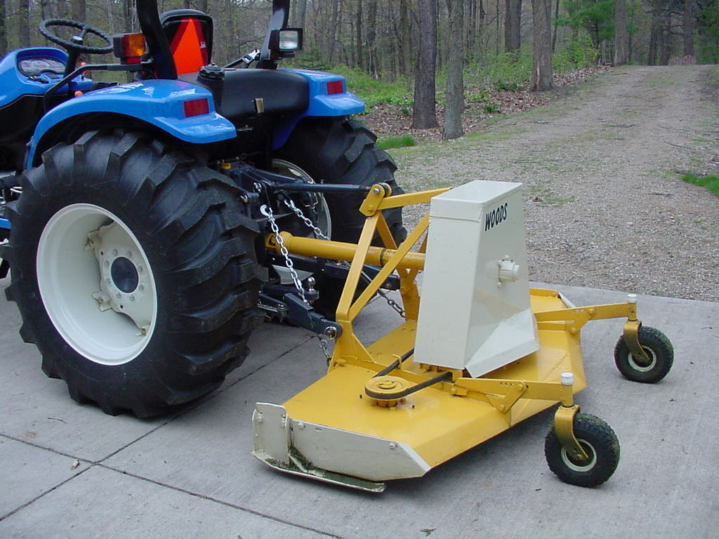

Attached is the "check chains" setup I have used for years to keep the mower (and same on my brush hog) mowing level. To use this setup you must have a flexible top link connection at the mower and merely lower the 3-pt control to the lowest position. On my brush hog, I don't have the turnbuckles since the height adjustment is less critical. With this setup, unless mowing on extremely unlevel ground, you are virtually assured of level mowing. Just drop the 3-pt control all the way and mow.
