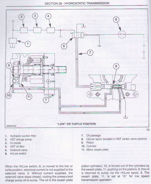

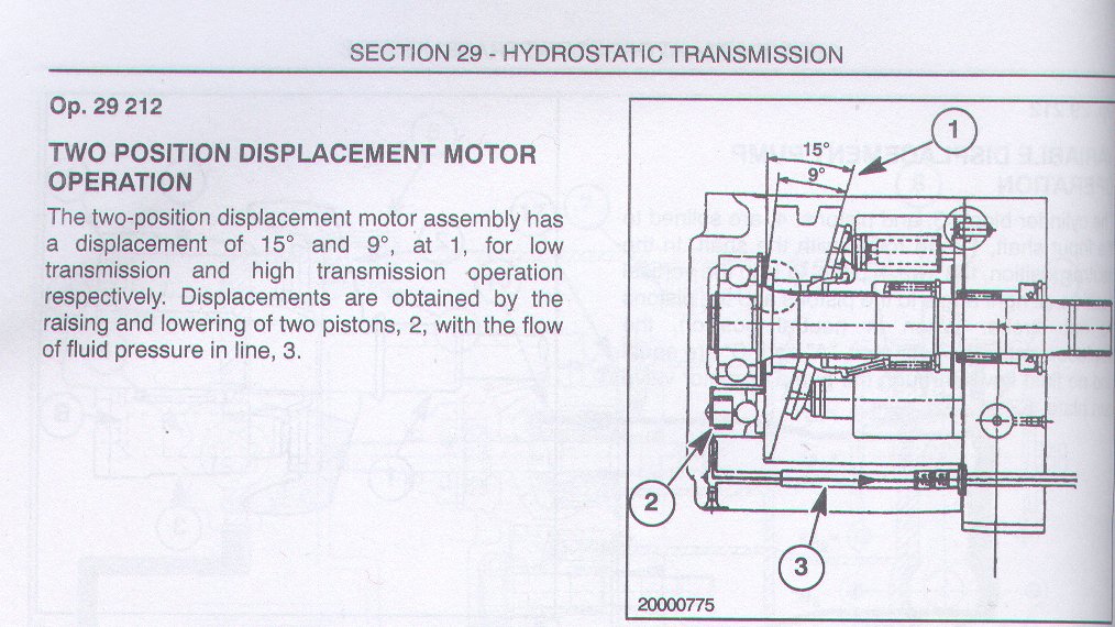

/ Larger capacity hydraulic pump #10
Mark,
Yes, I have the TC35D (an HST model). In fact YOU convinced me to get the HST! As I stated the motor is 2 position (9 and 15 degrees) and is operated by elect switch. The HST pump operates in the normal manner (by variable position swash plate). I do have the service manual (which is how I understood all of this). Remember the HST relief valve discussion ? If you are interested I'll scan a couple of pages for you.

HST pump and motor are contained in the same housing (much like a Kubota I expect). Here is a scan from the manual. Notice the pump and motor in the bottom picture.
Peter

/ Larger capacity hydraulic pump #17
Here is the operation of the motor in the low speed (high displacement position).
