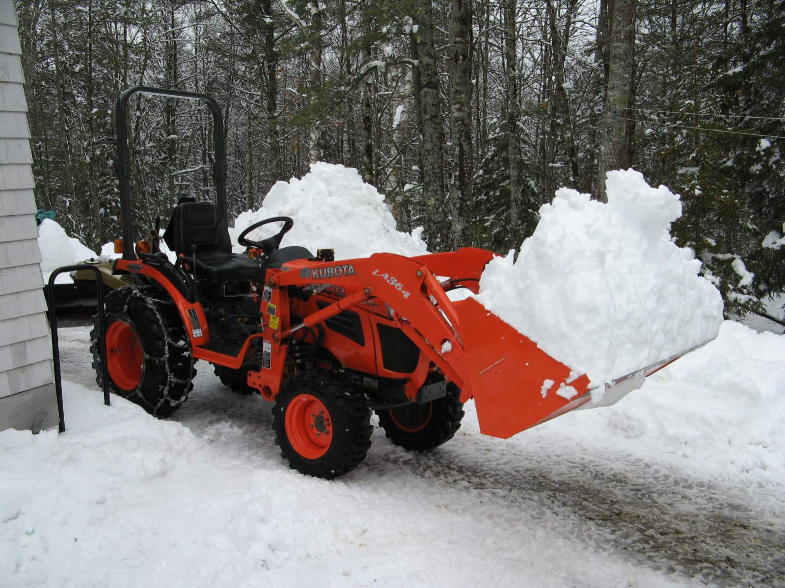

I've got the large bucket on my b2620 with the QA - also the b3200 forks. It's great. With loaded tires and Ballast box I'm fine.
Did you get the QA for that stuff...or just go through the trouble of removing the pins?
/ Larger bucket #19
Yes, I got the QA. I swap the two buckets (small one has a tooth bar) and forks and a homemade snowplow around quite a bit. Works good. I can pick up what I need to for homeowner type work, fairly decent sized rocks etc. It will even lift the large bucket filled with dirt or gravel but I don't do that to much.
