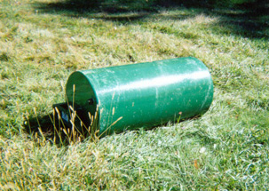

I needed a roller for similar type work as what you are doing and got a tow behind lawn roller this past summer for my BX. If you want the roller to really accomplish anything it is going to weigh way more than your 3pt will be able to lift. In my opinion you want to be looking for a tow behind roller that can be attached to 3pt receiver attachment so you can tow it behind your tractor. There don't appear to be a huge amount of manufacturers of these out there - Agri-Fab makes some cheaper ones - but I heard from other posters on this forum say that they fall apart pretty easily as they are not real heavy duty. The one I saw that I liked was from Hoelscher Inc - realy heavy duty and weighed the most - but it was also expensive (prices are on the website). The one I ended up getting is very heavy duty, I filled it up with sand so it weighs in somewhere over 1000 pounds I believe, and worked really well rolling out the 3/4 stone/rock dust mix I spread out for my new driveway - check out General Welding and Fabrication . You will have to open the PDF version of their catalog to find the roller. I also attached a picture to give some idea of the heavy-dutiness of the roller.

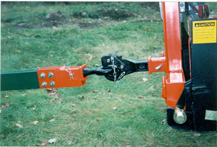

/ Large Three Point Yard Rollar - Do They Exist? #8
Picture of 3pt receiver adapter with roller adapted to work on pintle type hitch
