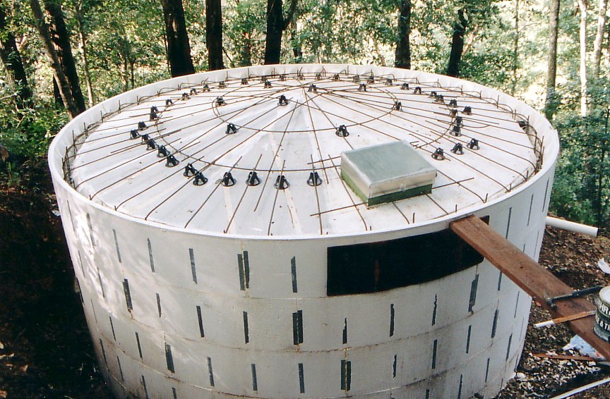

How big is your concrete tank and did you build it yourself? Been thinking of building one myself.
   / Large poly water storage tank question- #6
My tank holds 5000 gal, and is about 6' high and 14' in diam. Poured
in place using slightly curved Polysteel insulating concrete forms (ICFs).
Photo is just before the pour, which reqd 500 feet of pumper hose, and
150' of elevation. I did all the work except the pumping.
A cylindrical tank requires much less of a foundation than does a
rectangular one. A concrete tank is less prone to damage from
falling trees or limbs (big problem here).
