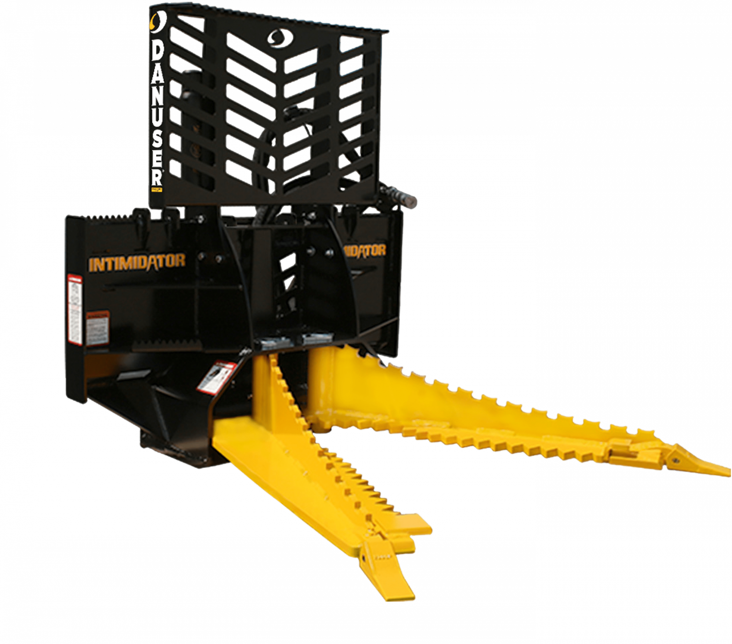

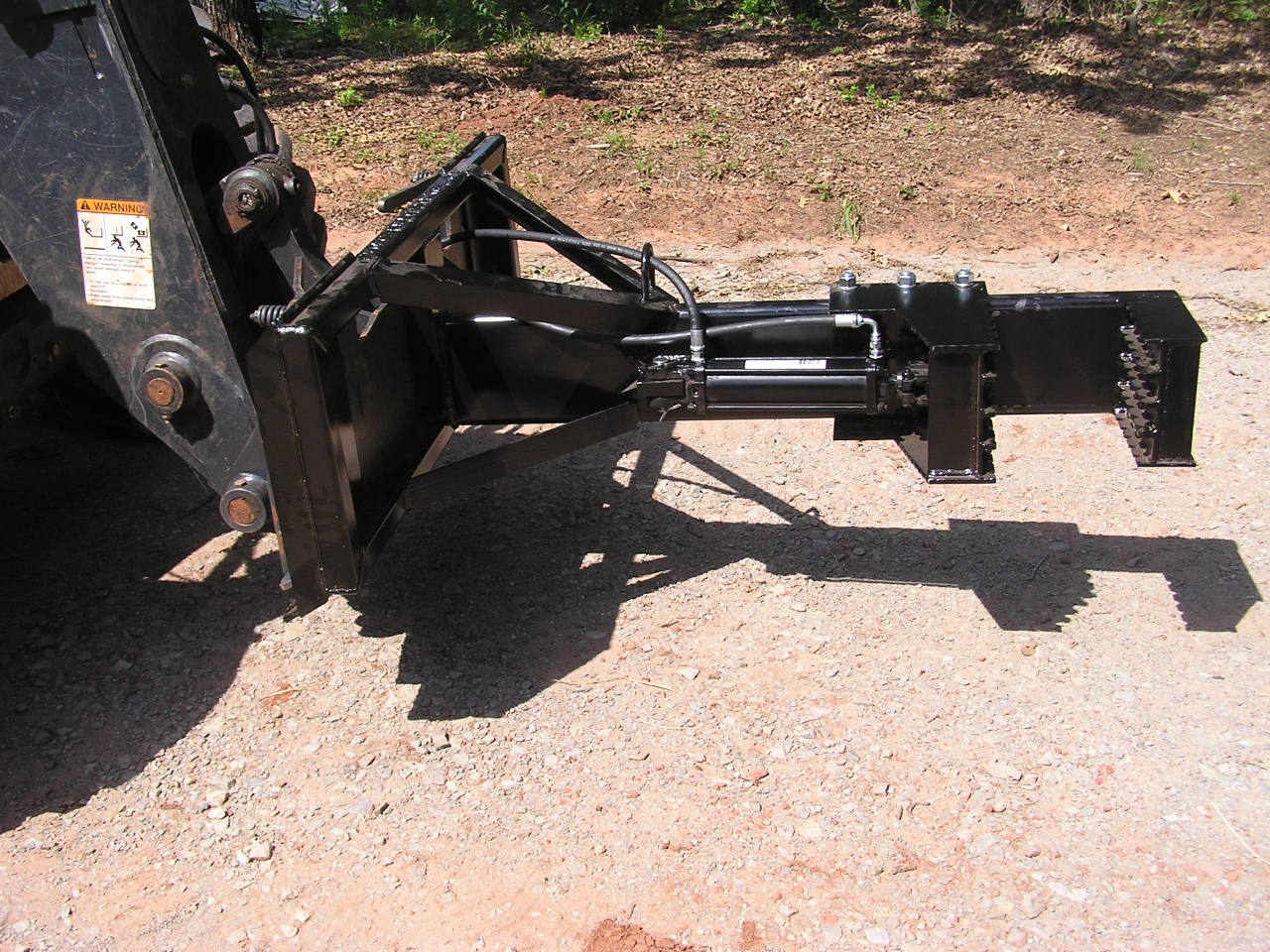

I recommend using a tree puller.
The Danuser Intimidator is highly praised here on TBN: Product Line Detail Page: Tree & Post Puller (Intimidator) | Danuser
Mine is a little different:

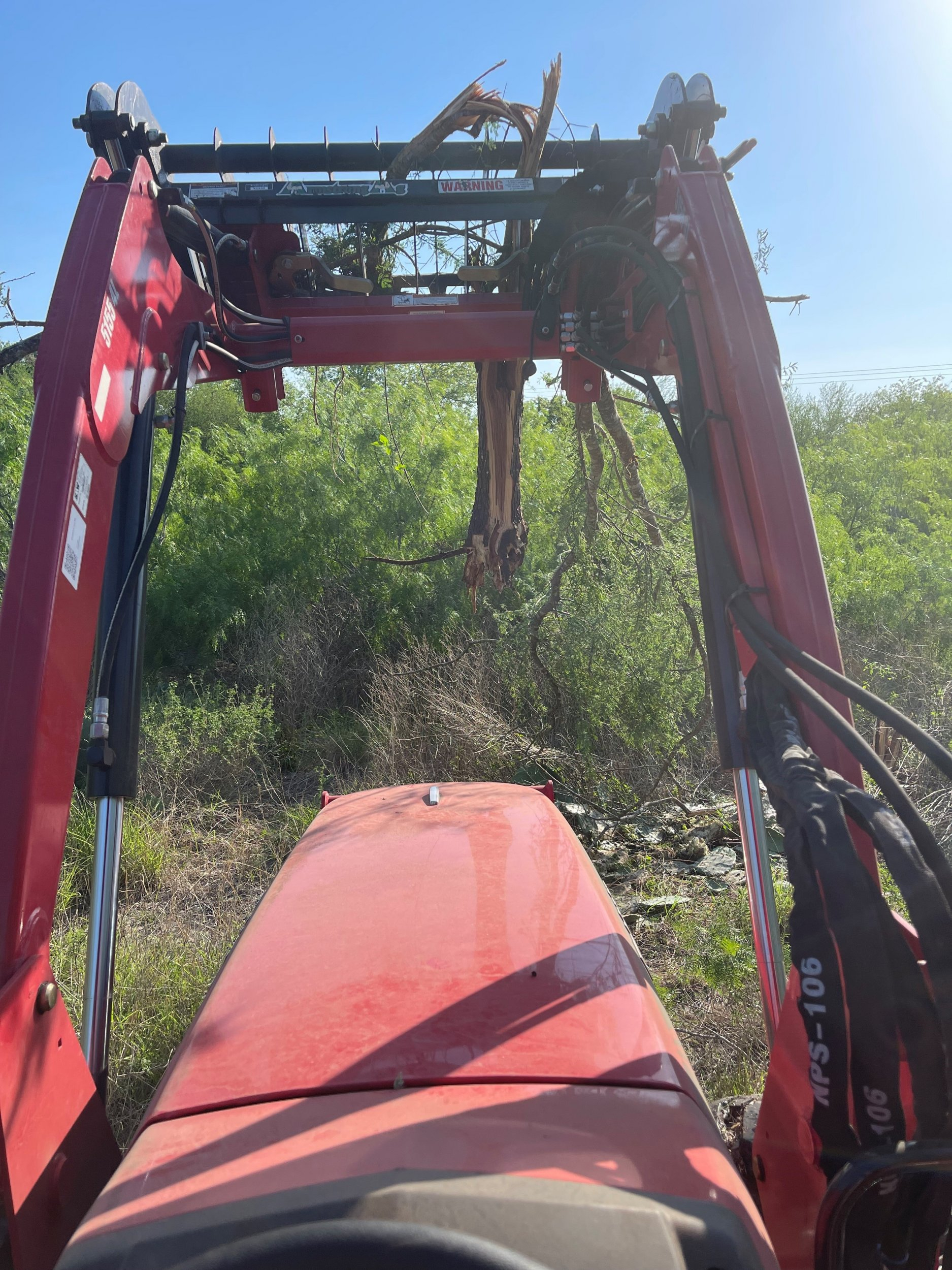

Drop the open grapple down on top of the brush close it and curl the grapple back to you (down or under) so that you are pulling against the hinge, not pulling against the lid then back up, most of that stuff will pull right out. I did this to my grapple by pulling against the side of the lid on a 6"+ tree.
keep in mind the tractor FEL is not a bulldozer blade and cannot be used as one, also never use momentum with an FEL.
it took me a couple of hours with a porta power to fix the grapple, fixing a tweaked FEL is a whole other thing.
A dedicated tree/post puller is not a bad option if you have the budget for another attachment, but the grapple will do what you want. keep in mind using a tree/post puller on a skid steer is a lot easier than on a tractor. It is a lot harder to see over the hood of the tractor where with the grapple you just grab everything.

Danuser Intimdator is a better tree puller than a root grapple. Highly maneuverable, precision and visible. Option to excavate and break roots for less ground damage from the root ball an advantage. Grab low, lift and dive forward to pull bigger stuff. Easily pulls up small stuff with little ground disturbance. Try to plan clearing in the spring where trees slip out of the ground much easier.
Don’t need a big grapple but one tough enough for your tractor. 30 year old skidsteer grapple still working well. Pull/push with tines not with the lids.
