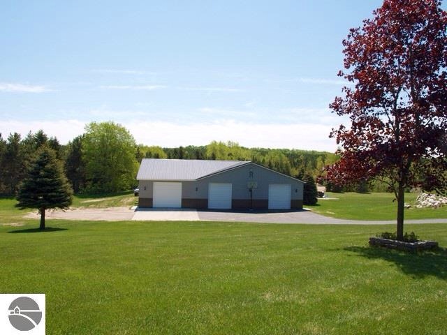

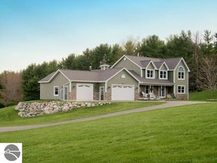

Absolutely gorgeous. Here is my 4 acres, cut every 4 days with a 60" grasshopper. The hills are steep, but I have a pattern to save the mower a undue stress IMG_0320.JPG IMG_0323.JPG

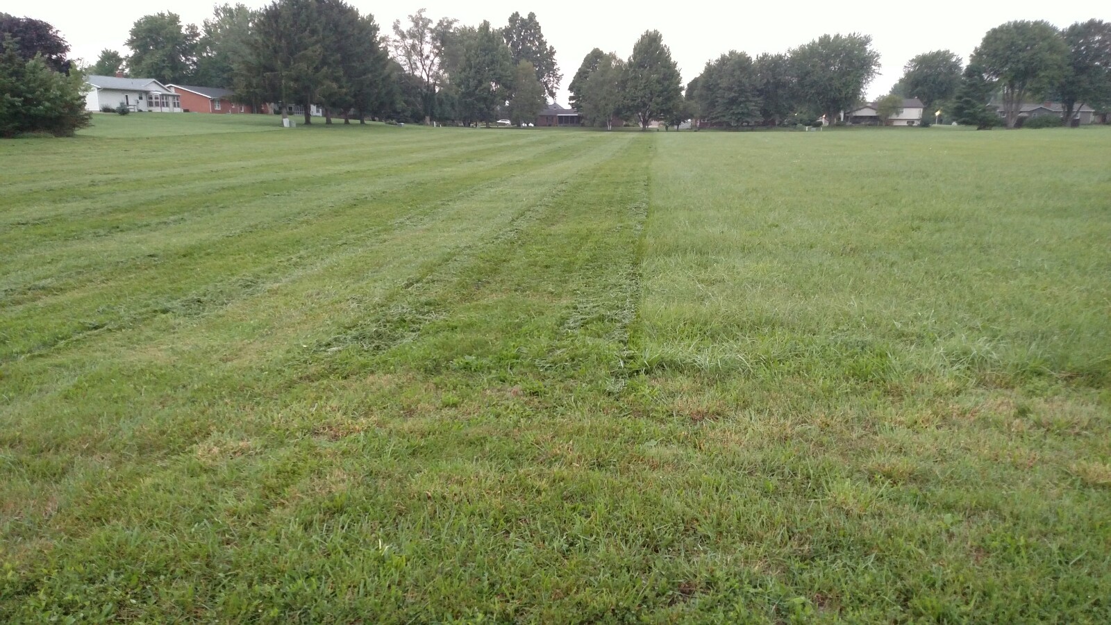

I have one account that is 10 acres. It gets mowed once a month. A month is too much growth for a finish mower. But a walk in the park with a rotary and sharp blades. Takes me about 2 hours to mow all 10 acres, and the results look excellent.
Yep, excellent job. That's what I'm talking about. You can do a lot of large acreage mowing efficiently with a rotary and a sharp blade and still get the result to look very good. You don't have to spend a ton of money for a finish mower or something more elaborate.
For reference, that was about 10-12" tall grass. Gets done once every ~4 weeks.....which is just too much for a belt driven finish mower. I cut at ~4"-5" height. And go as fast as my tractor will go in M range, which is something like 7.3 MPH. And that was cut with a woods DS96, 8' rotary cutter. Bought that mower used and spent almost as much $$$ as a new howse, titan, kodiak, or similar lower priced cutters. One big reason for getting the woods....16k fpm blade speed vs 11.5k for the three others I mentioned. JD, landpride, and bushhog® and some other higher end cutters also have higher blade speeds.
From my experience with many different cutters, 11-12k blade speeds stop giving a good clean cut once you go over 5-6 MPH. I have not found the limits of this 16k fpm cutter yet, as M range on the tractor dont go fast enough. I have (on the job I pictured), mowed with it in H at probably 8-9MPH with pretty good results. But it was too rough of a ride for my liking, and H range isnt good for maneuvering at turns.
