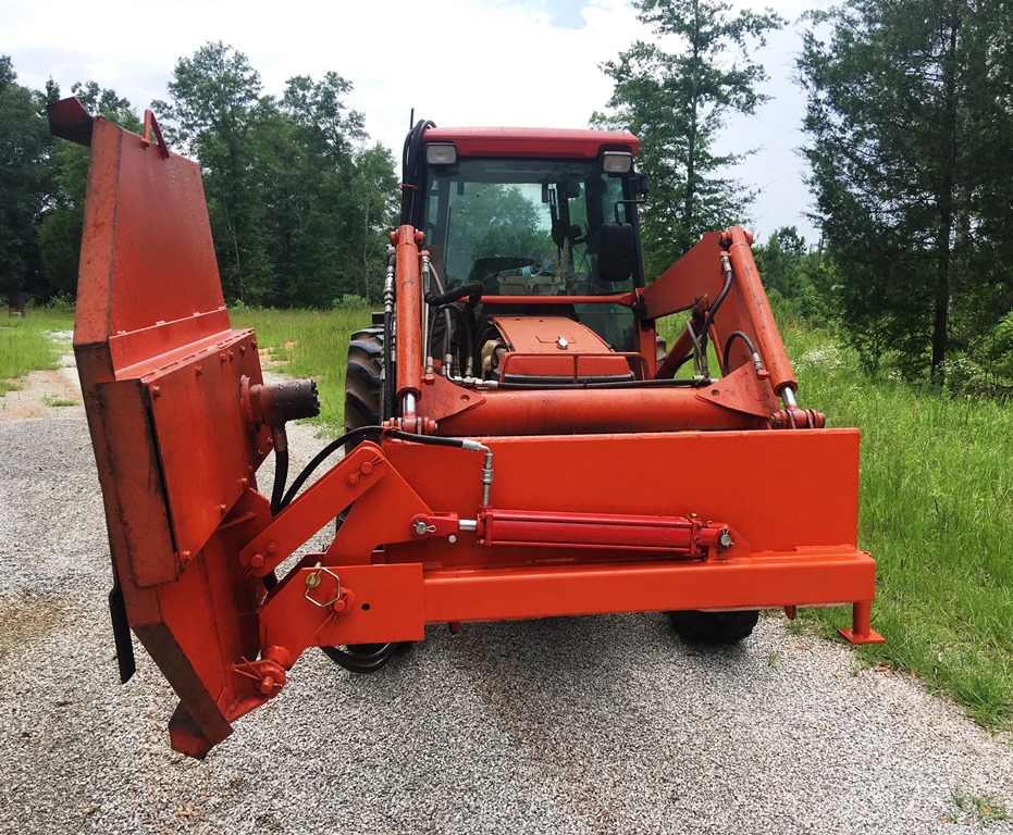

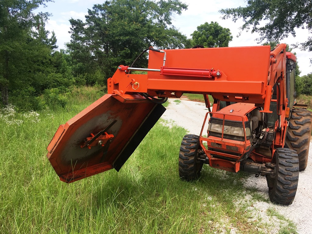

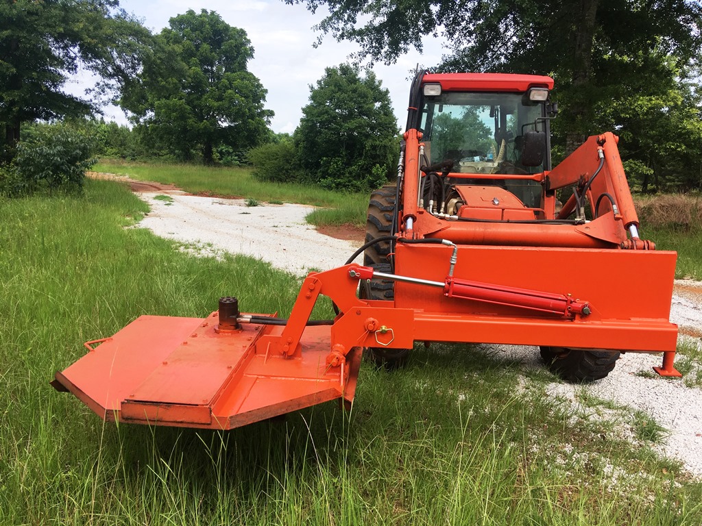

A brief history on the development of this type brush cutter. The original concept was the Limb Ninja about 5 or 6 years ago. The original design was in a fixed vertical position and was mounted to the bucket of the FEL using a 2" receiver hitch. Lane Shark purchased one of the original Limb Ninja and modified the design and started selling them commercially. I'm not sure how Titan got their design, but it certainly looks like a Lane Shark knock off.
I purchased one of the original Limb Ninja units and modified the design to be attached to a blank skid steer plate so it could be easily attached and unattached. I also designed a linkage system with a hydraulic cylinder attached so I could position the cutter deck at any angle from vertical to about 60 degrees below horizontal. The only issue I had with the original Limb Ninja design was the blade carrier. I redesigned the carrier and blades to have shoulder bolts and shorter bush hog type blades. That design works great.
This unit is one of the best pieces of equipment I have owned for what I needed it to do. I maintain an extensive road and fire break system on 950 acres. At my age, a pole saw is no longer an option.
Attached are some photos of the unit I built.

I would not feel comfortable using it on an open tractor. When used properly, it does not throw much out the rear of the unit. But it can.
I looked into selling my design but after talking to several attorneys, I decided not too. Just not worth the risk.

LWC4446 -- That is a great design. The only mode that it does not do is the straight ahead position. I am very impressed with the overall sturdy design looks and certainly like the hydraulic angle ability. What did you do with the hydraulic problems of "screeching halt" to the cutter when you move the FEL up or down or angle change ? Do you find the tractor hydraulic pump sufficient for robust cutting without bogging down ? I purchased a Lane Shark last year or year before. I had previously used a much larger heavier unit designed to be used with a skid steer and it was unsatisfactory when driven with my MF2660 hydraulic pump.

Can you briefly explain how you controlled the hydraulic tilt as well as ran the motor?
I'm assuming you used one pressure line from the remote to turn the motor and then had the return line plumbed to the sump. This gives you one extra line to run the tilt cylinder correct? I realize you can move the cylinder with the one pressure line, but I don't understand how it stays in place once you start the motor back up using the single remote lever. Am I just over thinking this?

Yes, Sktw8, that was my question too. Normally open-center hydraulics mean any time you initiate an action with one control lever you are halting all others. Lane Shark has some pretty well thought out help in that regard by free-wheeling the blades when you lift the loader or do other things. That also prevents the potentially damaging "skreetching halt" of the blades. What we cannot tell until lwc4446 comments is whether he MAY be driving his blades/motor with an auxiliary PTO driven pump rather than one of the remotes.
