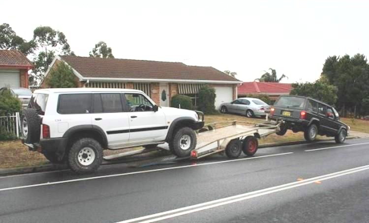

I would not recommend putting any boards/etc over the ramp unless they are firmly bolted down. Otherwise, the tractor tires will probably want to kick the boards out, since there will only be 2 wheels on the ramp most of the time. Seen many loading accidents where loose ramps or boards got kicked out from under a tractor.
Be sure to use 4WD and low gear when driving on and off the trailer (this enhances traction *and* braking should you need it). Be prepared for the rear of the trailer to squat when you first pull on or back off. Might need to block the rear of the trailer to prevent issues (at least be prepared to block it the first time until you get the hang of things). If your tow vehicle is light enough, you can even lift the rear of the tow vehicle off the ground! That's bad news as most vehicles parking brakes are on the rear wheels....
That will prevent this:
Bruce
/ Landscape Trailer
#11
Bruce, kind of did that once years ago with an old John Deere B and an old 1/2 ton Chevy I used to own. I was driving the tractor off a borrowed car hauler and looked... lo and behold the rear of the truck was a good 2 feet off the ground! Truck bounced once but it was fine.
