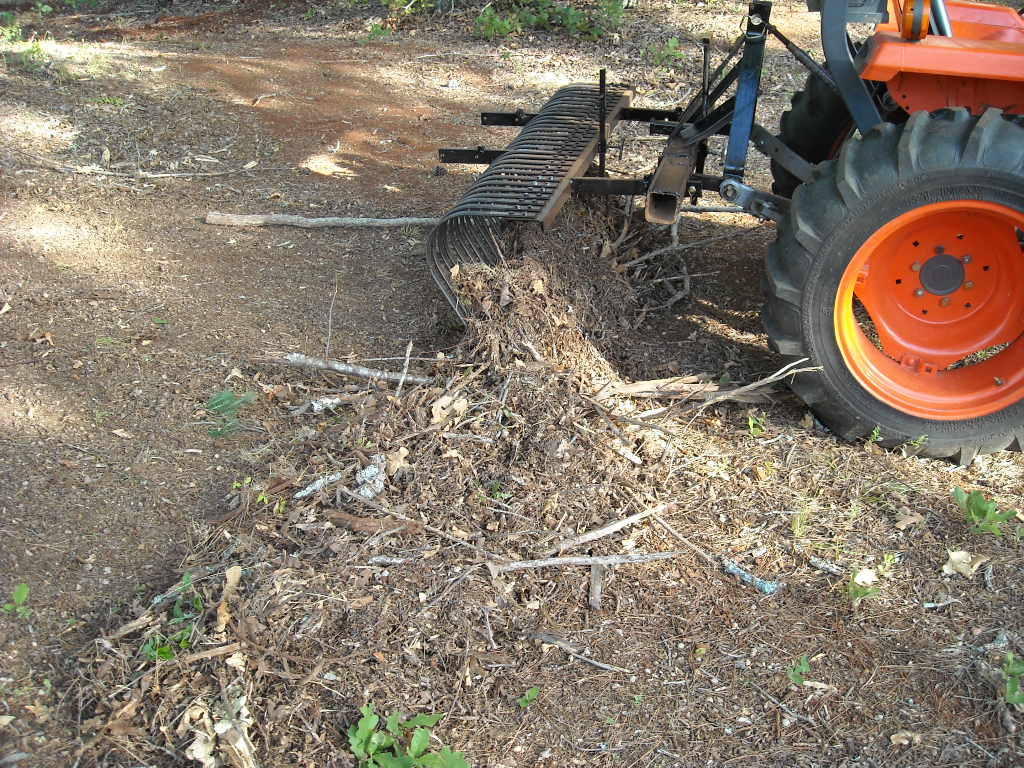

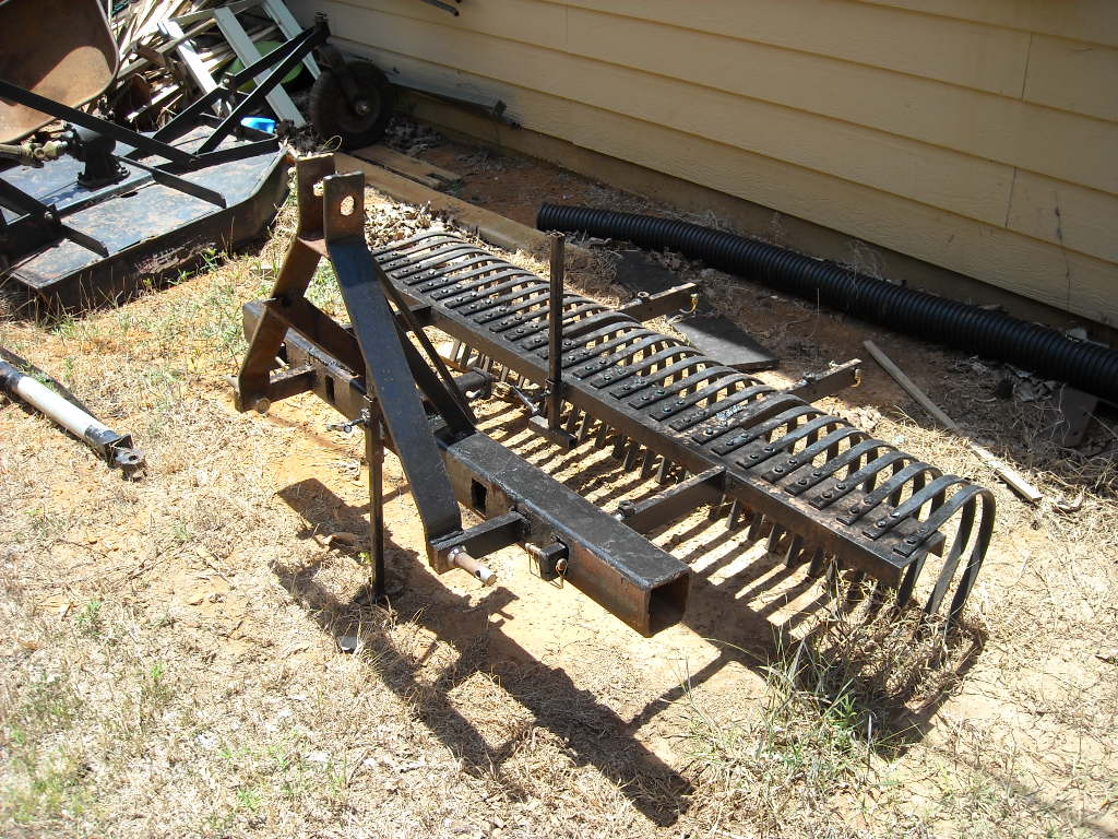

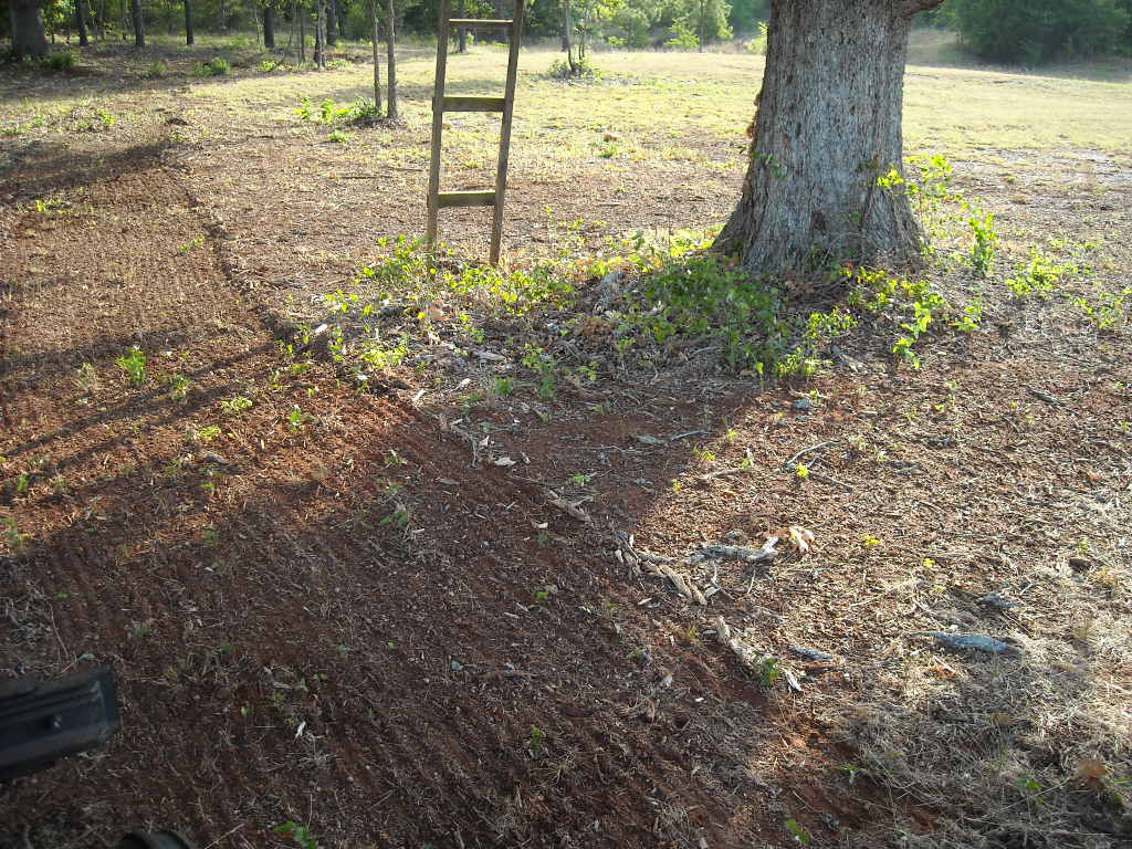

I made mine. Love using a rake, actually works like advertised. I flipped it around a couple times. REALLY bites the ground and will not let anything pass. Never needed guage wheels because I'm mostly raking up crap, leaves, twigs, maybe covering some seed, etc. I use a BoxBlade to move dirt if I need to. Much better suited IMO.
I did finally break 2 tines pulling crap from a next years food plot/garden. I can be a little rough on it at times. :D
I have to manually flip mine...but 99% of the time I just pull it.

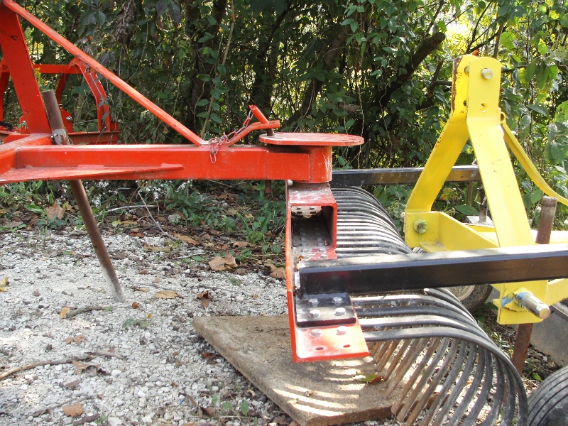

One rake feature that I find very worthwhile is the ability to offset the entire rake to one side or the other. This allows the tractor wheels to stay on a road or pond dam breast and rake the gutters or whatever to the side.
The black bar can be shortened or lengthend to get about 3 feet offset to either side. This works really well when I have to clean the leaves out of my property dirt road ditches.
The Landpride rake isn't cheap, but it sure is heavy and stout and has taken a licking so far. I have home made wheels for it, but haven't installed them yet as it works good enough so far without them.
