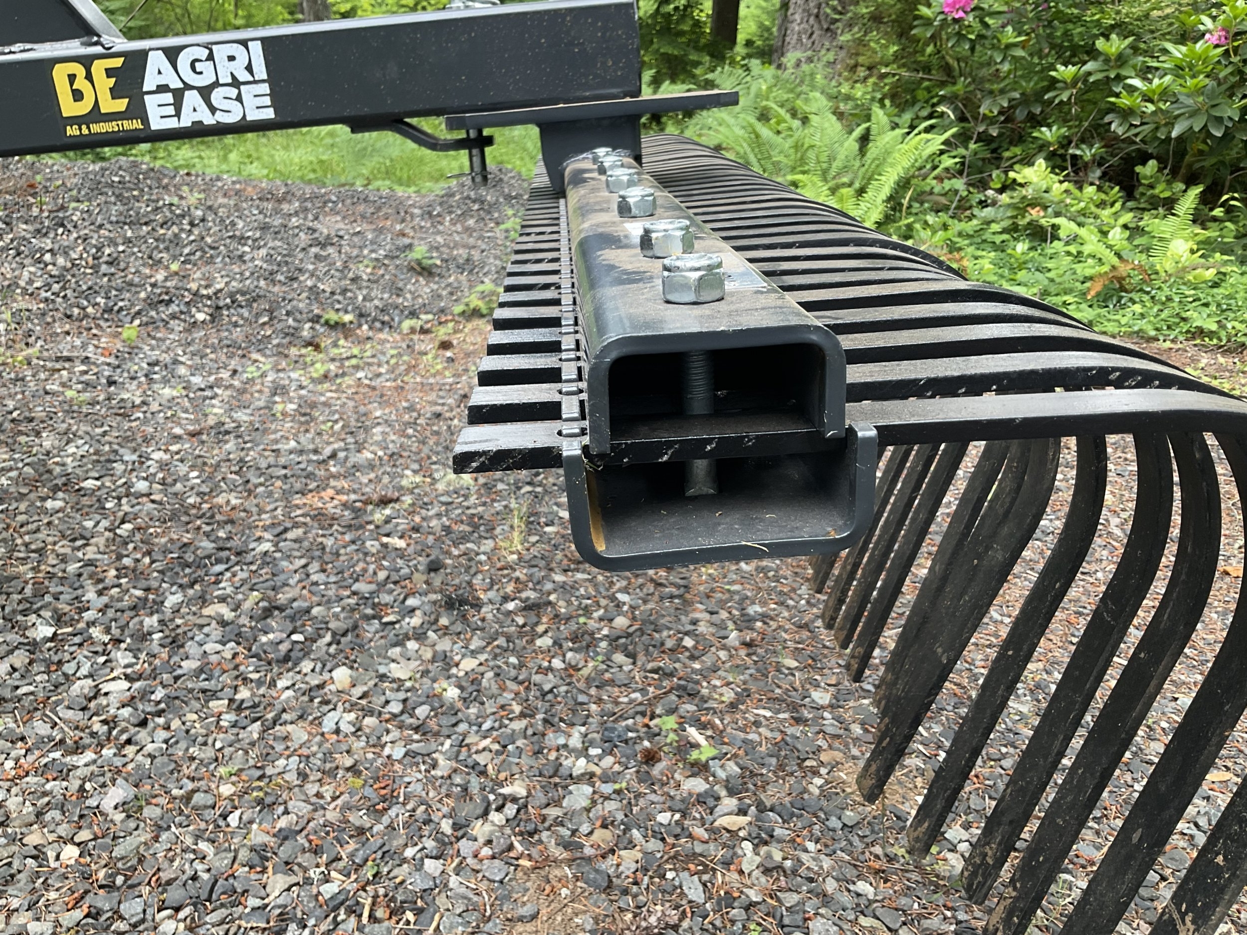

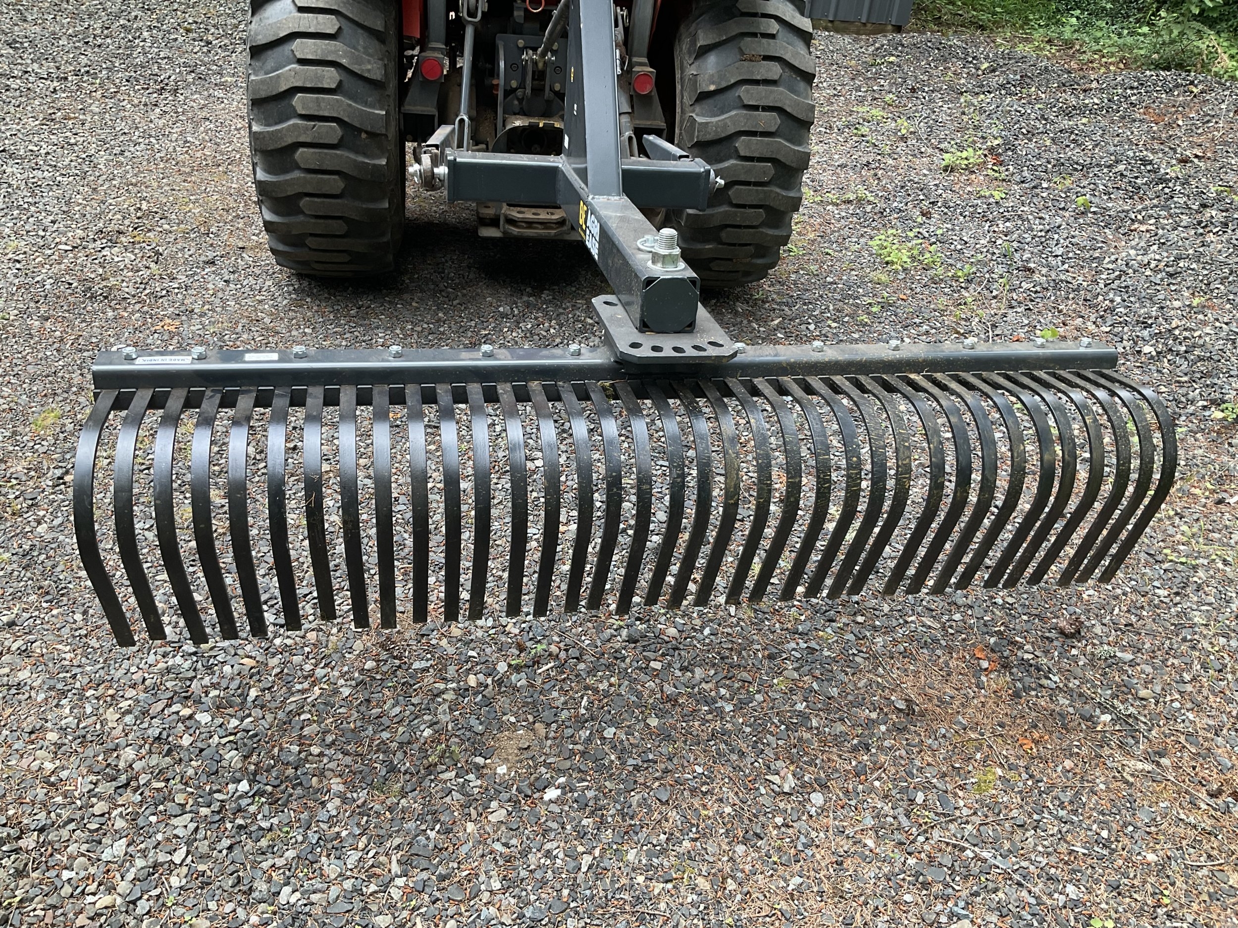

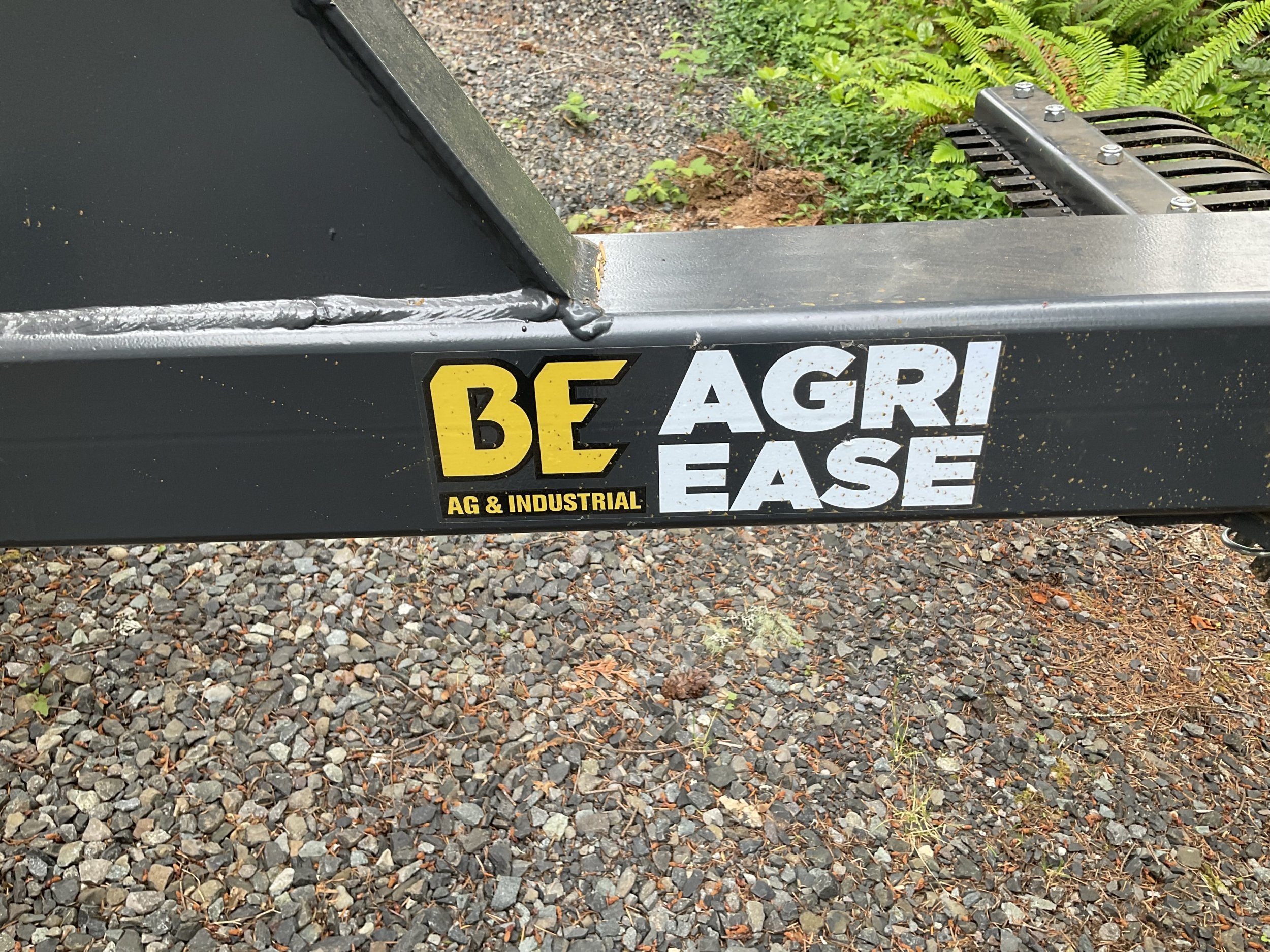

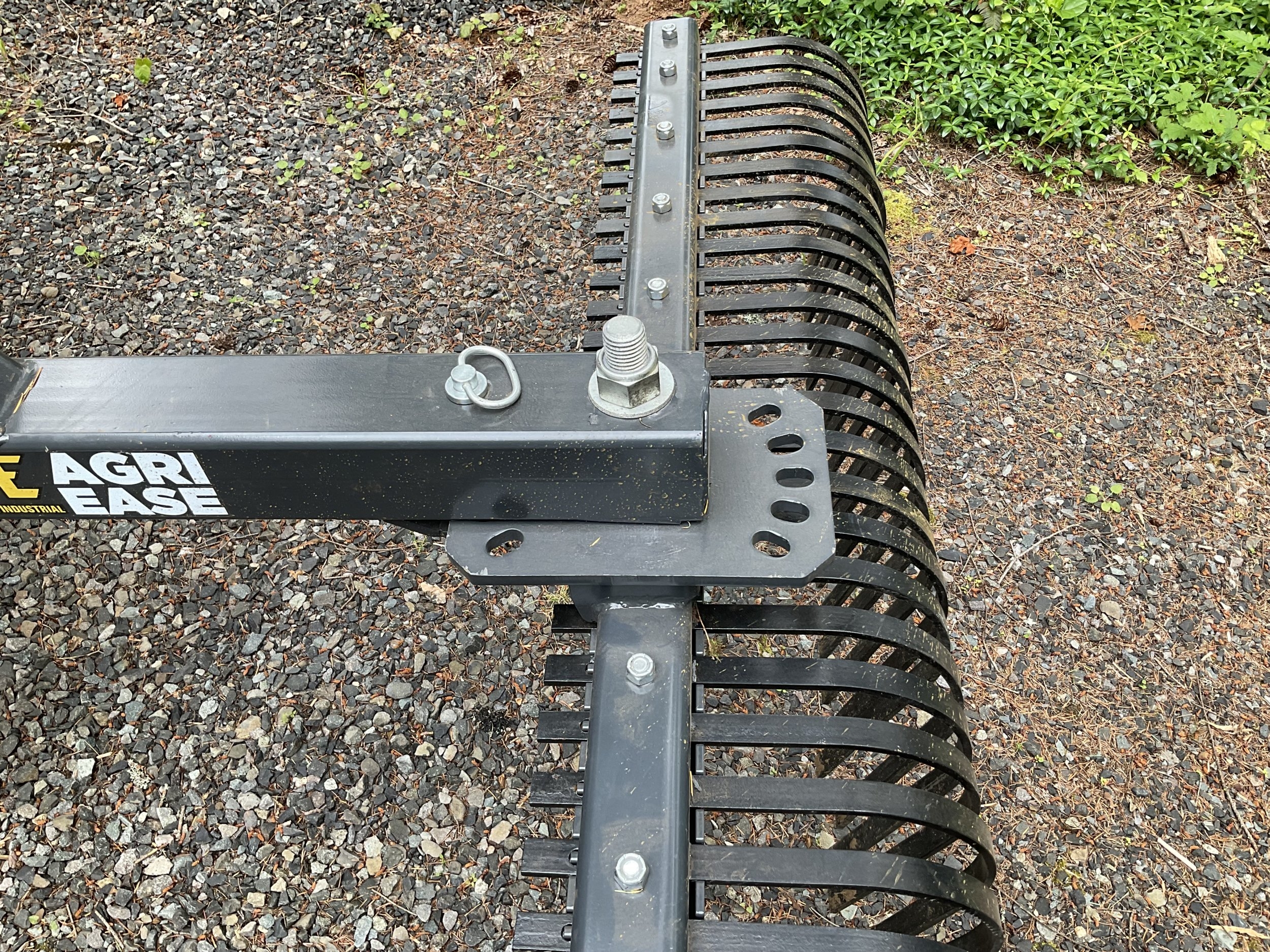

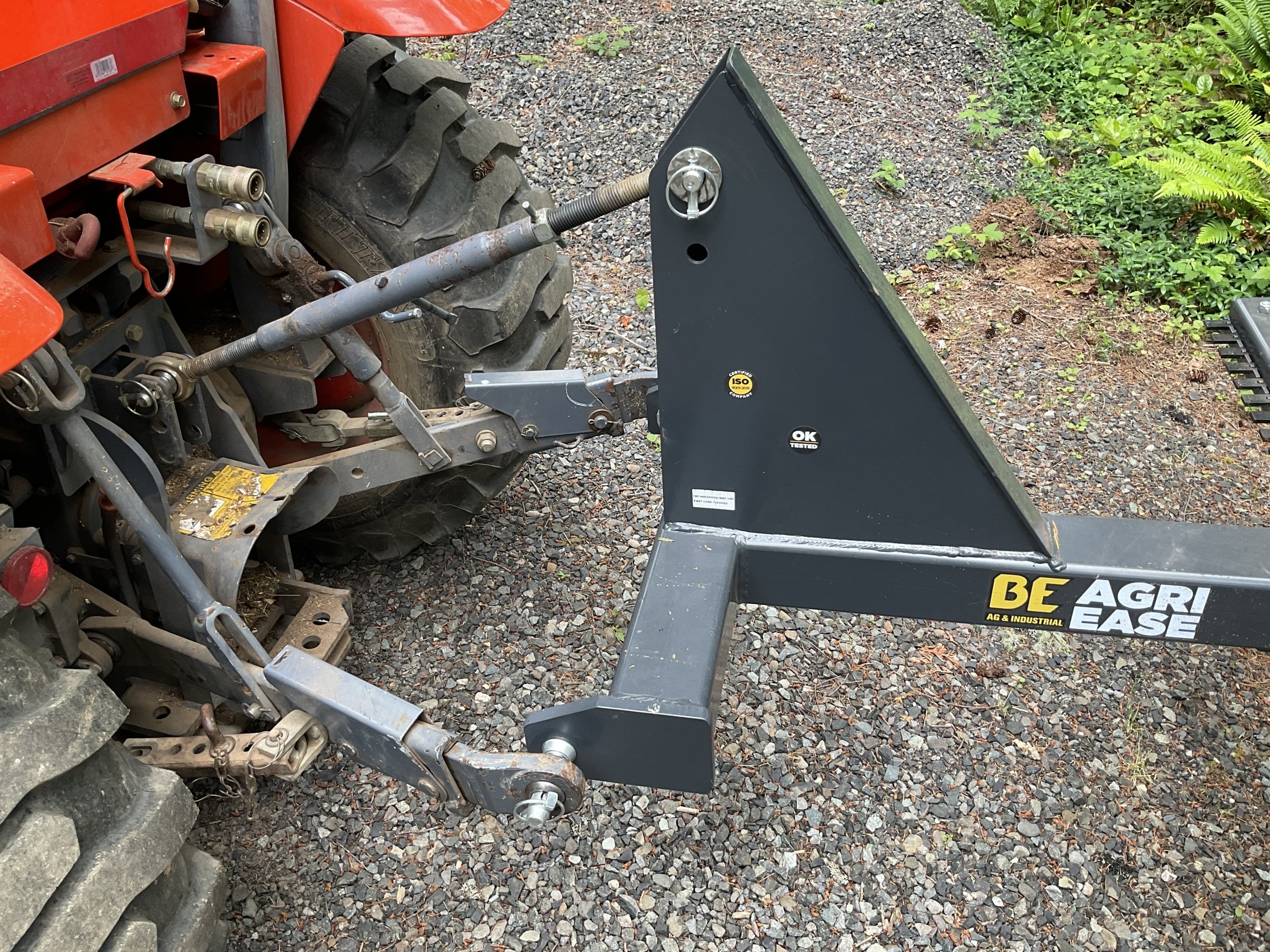

I changed my mind after seeing the tines were attached to an angle iron frame! I went with another brand very happy with the 6’ it was a little more expensive $950 fully assembled. I will post some pictures tomorrow morning!
It has 2 channels holding the tines
Very well made in India!

Hope the pictures help!☮️✌🏻 IMG_5896.jpegIMG_5895.jpegIMG_5895.jpegIMG_5893.jpegIMG_5892.jpeg

The issue with these rakes that the pivot is directly on the tooth attachment is that it can put a twist in that horizontal tooth bar.

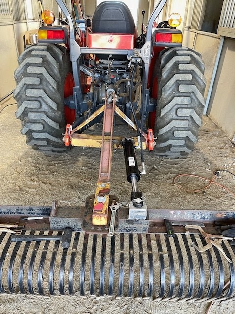

Now add on a hydraulic cylinder and you got something really handy
