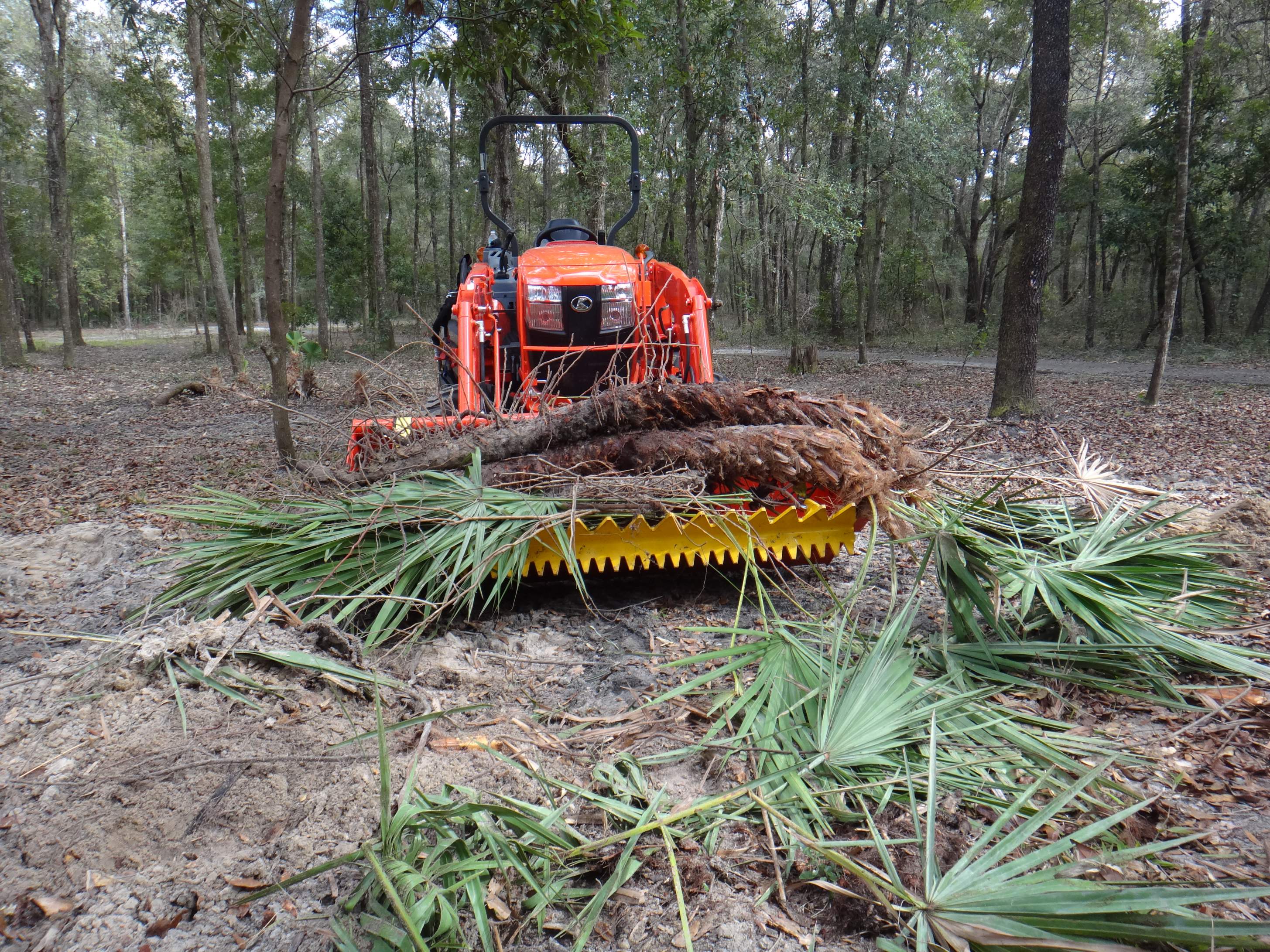

I have an ETA Landscape Rake and a Ratchet Rake, by Ratchet Rake, LLC.
While the ETA Landscape Rake is EXCELLENT QUALITY it will not serve as a subsurface Root Rake even with every-other-tine removed.
Gauge wheels on a Landscape Rake are useful for final grading as they give a level finish. Downside is they stick out a long way when the Landscape Rake is angled, which limits maneuverability, and they are a pain to bolt on and remove. You have to be careful not to bend protruding gauge wheel brackets against obstructions when making turns. (My first lesson was $50) ETA's gauge wheels and supports, which are from India, are not up to the quality of the rake itself. Gauge wheels do not castor well and the axles bind up with trash.
The Ratchet Rake has two rows of teeth, one row "down" oriented across the bottom of the implement, which will pull roots down to 2" deep in moist soil. Ratchet Rake is The Berries for tearing out brush in general. It will do light grading. I often have the Ratchet Rake on the FEL bucket and my Rollover Box Blade on the Three Point Hitch at the same time and they complement one another when grading.
Picture #4 is all grape vine roots.
Note: Some pictures show Kubota B3300SU, predecessor to Kubota L3560.
