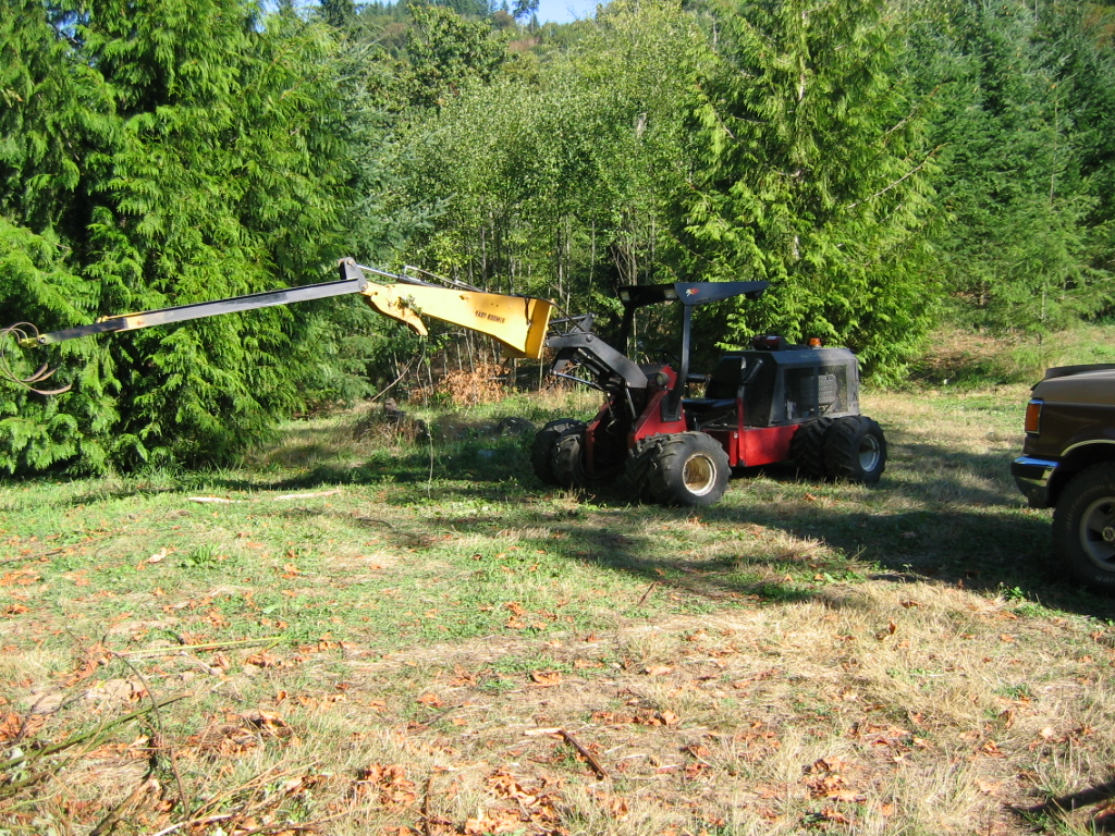

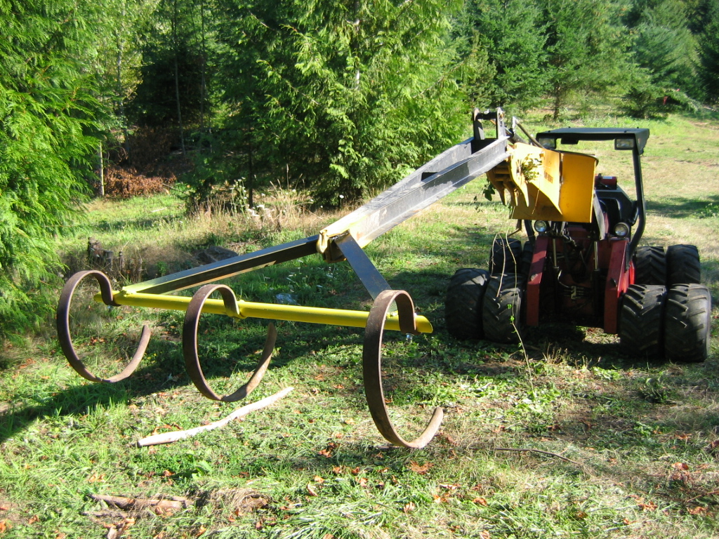

Angling.. As it runs off my FEL I can tilt to my hearts content. But I do need to add guage wheels. And thanks for the pic. It is a more advanced version of what I am doing.
But for further explanation. The reason the device shortens to 4 feet is to allow me to attach it to a special kind of boom pole our tractors have. This way I can reach about 12 to 14 feet down a ravine and pull up twigs and blackberries.
Now comes the hard part. How do I build the pivot. Is it just a simple hardened bolt, or should I do some sort of sleaved thingy. I look at everyones build and boy is mine remedial.
Here is a photo of my first build. It failed miserably, but it gives you and idea of what the short version of the rake is going to be used for.
So, I have to build the rake so it comes off the FEL mount reasonably easy and then attaches to the boom pole.

I can only suggest ideas that might be useful.
As for the rake being able to pivot on a horizontal plane, I see it would only be useful in your application for reversing the blade for direction of use. Setting the rake to angle is useful for wind-rowing (moving material like gravel to one side).
What does seem to be almost required is a limited free vertical pivot at the end of the boom because of constant geometry changes during its use. If the rake is mounted rigid, it will want to dig during movement when you only want it to drag.
Also I notice your boom is pinned for maximum lift. Adding some plate allowing the boom to be optionally pinned for more downward curling seems necessary.
As an example, what I visualize is a landscape rake mounted to a Backhoe, curling the debris up.
