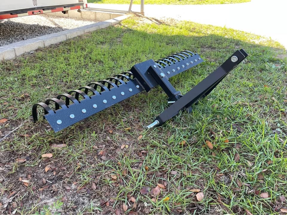

This one is listed as $325, Iron Craft is $750 for 5'
Ebay has some for $300, thoughts on quality for home owner use.

Thanks for all the input !
A 60" Rake was purchased from Tractor Supply and has more than done the job I've asked of it.

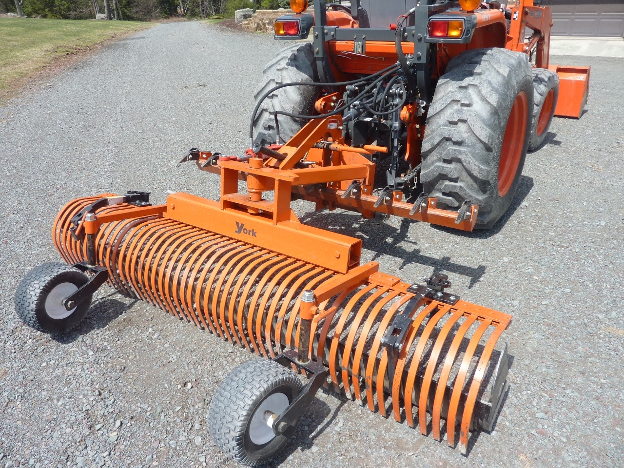

+1 on York rakes. I've had mine with scarifier, gauge wheels, hyd. angle and grader blade for over 20 years. Not one broken part or repair in all that time while maintaining 1.25 miles of private road.
Prior to the York, I had several cheap rakes which didn't last long doing this heavy work.
If the work you do isn't rough, you could get away with a cheap one though. Keep in mind, you get what you pay for with this type of equipment.
