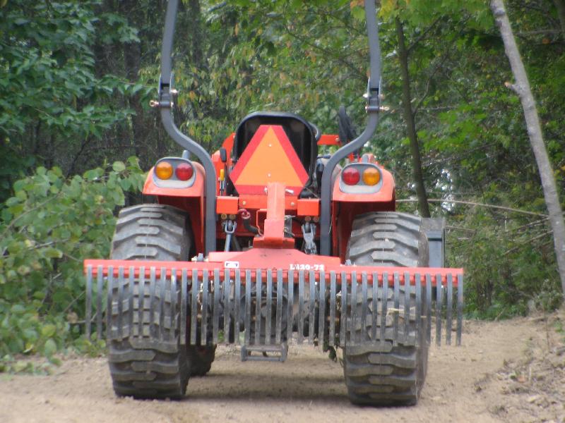

Ok...I've admit that I've used and abused my lanscape rake. I've used it to rake out the dirt to plant my new yard, freshen up my gravel driveway, cut down small mounds of top soil, and clear underbrush from about 5 acres of woods (the last two were the roughest on the rake). I have snagged it on more trees than I can count and have backed the tines into even more trees than that.
Now the tines are all bent at different angles. They don't sit flat so it is hard to do finishing work with it (however it still works perfectly for most jobs). Is there any way to bend/even out the tines again so they are all the same? Can you purchase a replacement set?
Any wisdom would be appreciated.
P.S. A picture is attached but it is very hard to see from it what I am talking about.

Heat em up with a torch and straighten with channel locks.
Or buy new tines.
   / Landscape Rake maintenance #3
If you heat the tines to straighten them, you will take the temper out of the steel. Tines are made of spring steel and it doesn't take well to heat. I suggest that you either learn to live with it, or to order new tines from the manufacturer. It is a tool, and with use, it will get some damage. Think of the cost of a few new tines as normal maintenance. If you remove them, you might be able to twist them around with a pipe wrench holding the tine in the vise. Just be careful that it doesnt break and you wind up falling on your arse.

I get a pipe wrench and bend mine "cold" to get back in line. I suppose that after numerous bending the tines would weaken but I haven't had to do it too often so the rake should out last me since I get "bent out of shape" once in a while also. /forums/images/graemlins/grin.gif /forums/images/graemlins/tongue.gif
   / Landscape Rake maintenance #6
Never heat the tines,they not you,will lose there temper. I raise the rake up 2- 2 1/2' then slip a piece of pipe over the tine and get-err-done. If tine tines are easily removable,remove clamp in vise,and still use the pipe deal. I've bent and straightened the tines this way many times. Good luck!
