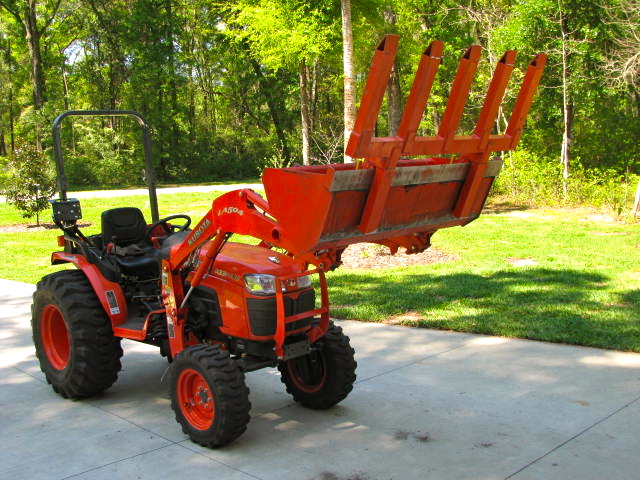

Using the Ratchet Rake to collect woods debris, I also collect quite a bit of dirt as the RR lower teeth are only 2" long. I let the piled debris and dirt dry for a week, then shake out the half the dirt by bouncing the elevated load on the Debris Forks a few times, gently. Half the dirt falls through the six tines of the Debris Forks, which are spaced 9-1/2" apart. After bouncing the load it is, perhaps, 80% organic, 20% dirt. The balance is carried to a burn pile.
Will a Landscape Rake pull less dirt combined with the woods debris, either with all the tines or every-other-tine removed?
How important is the spring action of the tines?
When collecting debris do you usually operate forward, or with the Landscape Rake "backwards", in reverse?
Videos on Youtube often depict debris collection with rake "backwards" and tractor operating in reverse.
{ Ratchet Rake is a really useful, versatile tool. No maintenance, easy on/off, heavy, strong. Works best at tearing out vegetation above ground and up to 3" below ground. It does a lot of other things but not quite as well. }
Photo #1 is wild grape vines pulled out of trees and roots from underground with RR. This is one of three piles for the day.
Photo #2 is one load of the vines on the Debris Forks several days later. Had to drive tractor in reverse to burn pile due to danglers. Needed the disc as rear ballast.

I'm thinking that the video of the guy pulling grape vines is using forks on front. For very heavy underbrush, I'll also use my forks tilted down almost to the ground and roll the bucket to break them loose, and drag them out. I doubt that the guy needed the disc harrow on back for ballast. The vines shouldn't be all that heavy. My guess is that he was using the harrow for something else and just left it on there. I often do that with my box blade...

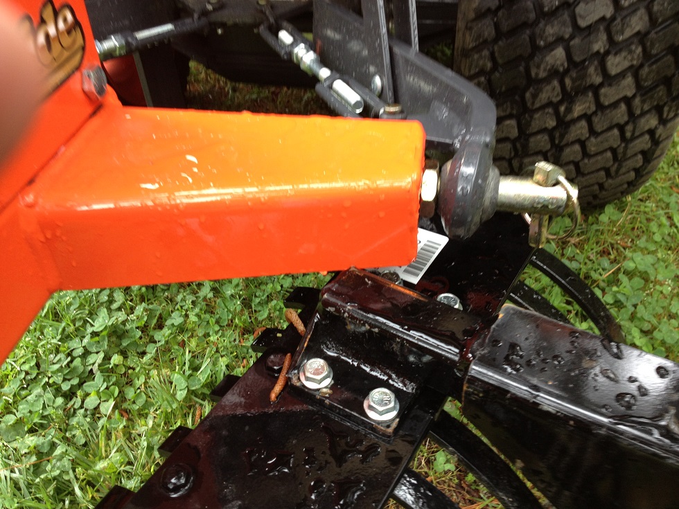

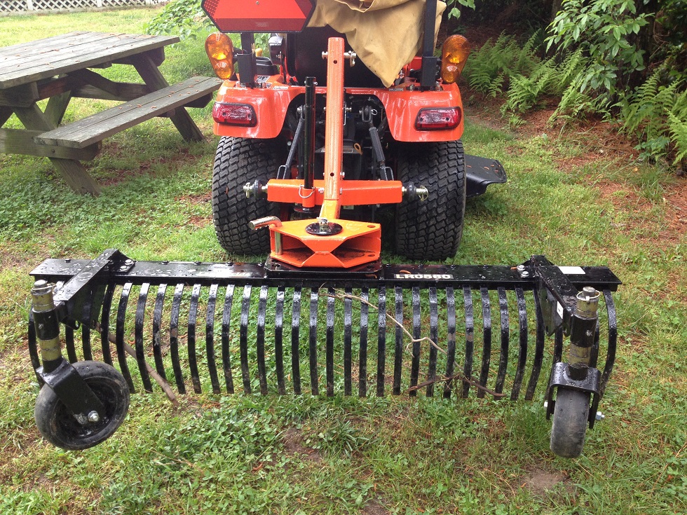

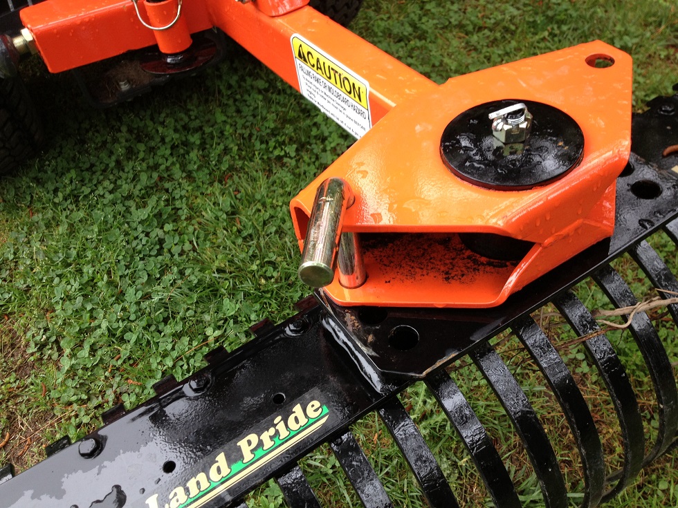

How does one determine if Landscape Blade can be rotated 180 degrees while mounted on the three point hitch?
I have a Land Pride rake LR0560 with gauge wheels on a BX 1860. I tried rotating 180 degrees, but the gauge wheel mount hits.
Ratchet Rake was used to pull vines and collect them. RR is visible on the bucket.
The vines and dirt were right at the lift capacity of my bucket, which is minimum of 750 pounds, less 55 pounds for the aluminum Debris Forks, so close to 700 pounds of vines and dirt.
Ballast behind the tractor substantially reduces strain of the front axle, in this case with a full load initially moving over rough ground, front axle stress was considerable.
