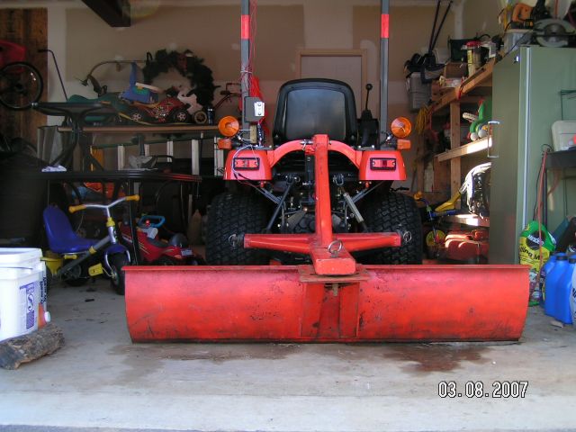

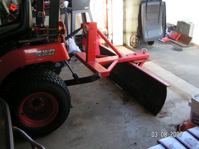

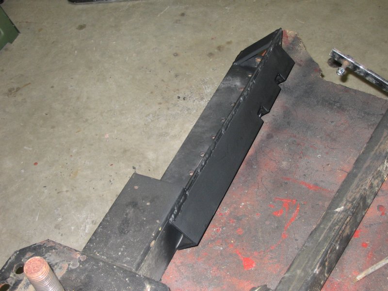

Attached are pictures of the rear blade I bought used about 6 months ago (now that I have seen others this one looks homemade). It works well for plowing snow, however has sat idle since I bought a box blade.
Since I have spent more money on a tractor than my wife would like to ever admit, I have limited funds for other implements. This is why I am coming to you all for your suggestions.

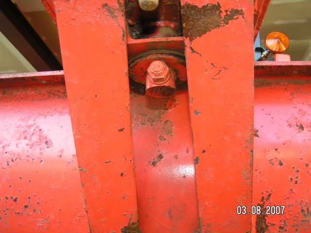

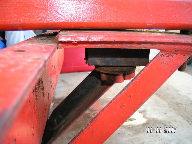

Attached are four pictures of my rear blade. As you can see, the blade has a 1" spindle that is welded to the extending arm. The spindle has been drilled and uses a 1/2" bolt to hold the blade on. Taking out that bolt should let the blade drop right off.
I have done a lot of research and am planning on using 3" by 3" by 1/4" angle to attach 30 tines (making the rake 5') to. In order to attach it to the spindle, I was thinking of welding 2" by 2" square to the front of the angle. I would then drill a hole down through the tube for the spindle. Finally I was think of welding a plate on the top of the whol gismo with holes drilled in it so I can angle the rake.
By the way, the spindle seems a little short. It only extends between 2 and 3 inches down from the extension. I was think about cutting it off and drilling for a new one. Not quite sure it is worth it.:confused:
OK, I will stop ramble and wait for you comments. Please don't worry about offending me. If you have better ideas, I am all ears. :D

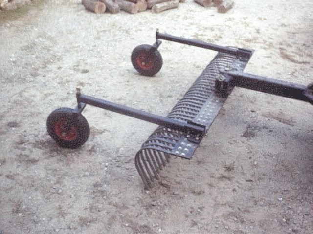

Forget the 1-hole tines. Unless you put in some type of spacer between the tines they will rotate. Get the 2-hole and mount them 2" on center. That is what I used on my home made rake. I would suggest using 4" x 4" x 1/4" angle as that is a little more heavy duty with less flex and gives more room for mounting holes. Woods uses this for their rakes. I used a 5" x 1/2" flat bar for mine.
Now that you mention it, you are right. 4" would be better. Do you think I should ditch the existing spindle and replace it with a high grade 1"+ bolt? It would be easer to replace if something bent. I am also going to rework the way the blade hooks up next fall. The current design stinks.
   / Landscape Rake - First time building anything #5

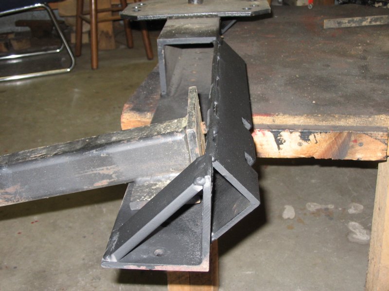

If I recall correctly, I used 7/8" or 1" grade 8 bolts. Expensive but they work fine.
If you are going to use angle instead of flat bar be advised that the angle will bend. About 2 years ago another poster brought a Woods rake into my shop for straightening. It seems he backed into something and bent the heck out of the angle. I ended up re-straightening the angle and adding braces to prevent further damage. I posted a thread about this over a year ago.

As you can see from my earlier pictures, I welded a length of 3" angle on the back of the 4" angle and then added a piece of 3" flat bar to the inside of the rake. This was done to both ends of the rake. This was for a B2910 and it doesn't matter what size tractor you have, the rake can still bend if hit just right with the right amount of force.
