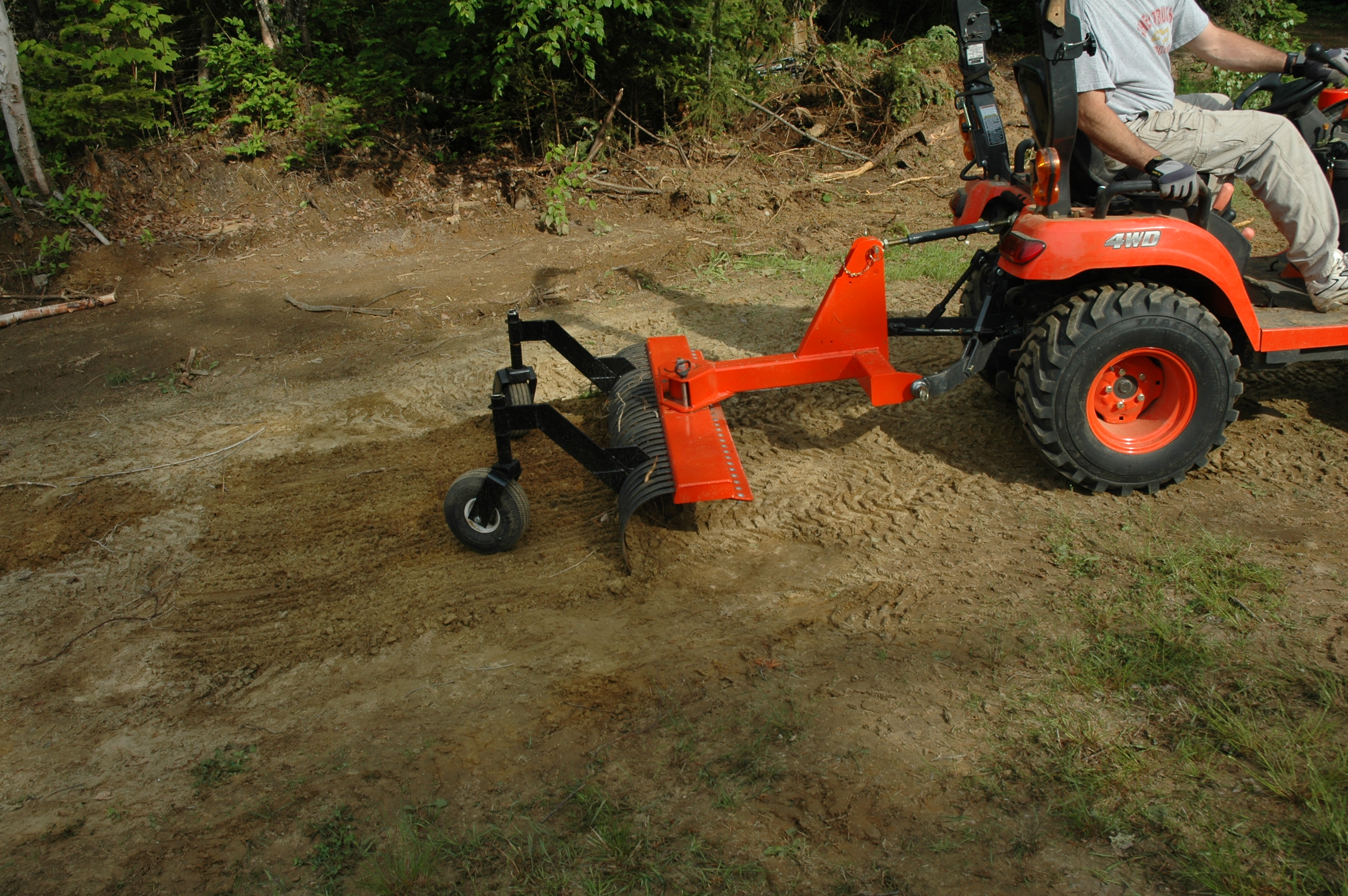

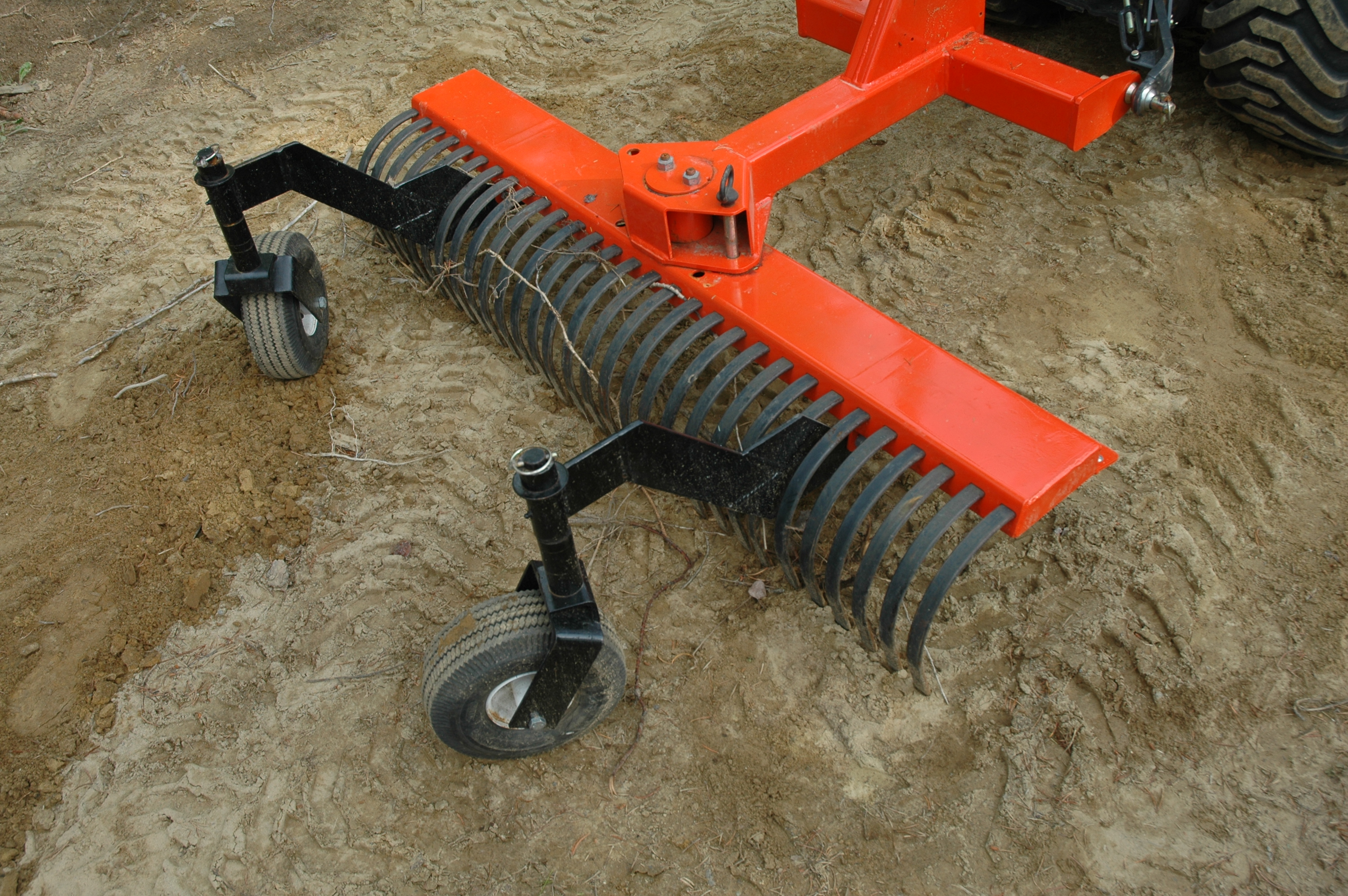

I have an EA 7 foot rake. I angle it when it needs to be angled and use it straight when that is what I'm after. I haven't had any issues with breaking or bending tines due to this. Often I am also using the gauge wheels like this when I'm trying to just skim the yard on each side of the drive to pull some of the winter rock back onto the driveway before running the land plane. In dirt work, I angle and forget it if doing any windowing etc. to remove rock. The only reason I've limited my angle so far is the spring action on the rocks. I'm not trying to pull them from one side of the drive and have them shoot off into the grass on the other ;)
