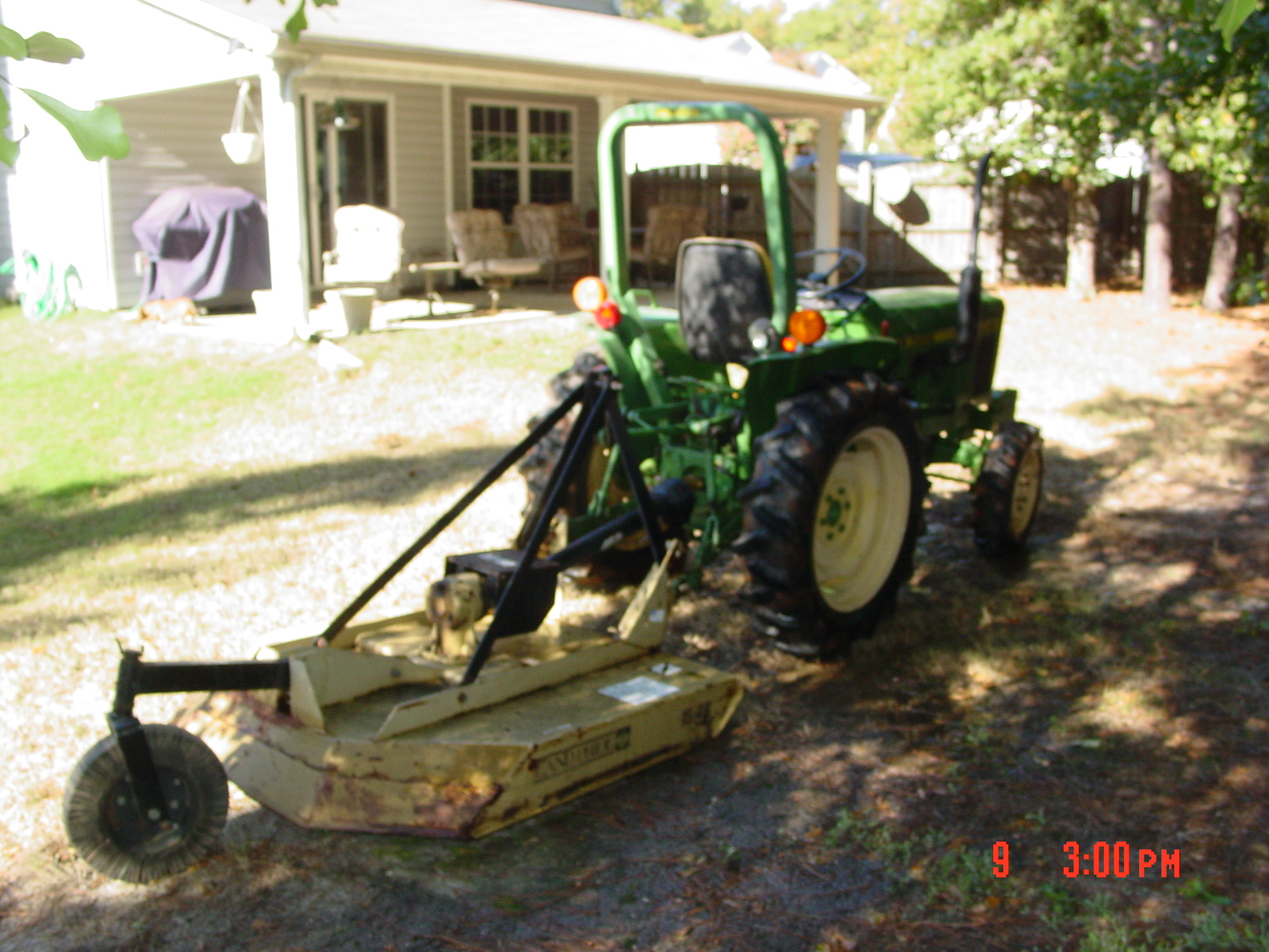

Just wanted to say that I think that's a really good mower, I had one when I used to have my JD750. I bought it used and got great service out of it for the few years that I owned. I think the previous poster gave you great information on the shear bolt. Good luck with it!

Thanks for the info from your experience. I bought it mainly to mow/clear in the woods; so I wanted something pretty small that I could get through the trees.
