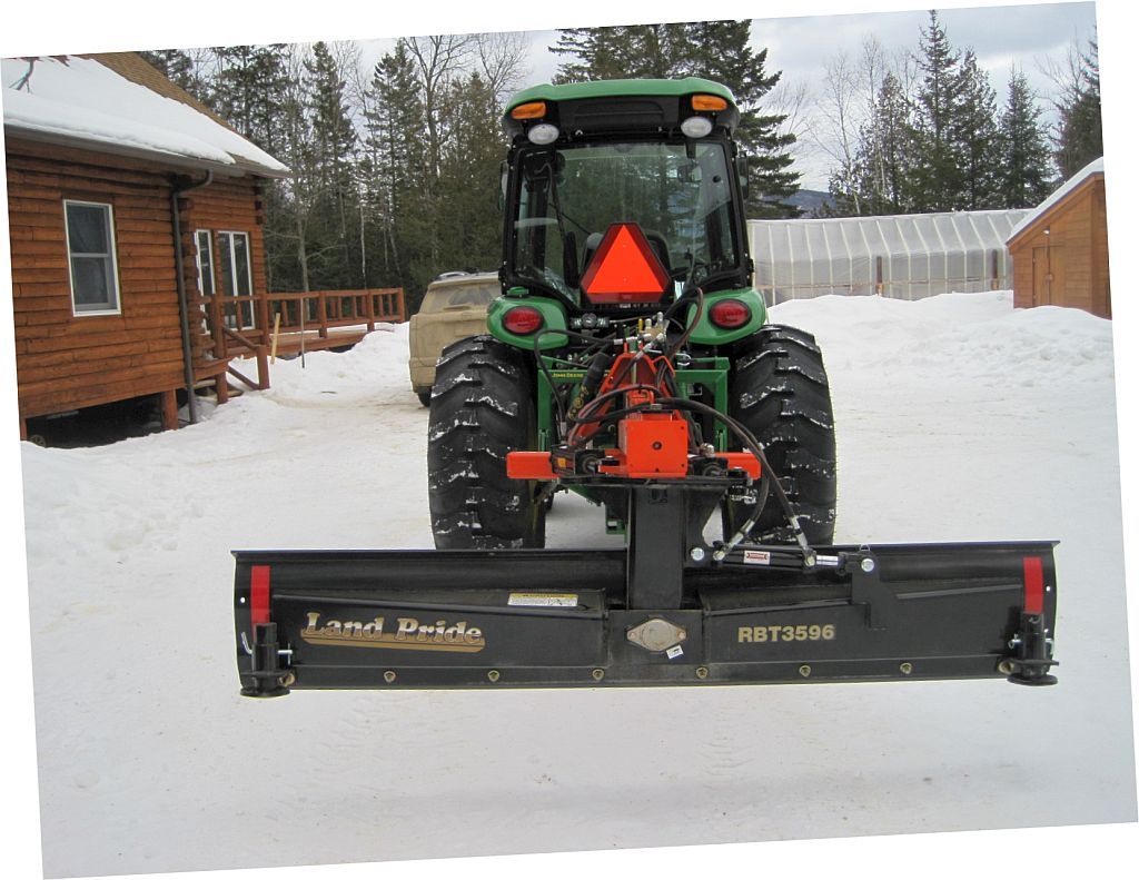

Hi,
Not sure if my post fits here, but I have a new Land Pride RBT 3596 hooked up to my John Deere 4052R. It has angle, tilt, and offset functions, but I ordered mine with a manual diverter that sits on top of the Land Pride frame. The hoses from the Land Pride occupy my 4th and 5th SCV couplings . . . my rear 3rd SCV is still open for some other connection, which was my plan. All I have to do is flip the lever on the manual diverter and I can go from tilt to offset pretty quickly, as the need arises.
Land Pride RBT 3596
Land Pride Manual Diverter on main frame of RBT 3596
FredSG
   / Land Pride RBT3596 Hydraulic upgrade
#17
Absolutely belongs here!!! Thanks for posting!!!!
Only question I have that concerns me is your orange blade on your green tractor!!!! :D
So you are running three circuits on two hookups.
I still may think toward something like this. I'd like to control my side shift hydraulically. I think I'd go for an additional electronic diverter. I'm lazy. Don't want to get off the seat. And don't want to add another circuit to my Ford. :)
Thanks again for posting with excellent pictures!!!

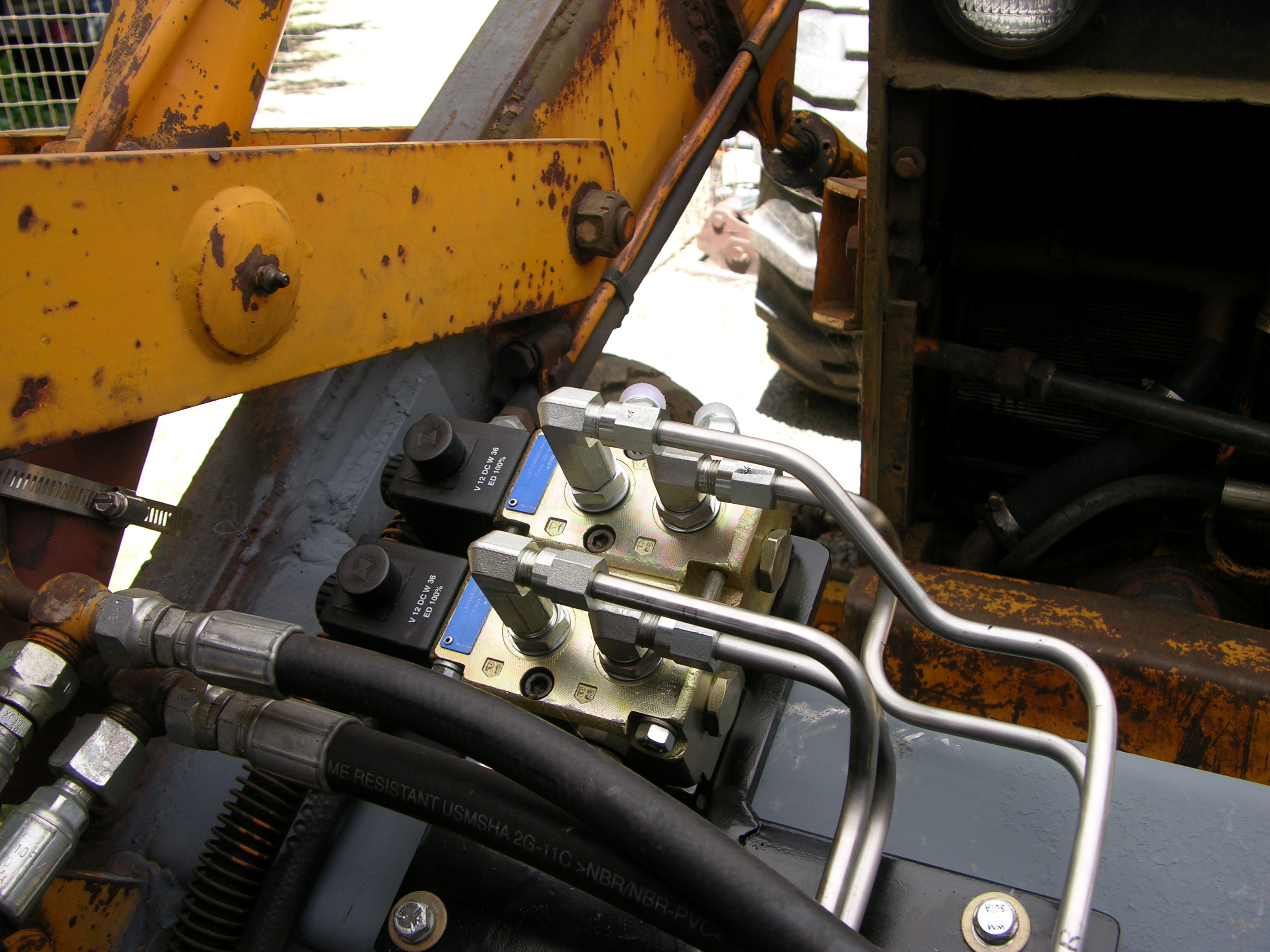

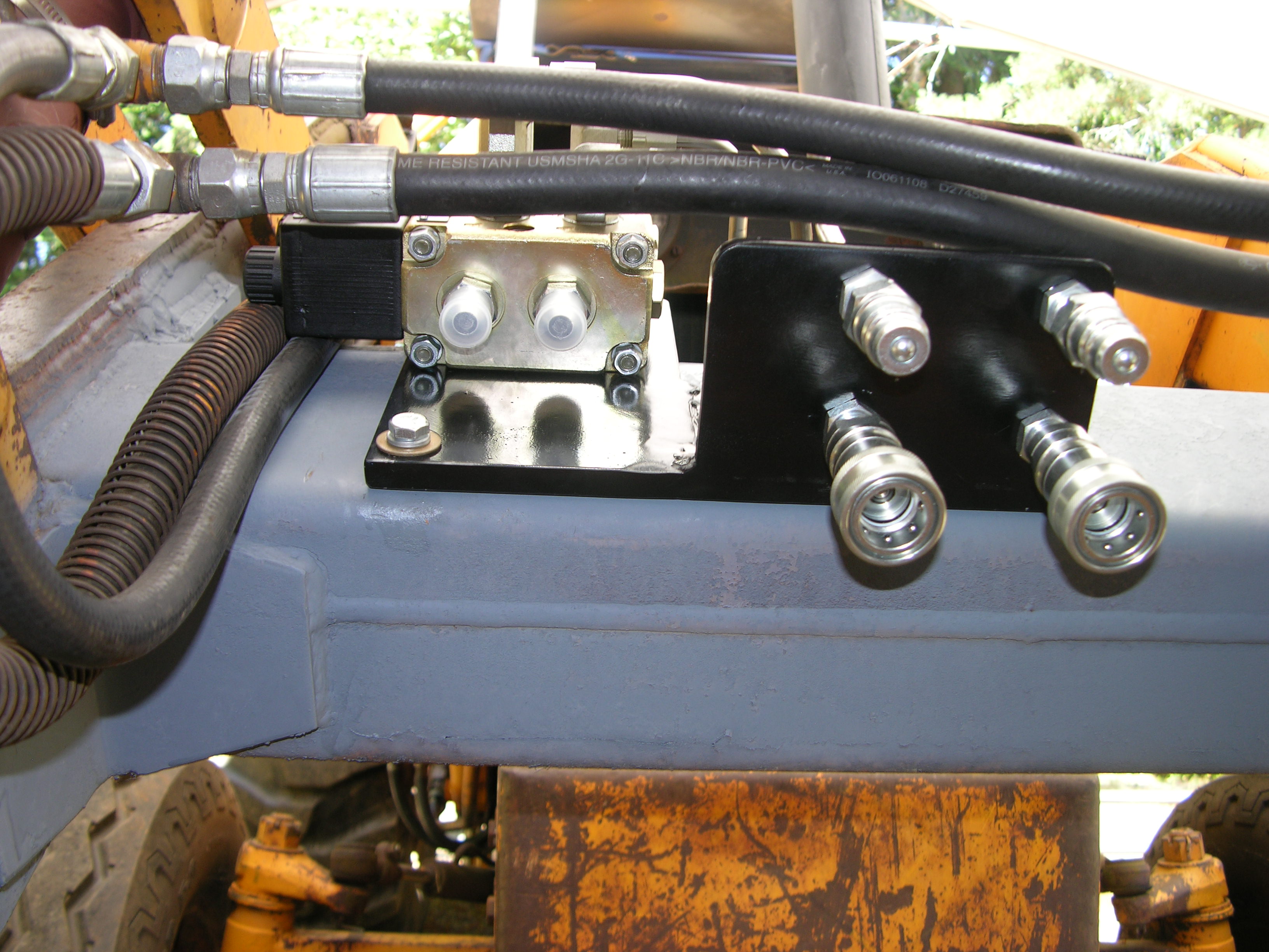

Going from that manual to 1 or more electric valves would be as simple as deciding on switches and running wires - here's what i'm doing so I can run grapple or (both valves) an articulated linkage for my hydraulic sickle bar trimmer (Neither project is done yet :ashamed: )
All the extra bends are my attempt at keeping connections as out of the way of other hoses as possible. Whole project involves my own version of a QA for loader implements, including grapple, brush bucket, brush forks, regular forks, 3ph converter, and probably a couple I've forgotten. Switchover for non-hydraulic implements will take maybe a minute, hydraulic ones maybe five. I also have a full flow motor control valve plumbed in to run the sickle bar.
Neat thing about that type of electric valve is that your only limitation (besides $$$) is space, and figuring out switching (they're stackable). For switching, I bought one of these to replace the loader joystick handle - that'll let me use the curl circuit for up to 3 OTHER (featherable) functions.
Scorpion Technologies LTD. - S-Series
I got the 2 button plus trigger version in case I wanna add a THIRD valve (at 75, I'm fairly sure I know my tendencies) :D ... Steve
