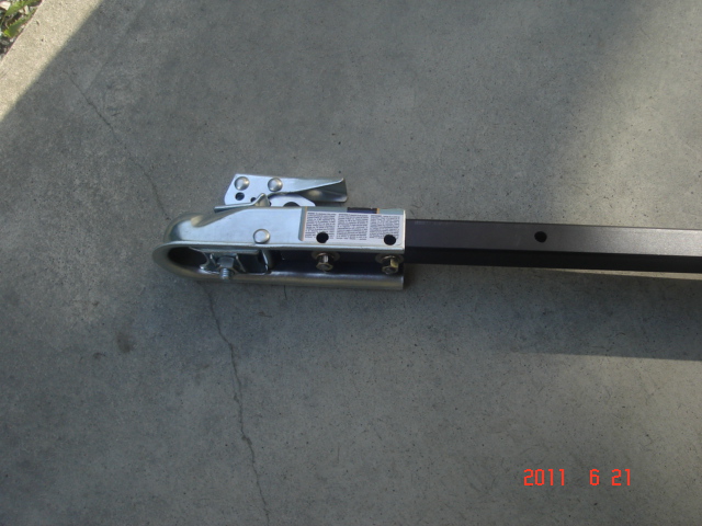

Thanks, jenkinsph-- I did go ahead and remove the pin connector and replaced it with an 1-7/8" ball connector (most of my stuff is that size). That should hold it even better for backing up. I plan to try it out on a neighbor's driveway soon- that should give it a good workout, theirs is a lot worse than mine.
