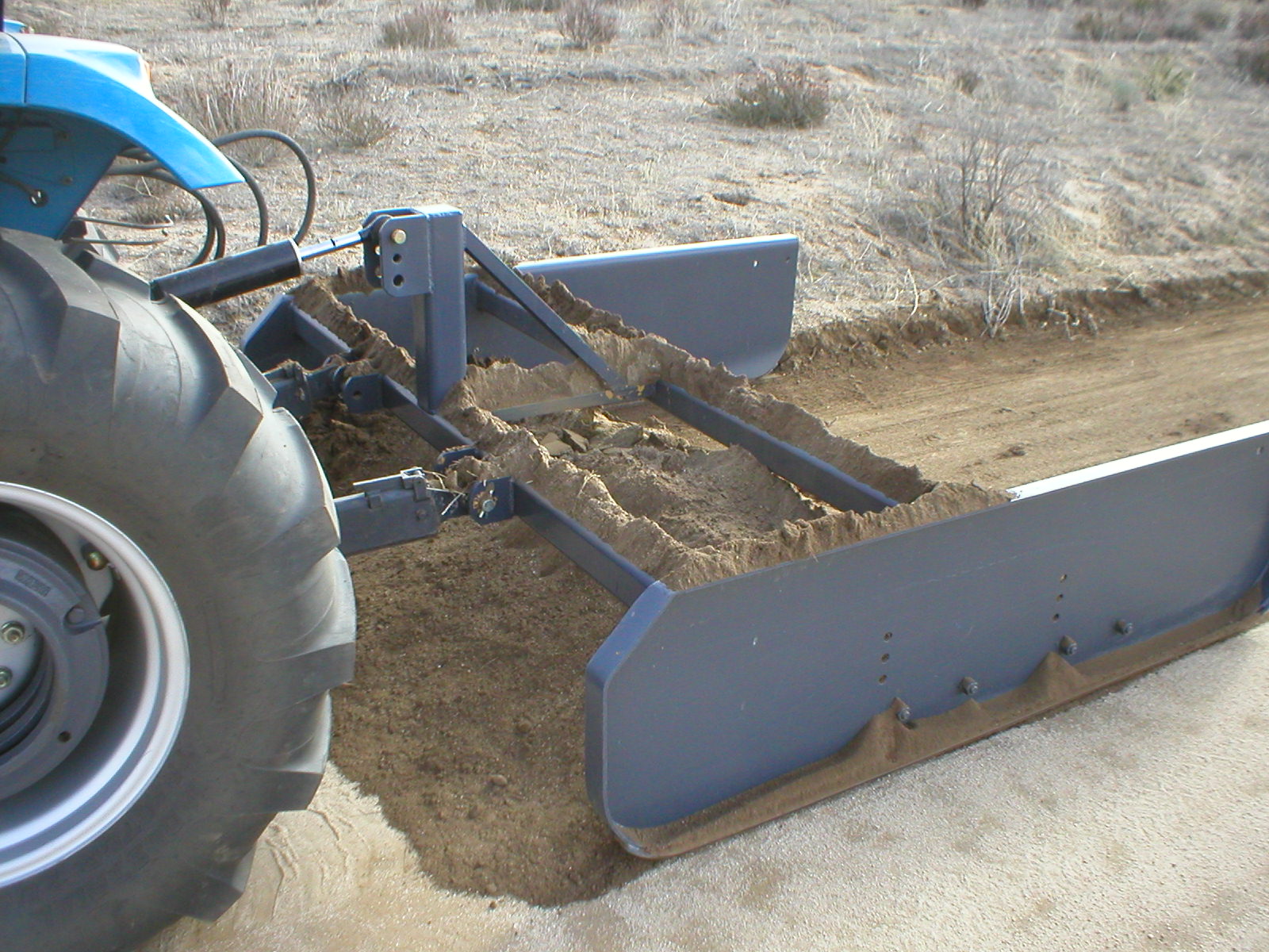

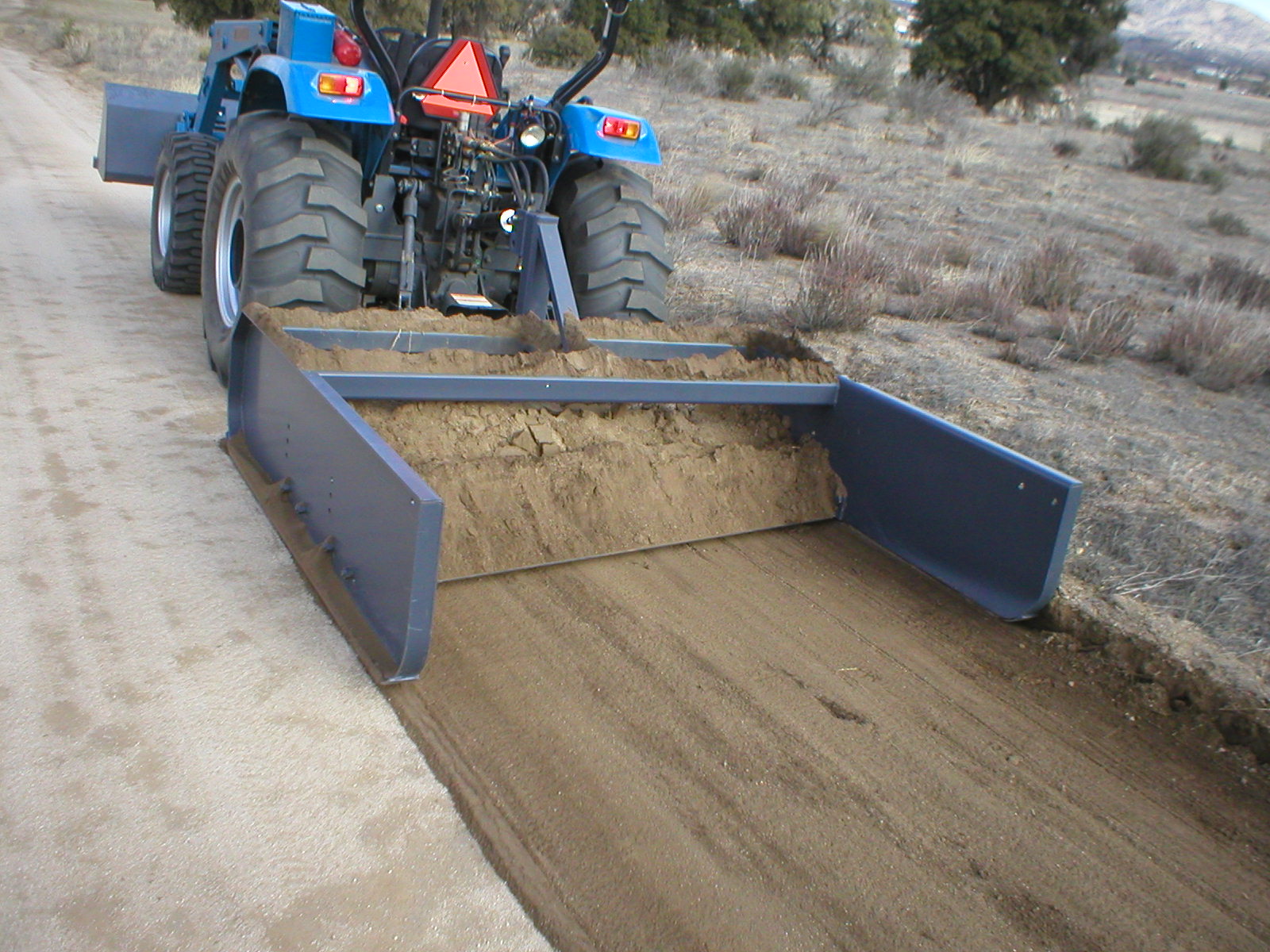

For maintaining a road, very difficult to beat a LPGS in my opinion. Just like most grading implements, weight is your friend. I have found that to be able to work well the implement needs to weigh between 125-200lbs per foot of width. A lot of people are satisfied with less, but to work best you really do need that weight. If I had your machine, I would not go any wider than an 8-9 footer. I have a 7 footer that weighs 1400lbs, and if I don't pay attention and the conditions are right it will stop my 75hp 12,000lb tractor.

I can move about 4 CY of dirt with my LPGS if the dirt is moist. There are 2 blades cutting 1" of earth, it can pile up real fast. Yes it "can" be much harder to pull than a box blade. But all of this can be controlled. Maybe you should just get the 10 footer and be happy that you will be able to grade your roads with a single pass.
We TBNers go through this learning process all the time. All we can do is guess what your conditions are and give advise on what we think the situation might be. Until it is clear to us exactly what you have and are trying to do, a lot of our advice simply does not apply.
I am sorry that it took this long to get on the same page.:sorry: One last thing, you may not like the cost of a good 10' LPGS. My guess would be quite a way north of $4000. :eek:
