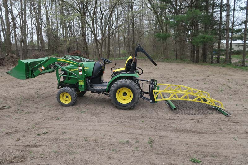

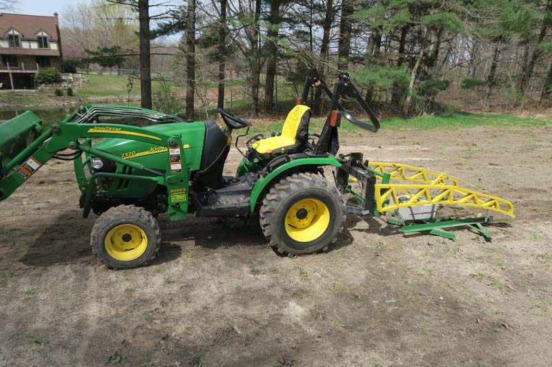

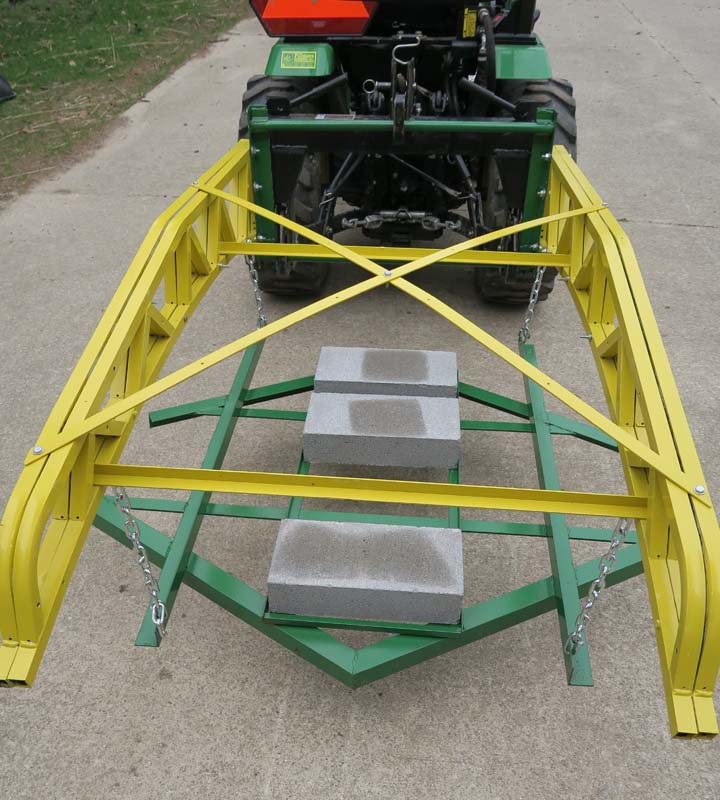

Had some time on my hands this winter and a lot of junk laying around so I decided to try building some cheap landscaping tools. I wanted things I could lift and carry on the 3 point quick hitch. I made the usual number of mistakes so here is my experience.

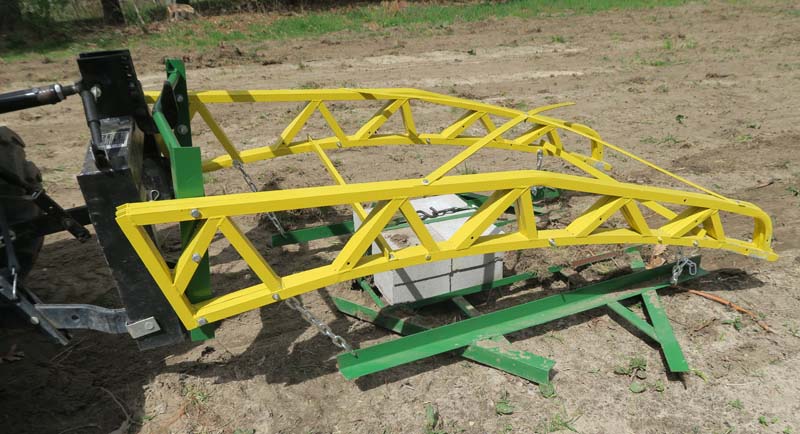

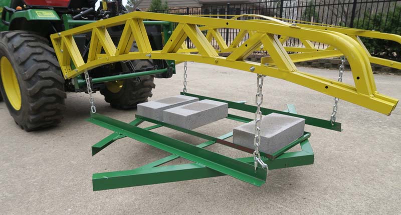

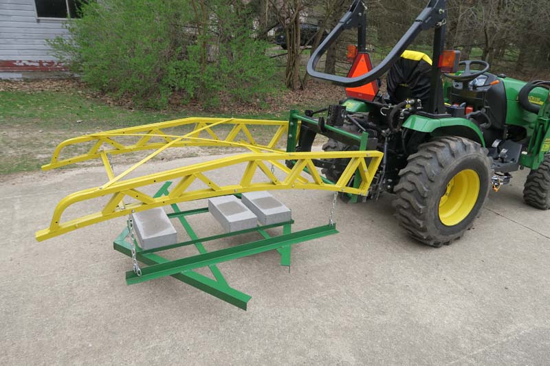

Some time ago I tore out an old satellite dish so I had 8 large aluminum ribs. I used 4 of them to make lift arms. I made a quick hitch attachment from angle iron and black iron pipe. I fabricated a simple land plane from angles and included a frame for concrete block weights. The only out of pocket expenses here were the lift chains, the concrete blocks and some bolts.

Interesting design. I really like the ability to be able to lift it up if you get sticks caught under it. That's the biggest flaw to the one I built.

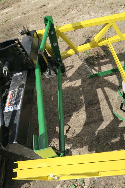

Starting to use this rig, a couple of problems became immediately apparent. The front attachment on the lift arms is too high, pulling the front of the plane up. I initially solved this by moving the weights to the front and strapping them down. This more or less worked, but the pulling force, with the lever action of pulling the lift arms down, was too much for the pipe in the top hook attachment and it bent severely.
I am going to rebuild the 3 point frame (the green part) to stiffen it up and to provide extended lower angles. I will rig the chains as they are now for transport but refasten them to a new lower attachment point on the 3 point frame for actual pulling. This should cut down on the front lift of the plane and reduce the top hook force. The good news in all this is that the top pipe bent and none of the welds broke. I'm not the worlds greatest welder but everything held together. I was also a little worried about the plane itself because the angles were just what I had and I would have rather had larger ones, but they seem to work fine.

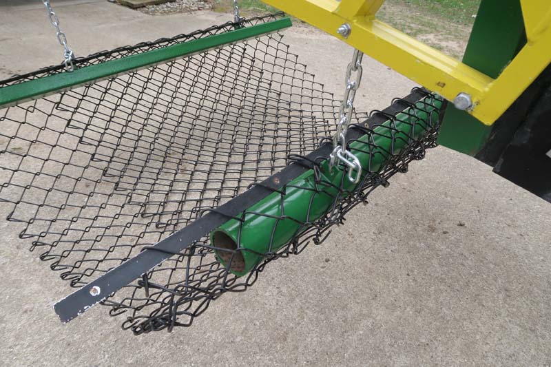

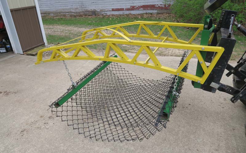

Finally, since I went this far and had some leftover chain link fence, I built a drag mat. I had an old piece of heavy pipe and a piece of rectangular tube steel to use as front and rear weights. This worked OK also but had the some of the same problem of front lift. I will probably change the attachment for this also. I'm not sure if there will be compromise position that will allow the implements to be lifted and to pull low, but I think by moving the front attachment to the 3 point frame I can do this.
