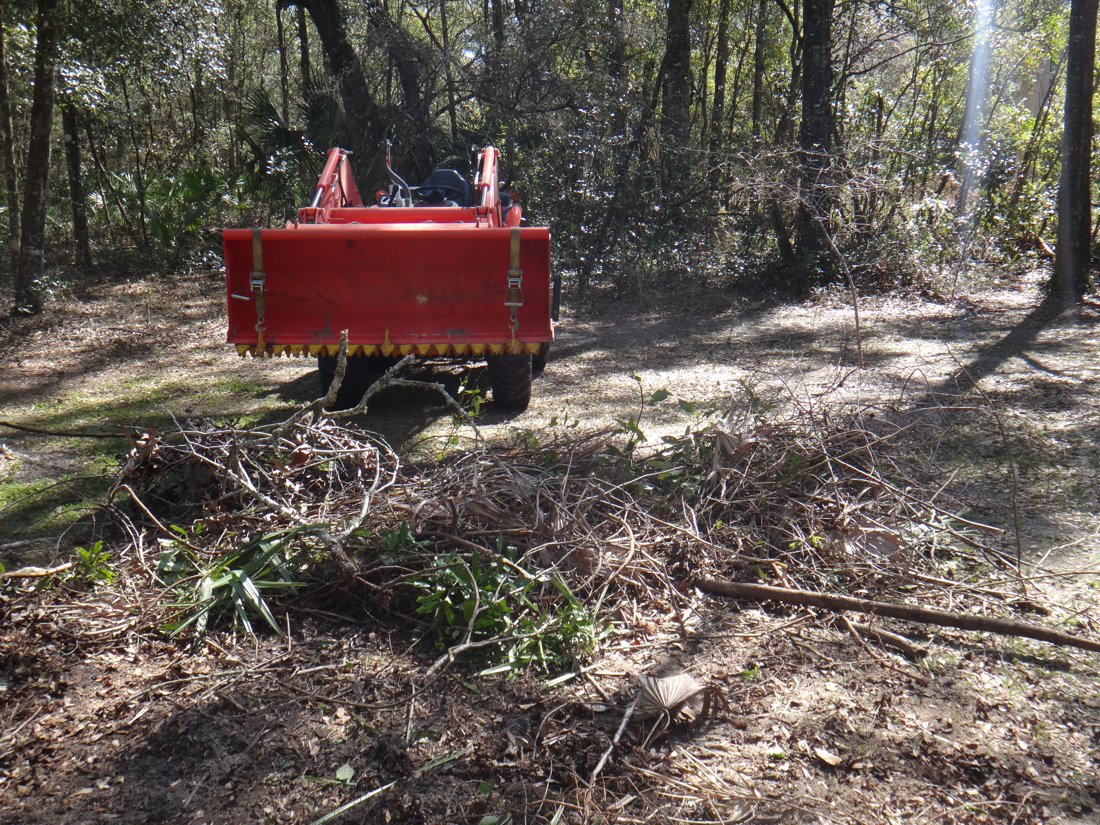

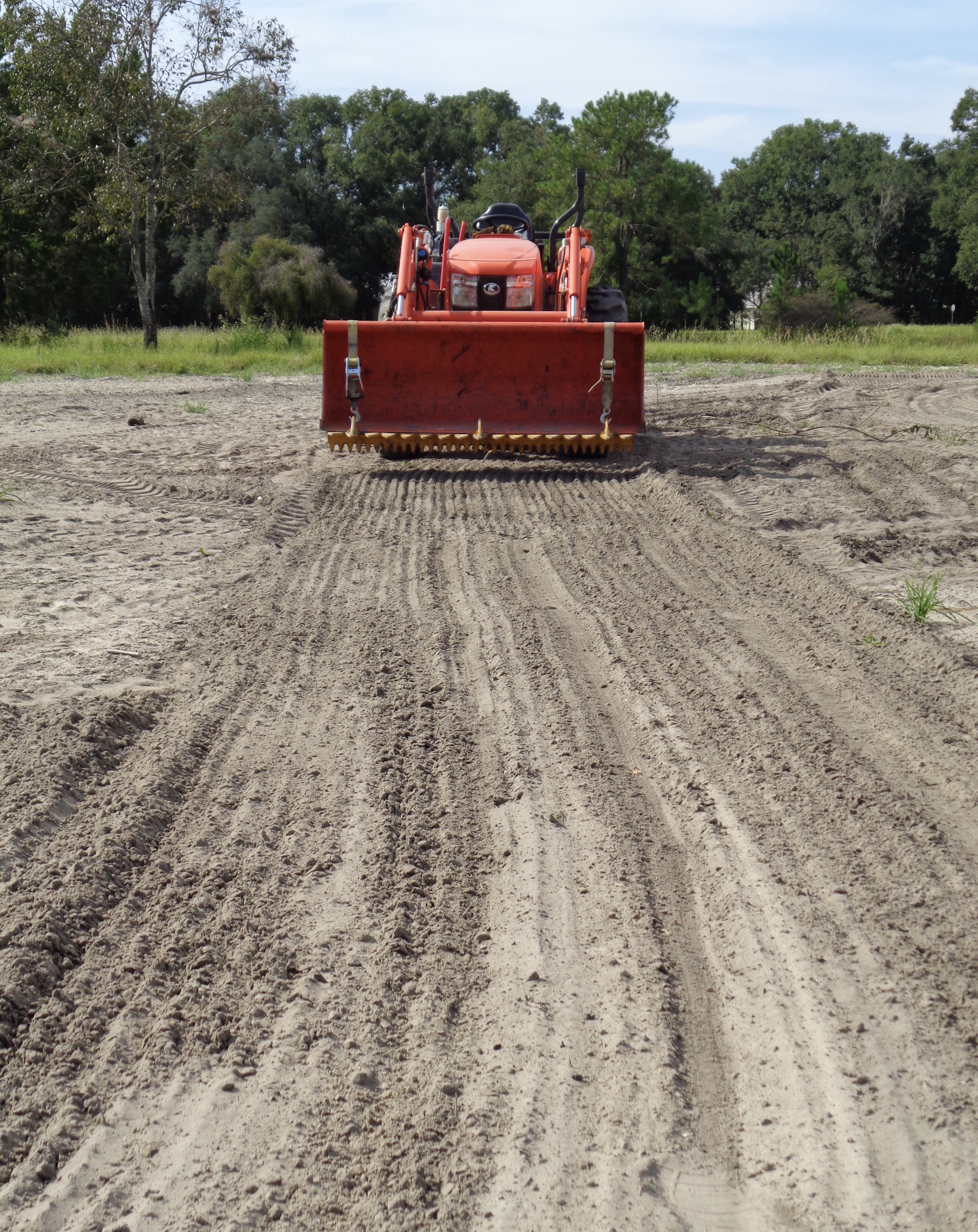

I am the owner of a ETA Landscape Rake and a Ratchet Rake bucket attachment.
I agree with MtnViewRanch: The ETA rakes are the best on the market.
For everything except windrowing I find the Ratchet Rake easier to use and faster. Having the rake forward is much better than having the rake in the rear.
I was 'pushing up' my hot burn pile not fifteen minutes ago.
