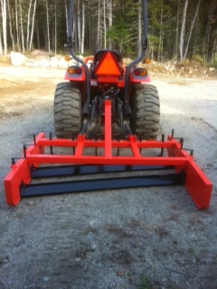

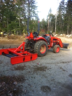

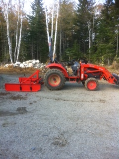

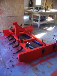

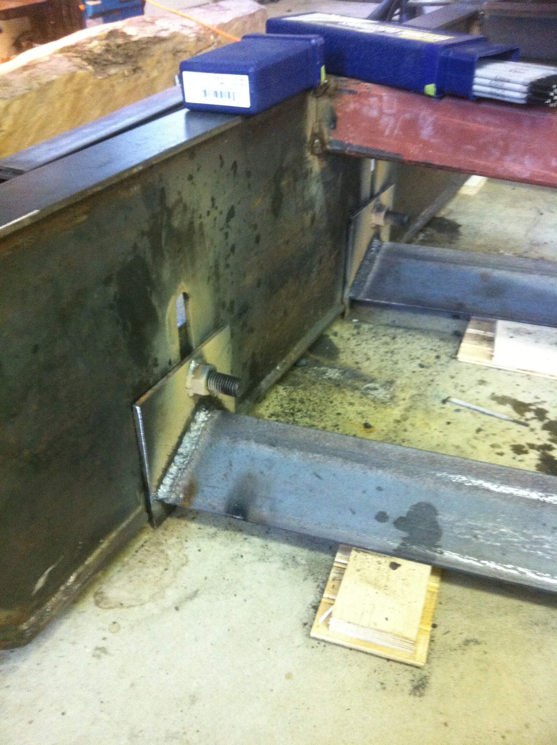

Just wanted to share this land leveler completed. It's 6' wide has 2 cutting edges at an angle and each one is independently height adjustable for flat grading or crowning my driveway. I built it with the rippers just in case the ground needed some persuasion. Used it a few times and it works great, thinking about adding a tow-able 60" X 24" steel roller for compacting the loose material on the final pass. I also have a box scraper and a york rake, but this grader outperforms them both. enjoy!:D

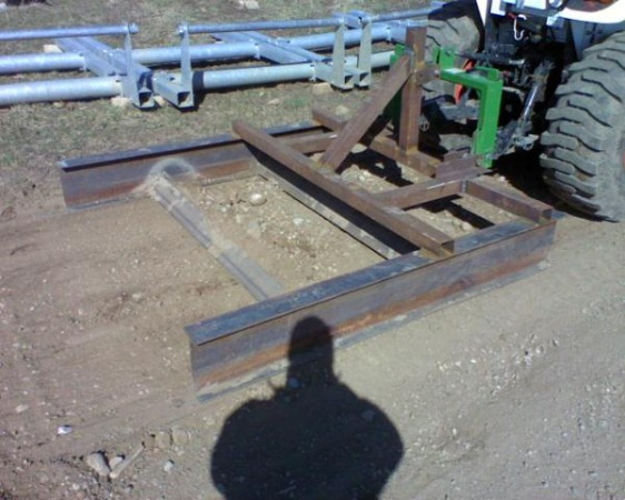

Looks great!! How did you make them adjustable? I may build another now like yours, as I built mine straight and non adjustable,

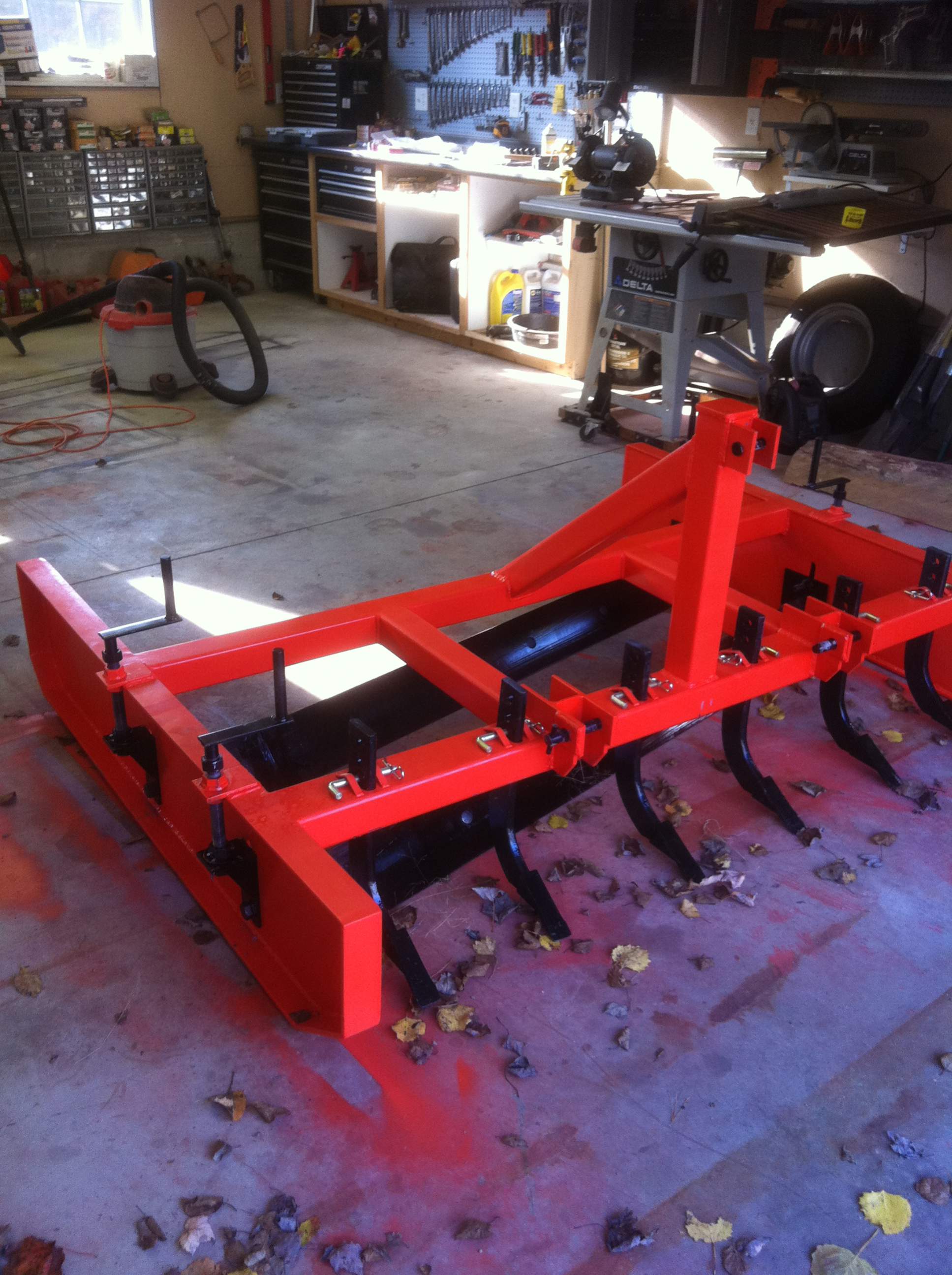

Nice job :thumbsup:. I am verry interested in how you made the blades adjustable. It would be great if you could get us some better pics that we could blow up to see how you did it. I have an box blade that I was thinking of converting to a land plane. I think it would be pretty easy to convert it.

The main thing it will need is skids.
Two other differences are that the land planes have a 2nd blade parallel to the first, & the blades are slightly angled to direct material toward the left for road crowning. I think you could make a pretty darn good land plane just by adding side skids, though.

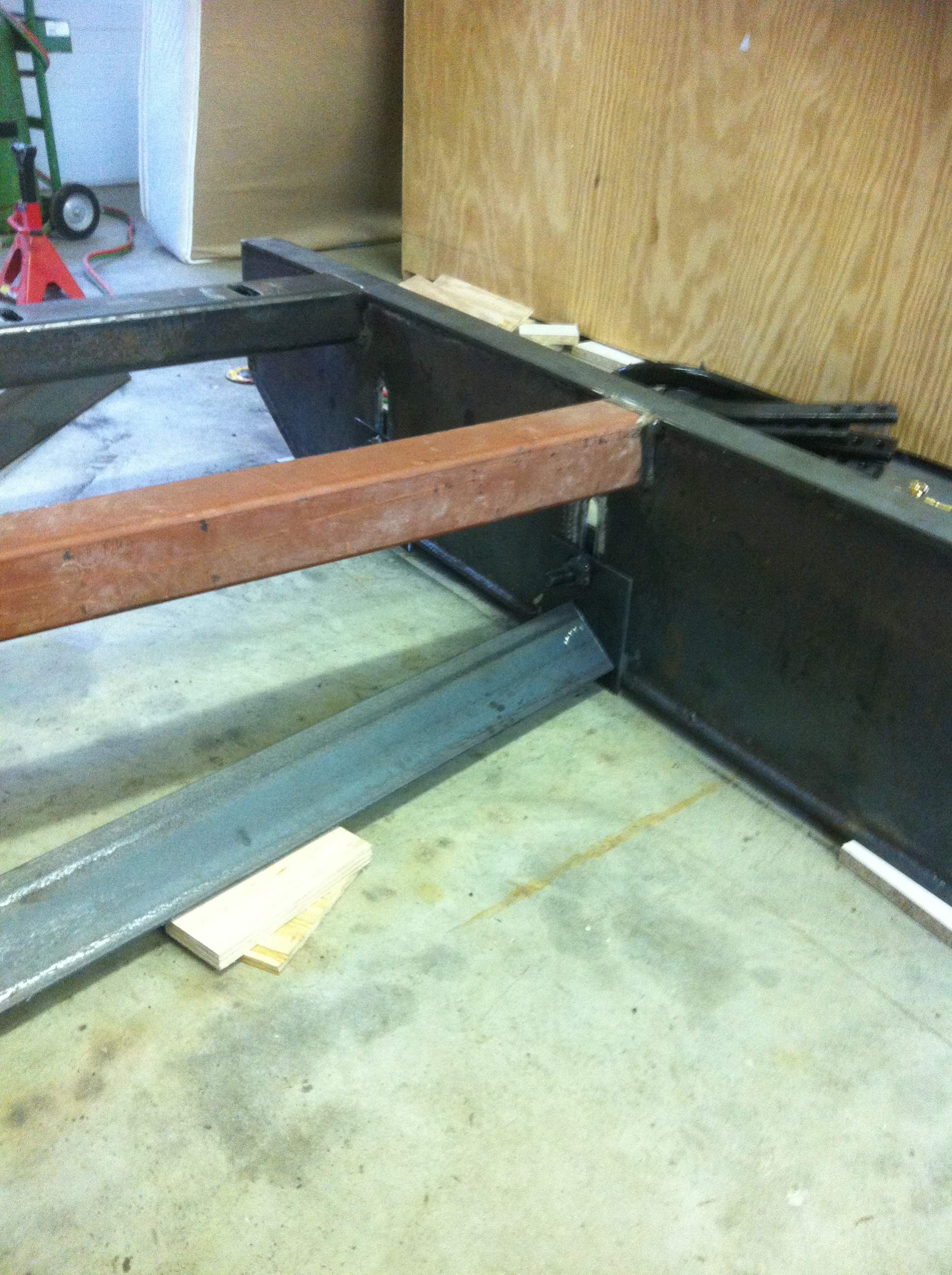

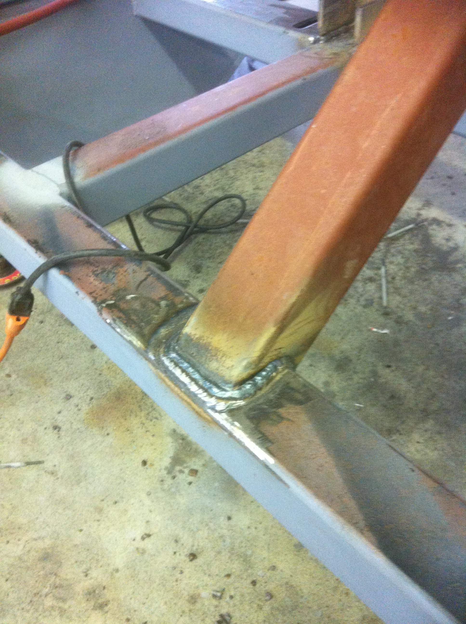

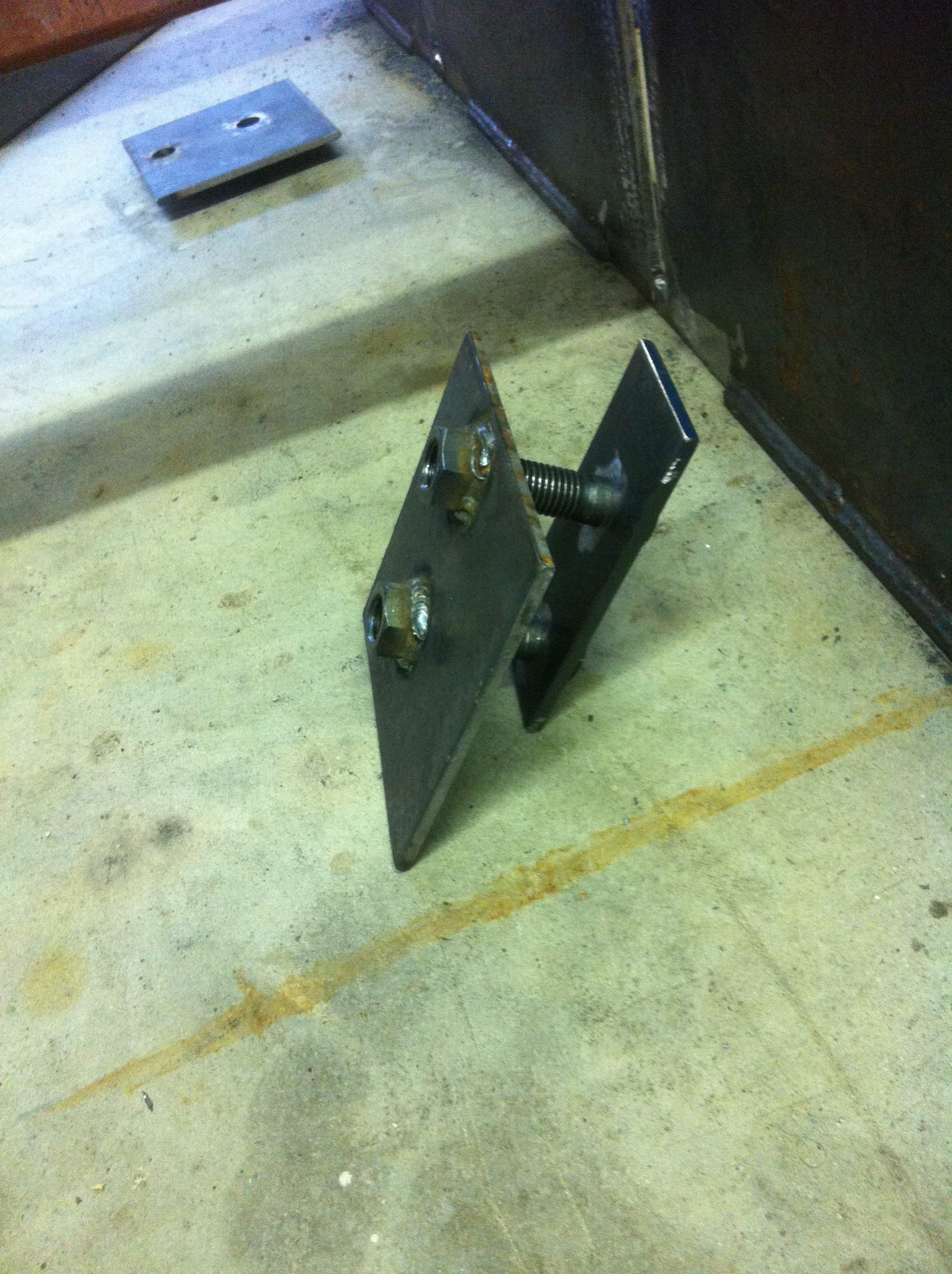

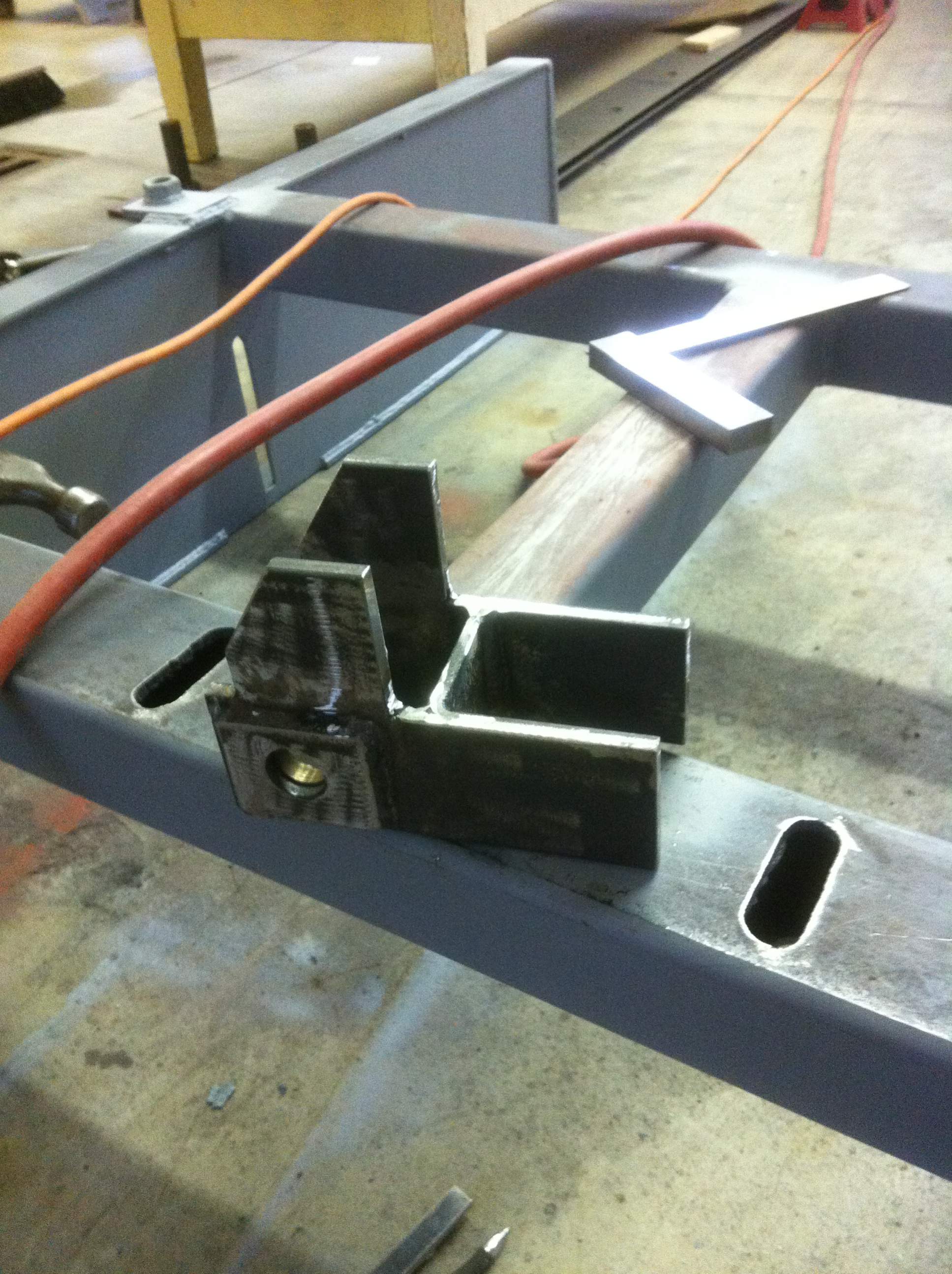

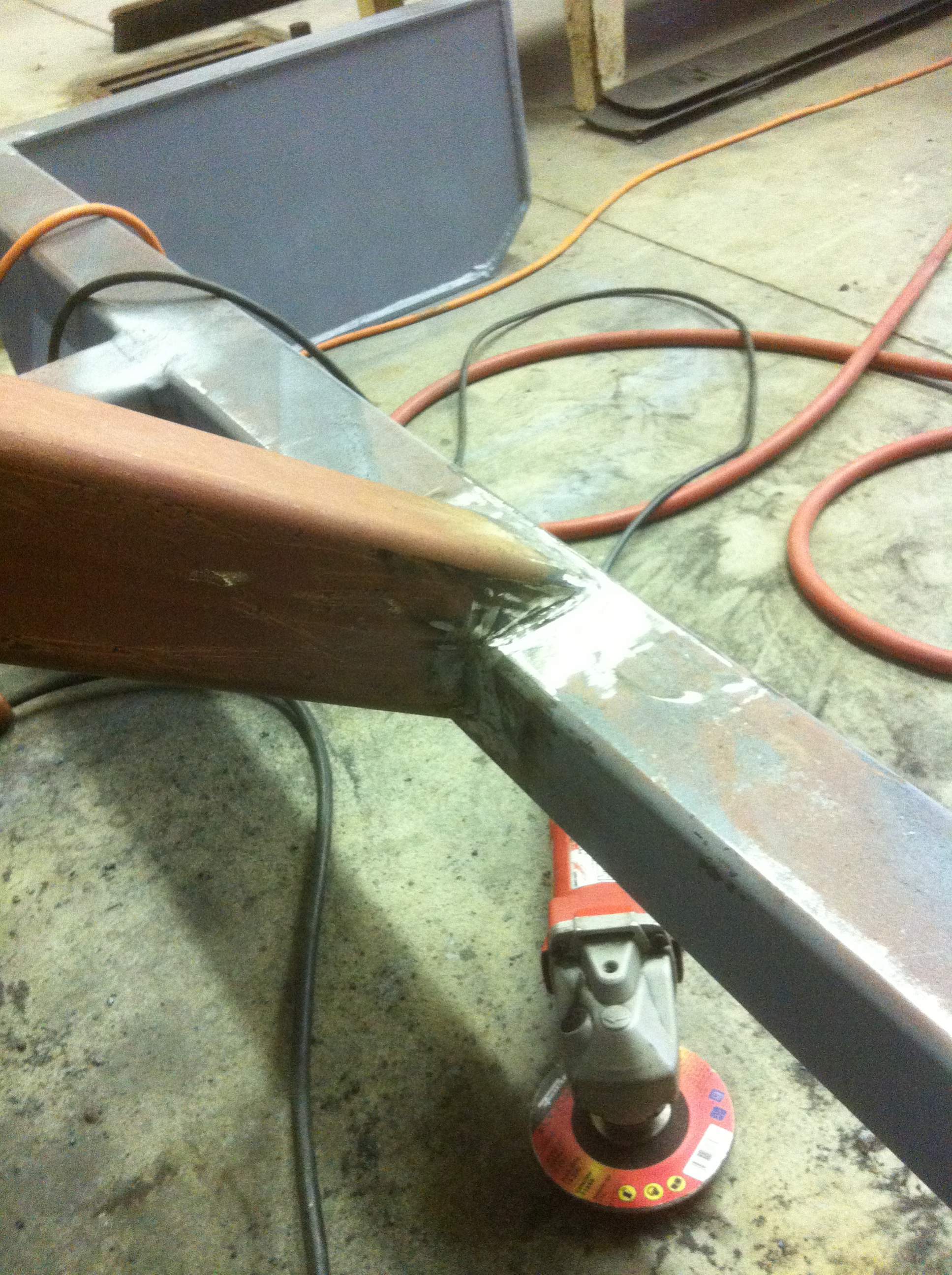

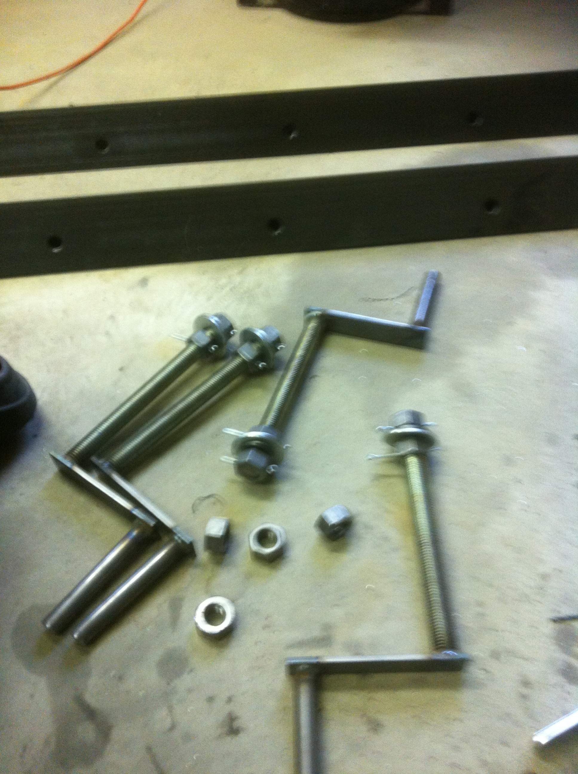

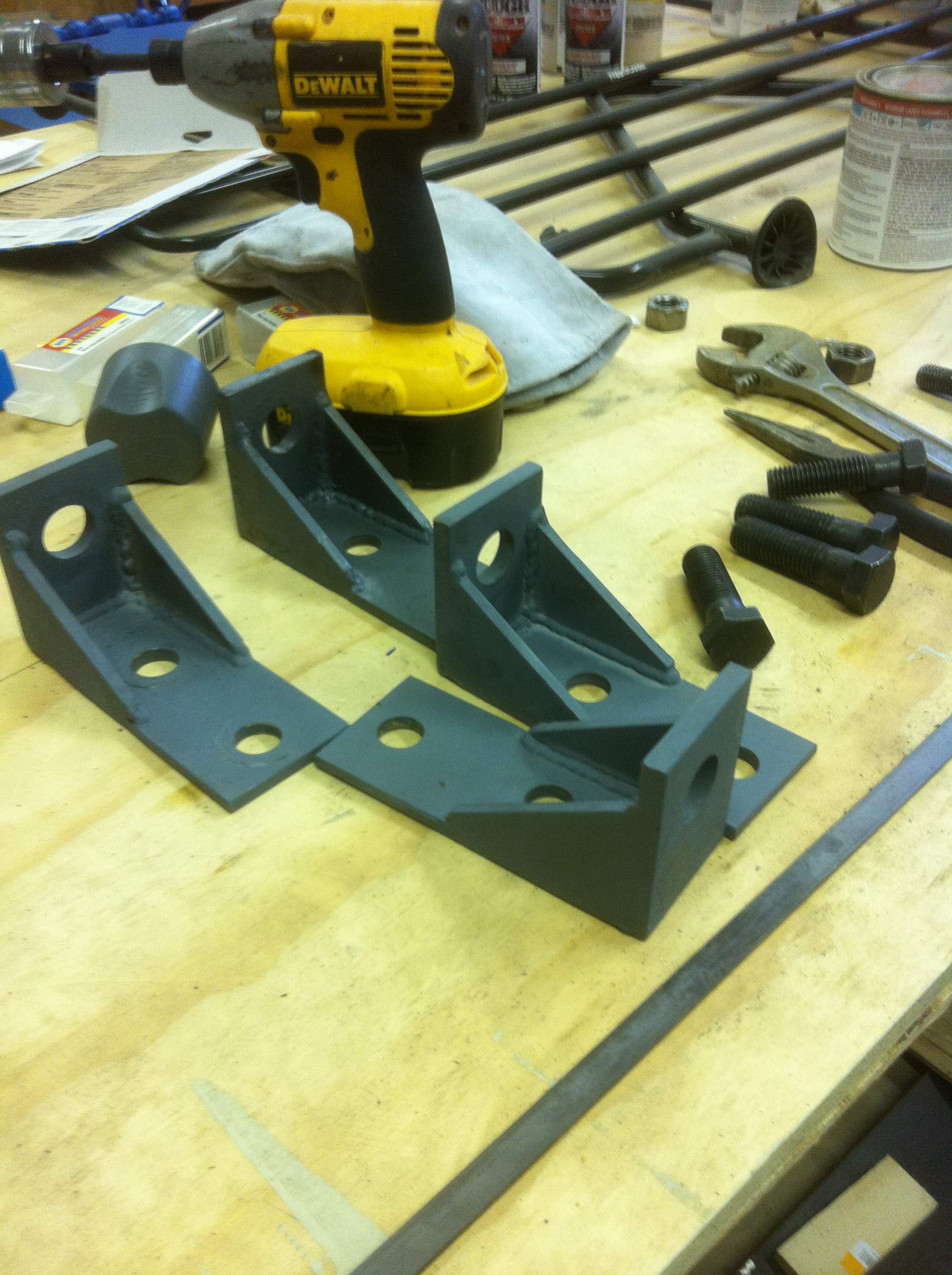

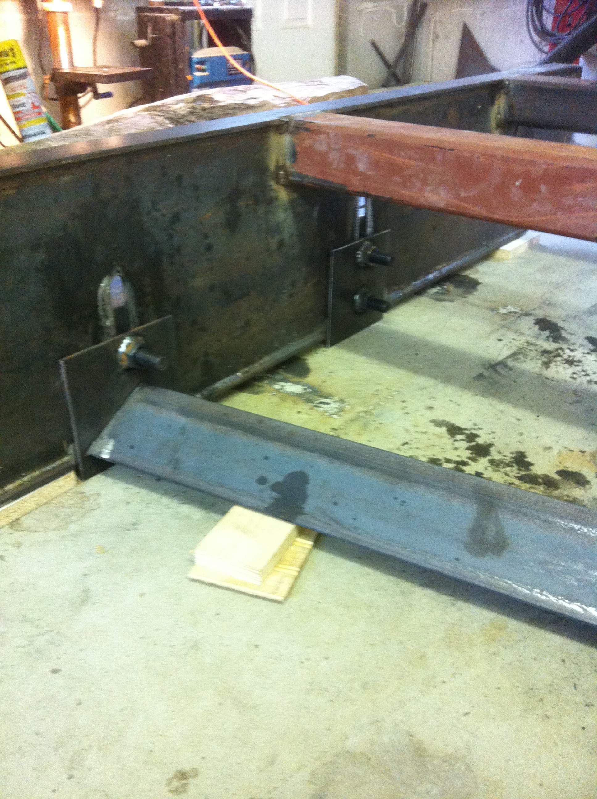

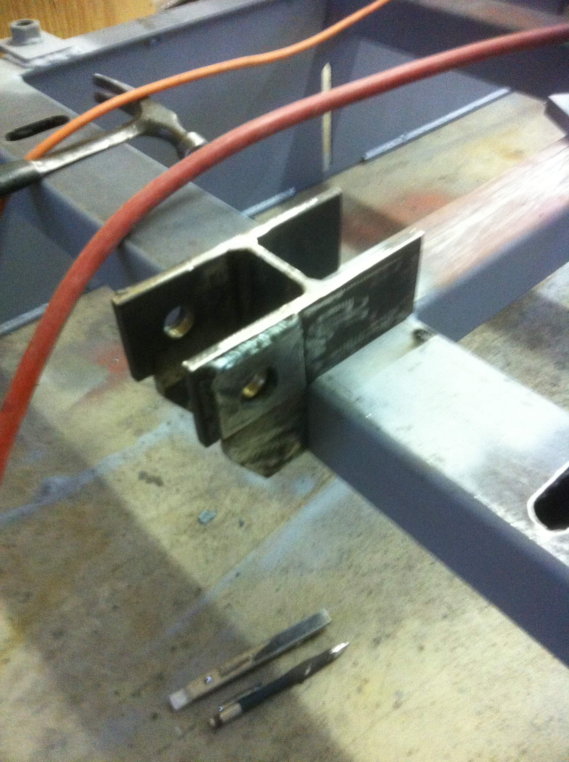

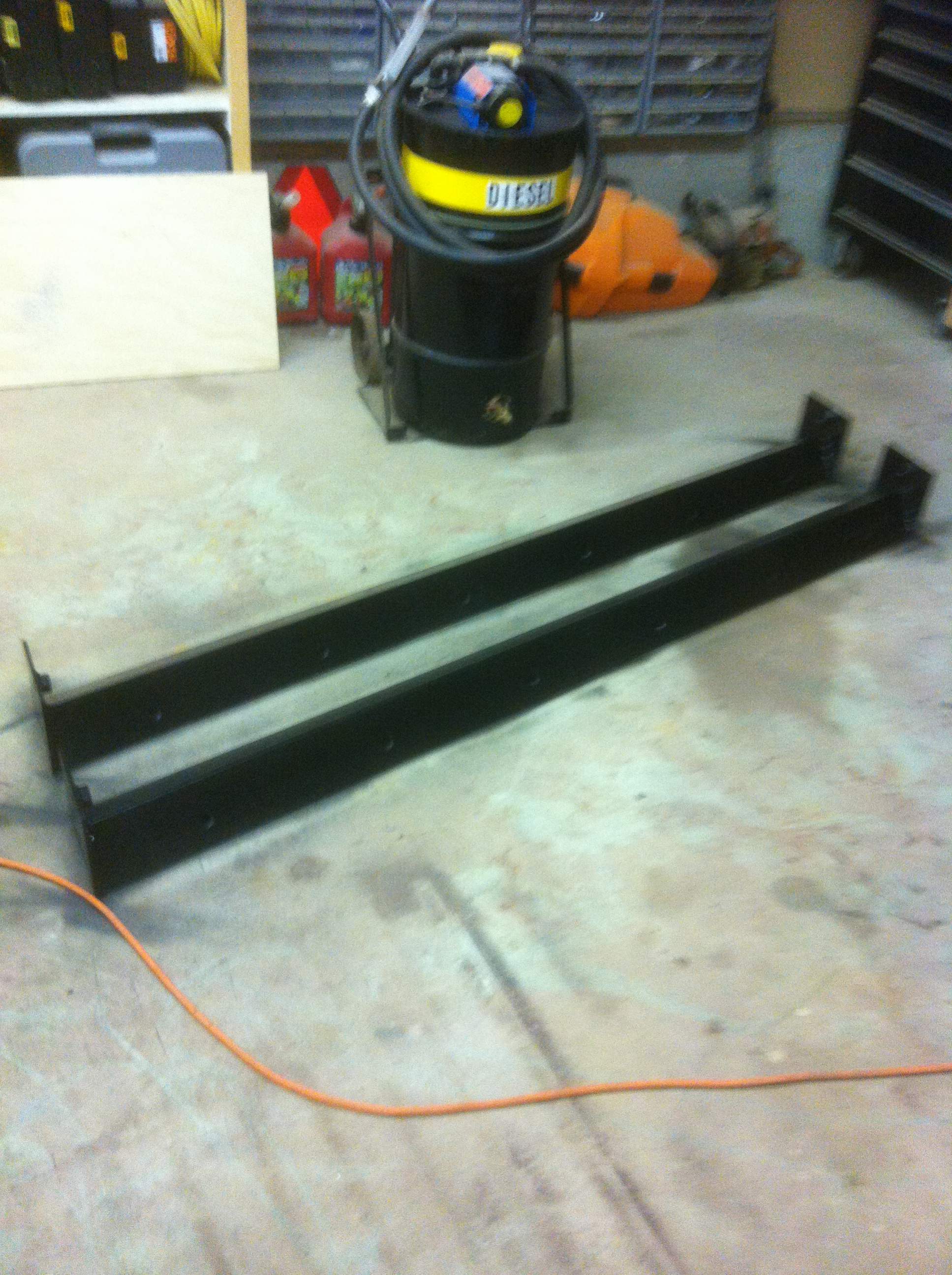

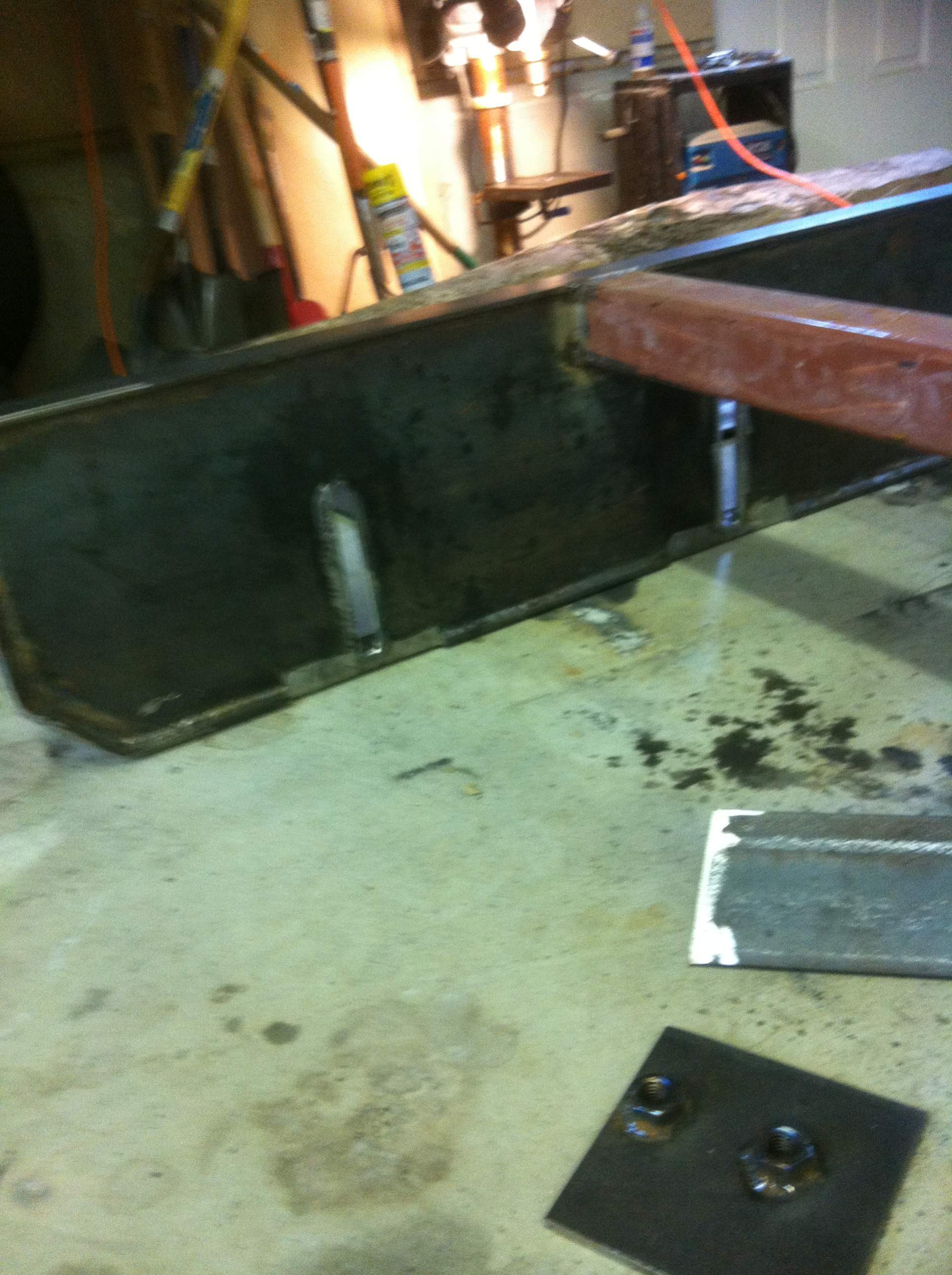

I hope these photos help, it's what I had on hand. I will not be home for a couple of weeks. What I did was cut slots in the side pieces and then fit 4" x 4" x 1/4" angle that a plate bracket was welded on the ends. the cutting edges were bolted to the angle and i used 6" x 1/2" cutting edges with center holes so that i can flip them as they wear. I made a strengthened L-bracket for the outside pieces which (2) 7/8" grade 8 bolts go through the slots and allow for the up and down movement without twisting the cutting edges. the bolts are threaded to the inside bracket plates which are welded to the angle iron used to support the cutting edges. the screw jacks thread through the welded (nut to plate) on the top, and attach to the L-bracket at the bottom. The the threaded rod goes through an enlarged hole in the L-bracket which spins freely. to hold the L-bracket and allow the threaded rod to spin I just used upper and lower washers and nuts. the nuts have a hole through them and the rod with a cotter pin to prevent turning. I hope I explained this OK. I'm trying to be complete but brief. Oh one more thing, my handy helper was my quality control adviser. An absolute must for the amount of welding and fab required without using any drawings or prints. If you'd like to have measurements with a sketch, it will be a few weeks!
