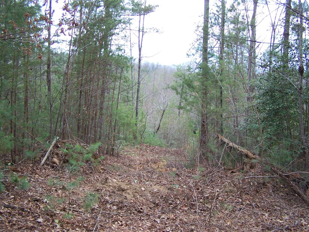

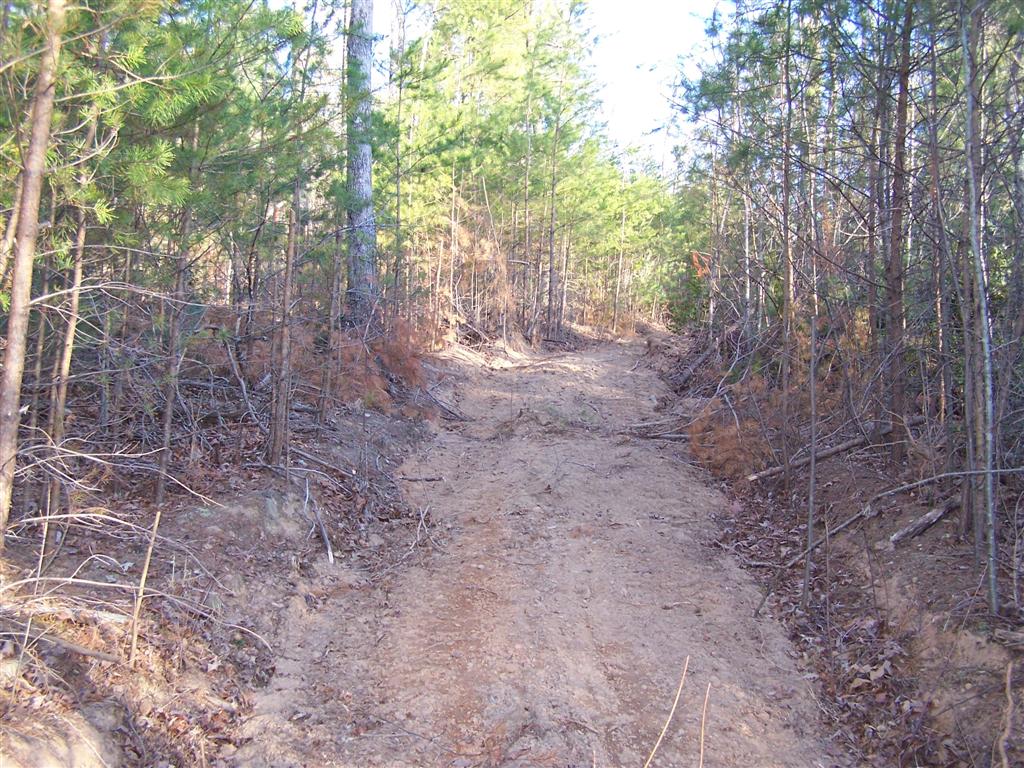

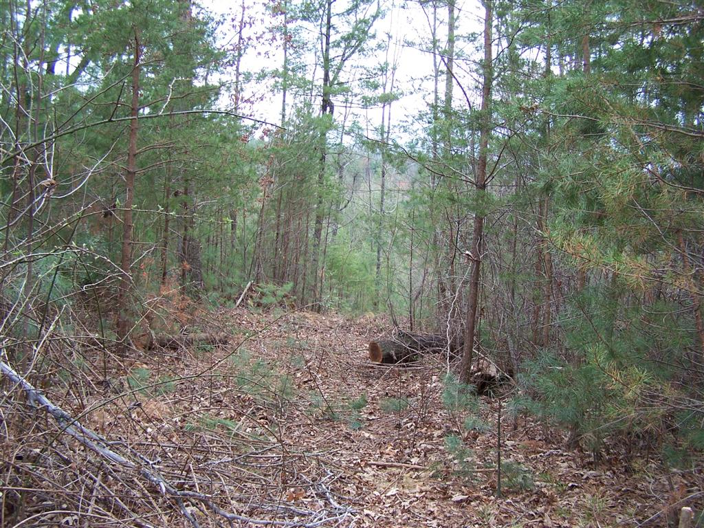

I have spent the last year clearing land and building a road where we are constructing our house. So naturally I have been reading a lot of TBN but not really had much time to post.
Now that the house is under roof and things have slowed somewhat I was able to load some pictures.
So I hope I don't bore you in the beginning with road and land pictures. I have track loaders, stumps, and crane pics to post later in the thread.
The first set of pictures is the road bed I had going into my river bottom and I had thought about continuing this road around the base of the ridge.

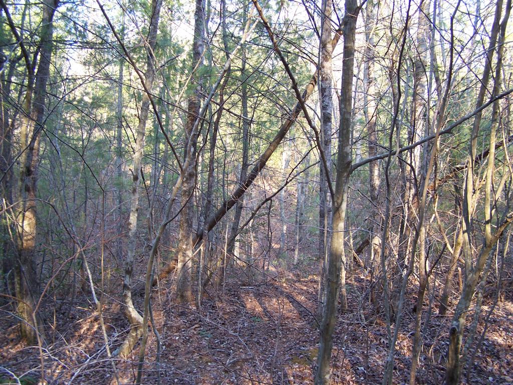

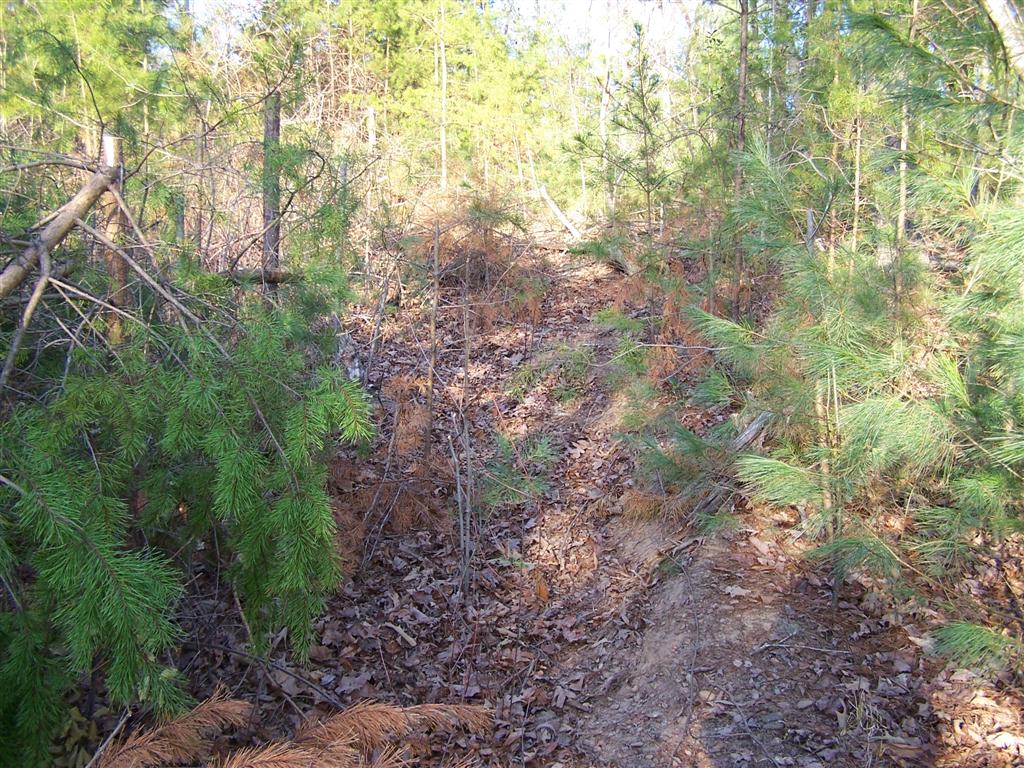

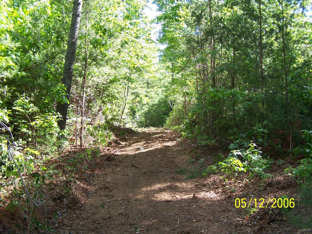

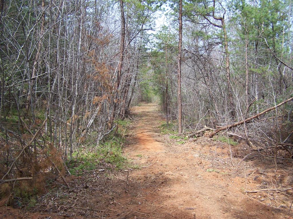

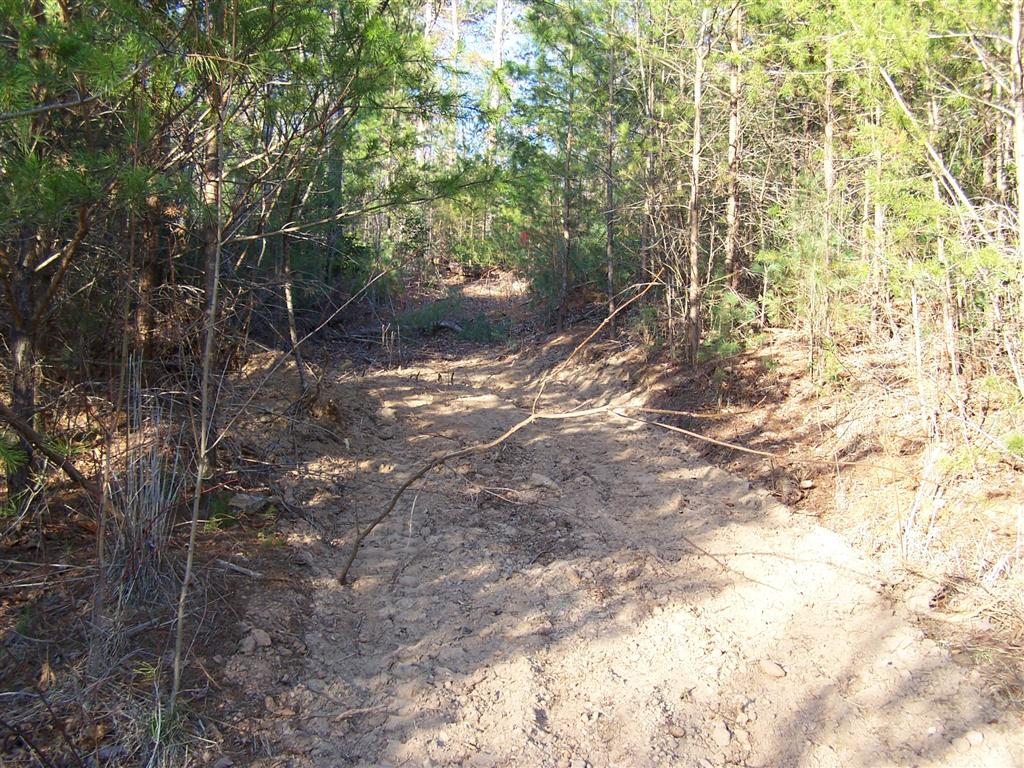

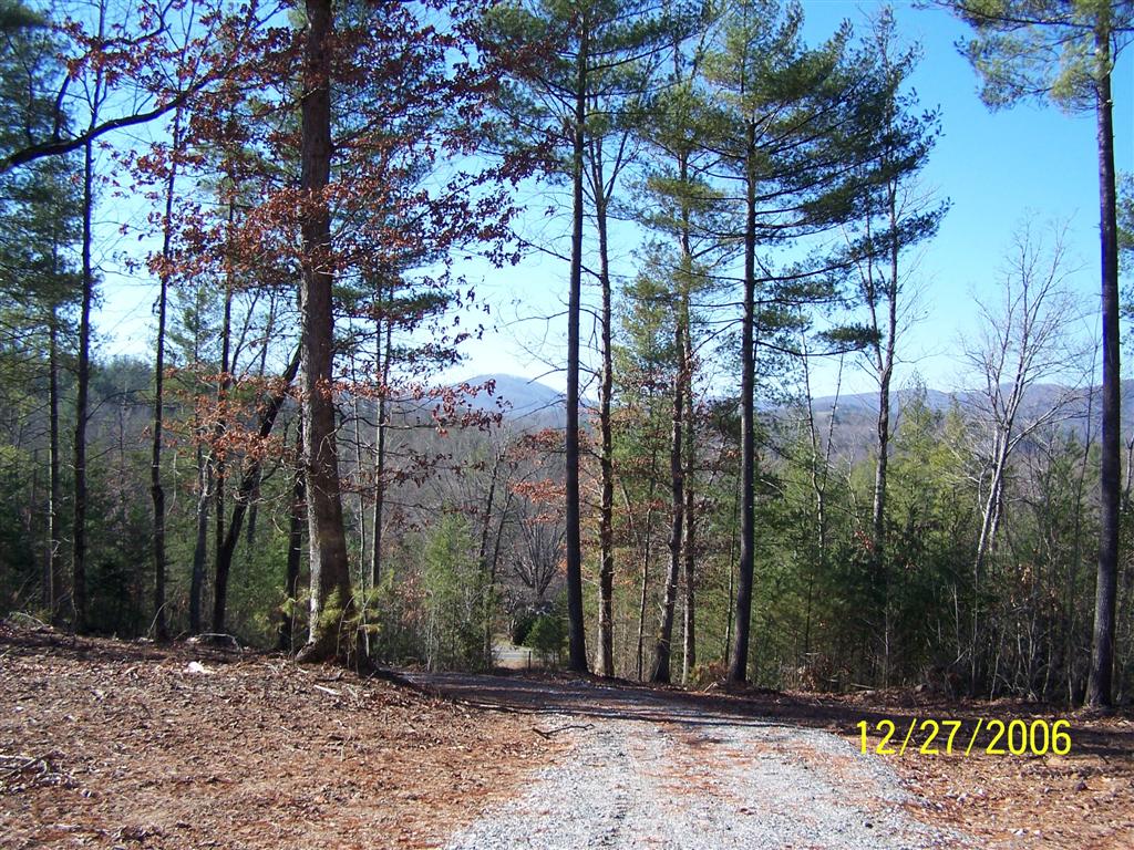

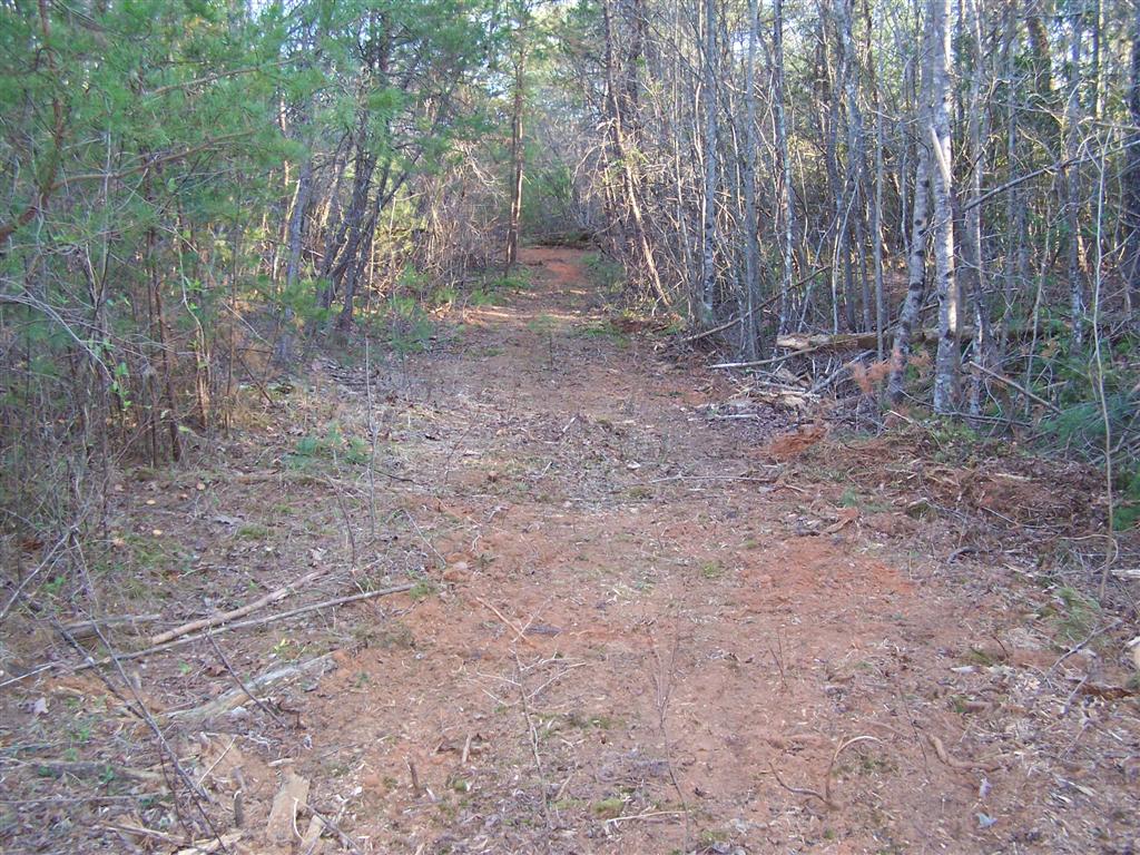

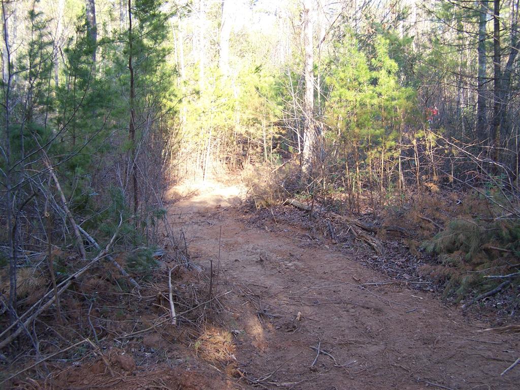

These pics show where I extended the road. I cut most of the small pine off at the ground and used the box blade to pull the stumps as I graded the road. Some times if the trees were 6" or larger I would have to use the FEL to push over and pop the stumps out. There were not many large trees on this section.

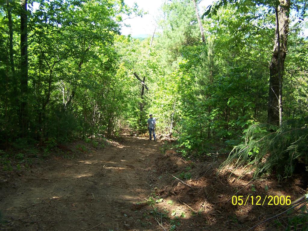

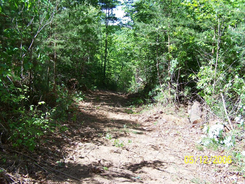

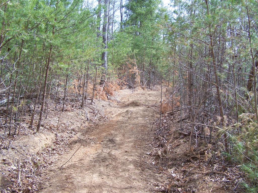

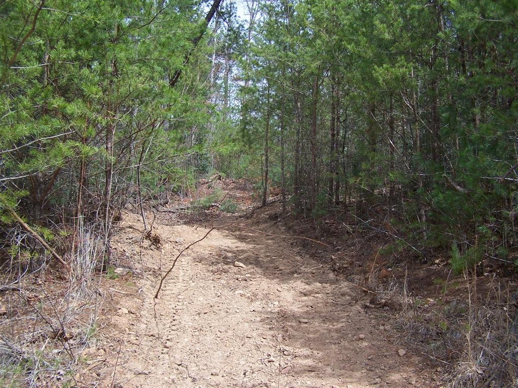

A few more pictures of the road to the river bottom.

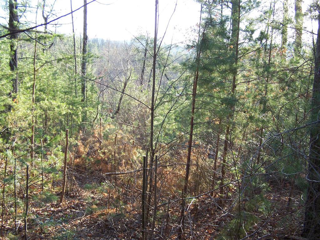

This next set is at the top of the ridge and a small clearing I had cut out with the chainsaw.

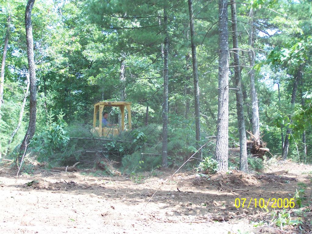

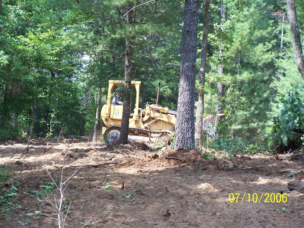

I realized the 3130 would take a many weekends to clear the undergrowth and small trees. So I hired the track loader.
Here are some of the action photos.

Cool Pics, always like looking at those kind of pics. I see you do have the right tool now. I thought I was going to clear a house area with some hand tools (a very small area to, hundreds of little Elms). Wanted to do it myself and all. That lasted about 1 hour. I went to get my BIL's JD350 and never looked back. You need to get up the roots and all from that stuff.
I also agree with Rob that if it starts to rain those roads are going to suffer real bad. Even that loose stuff around the house site. A good quick rain and it'll all run down the hill (DAMHIKT!!). Lay down some small stripped tree trunks or something to slow things down. You have a lot nice soil there!

Heck no! Those are great pictures. That track loader made short work of that area. How did you have him out there?
