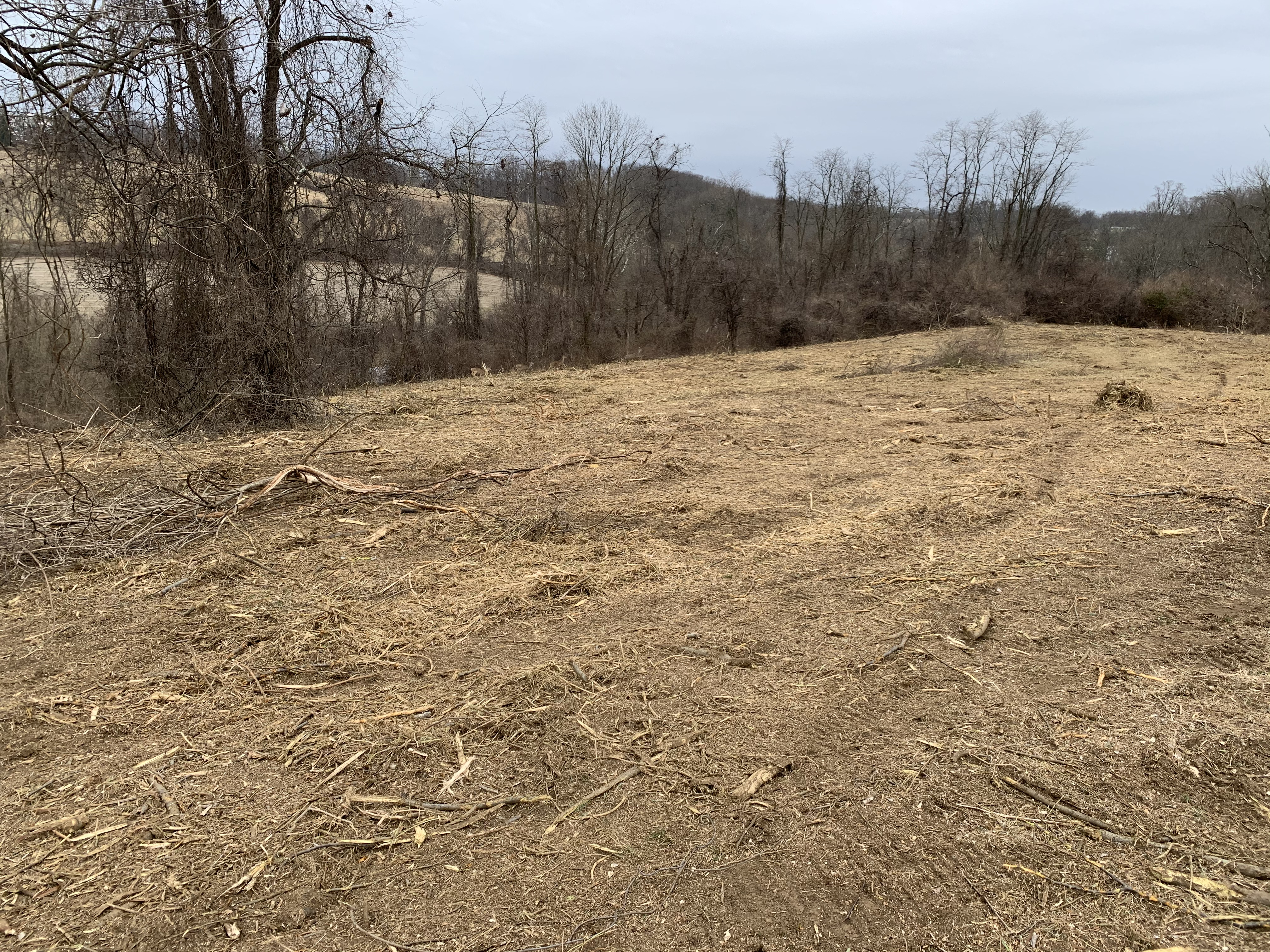

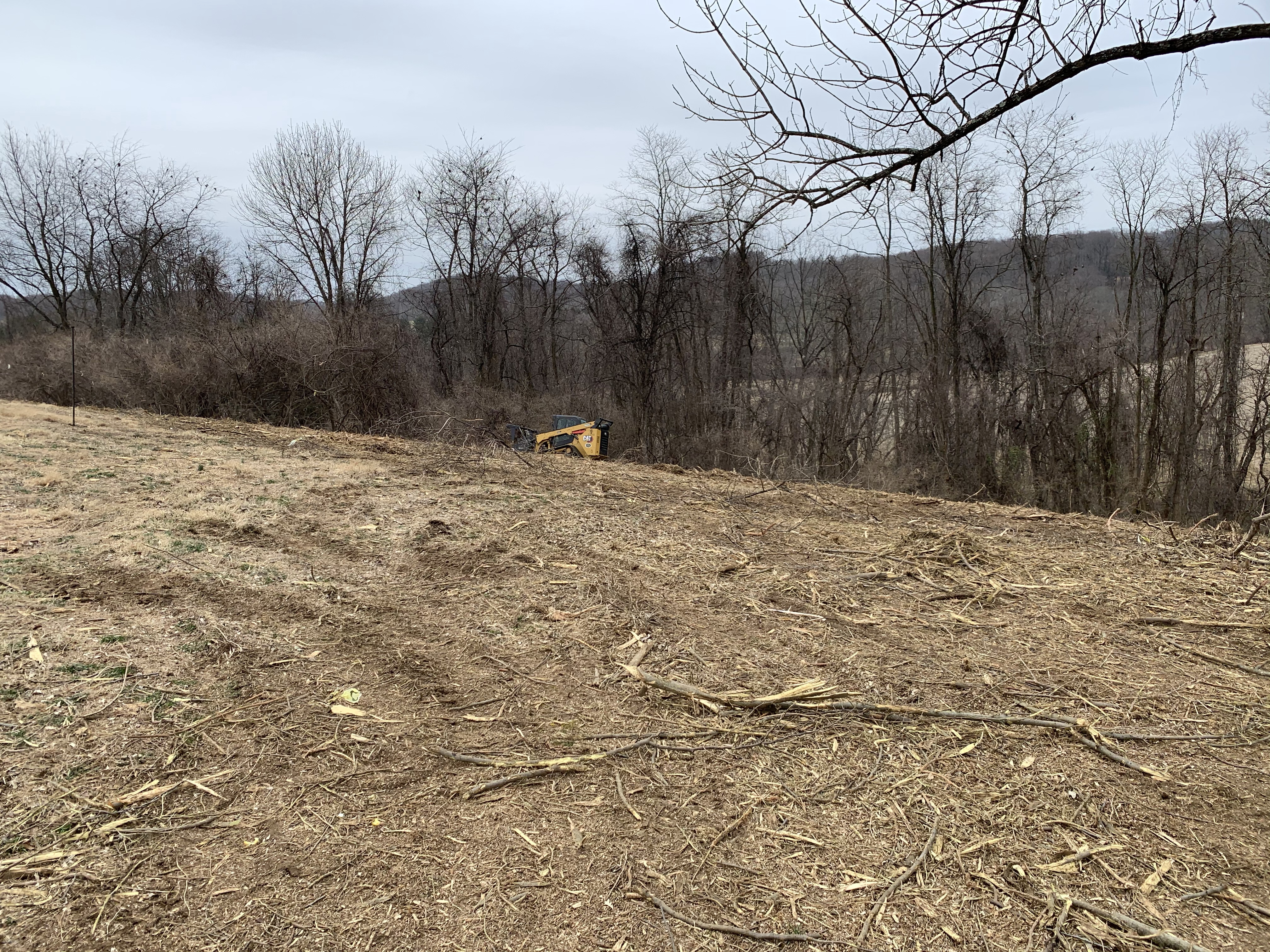

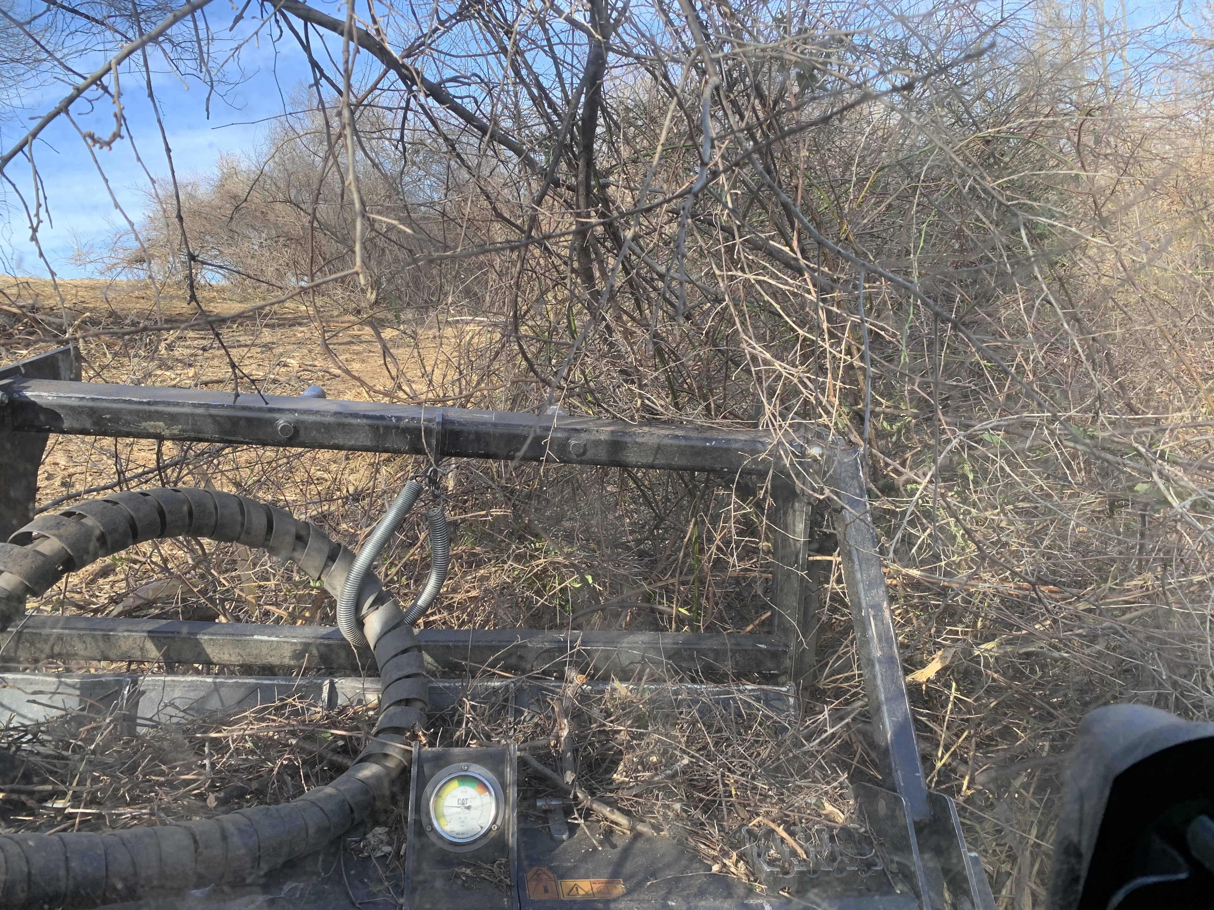

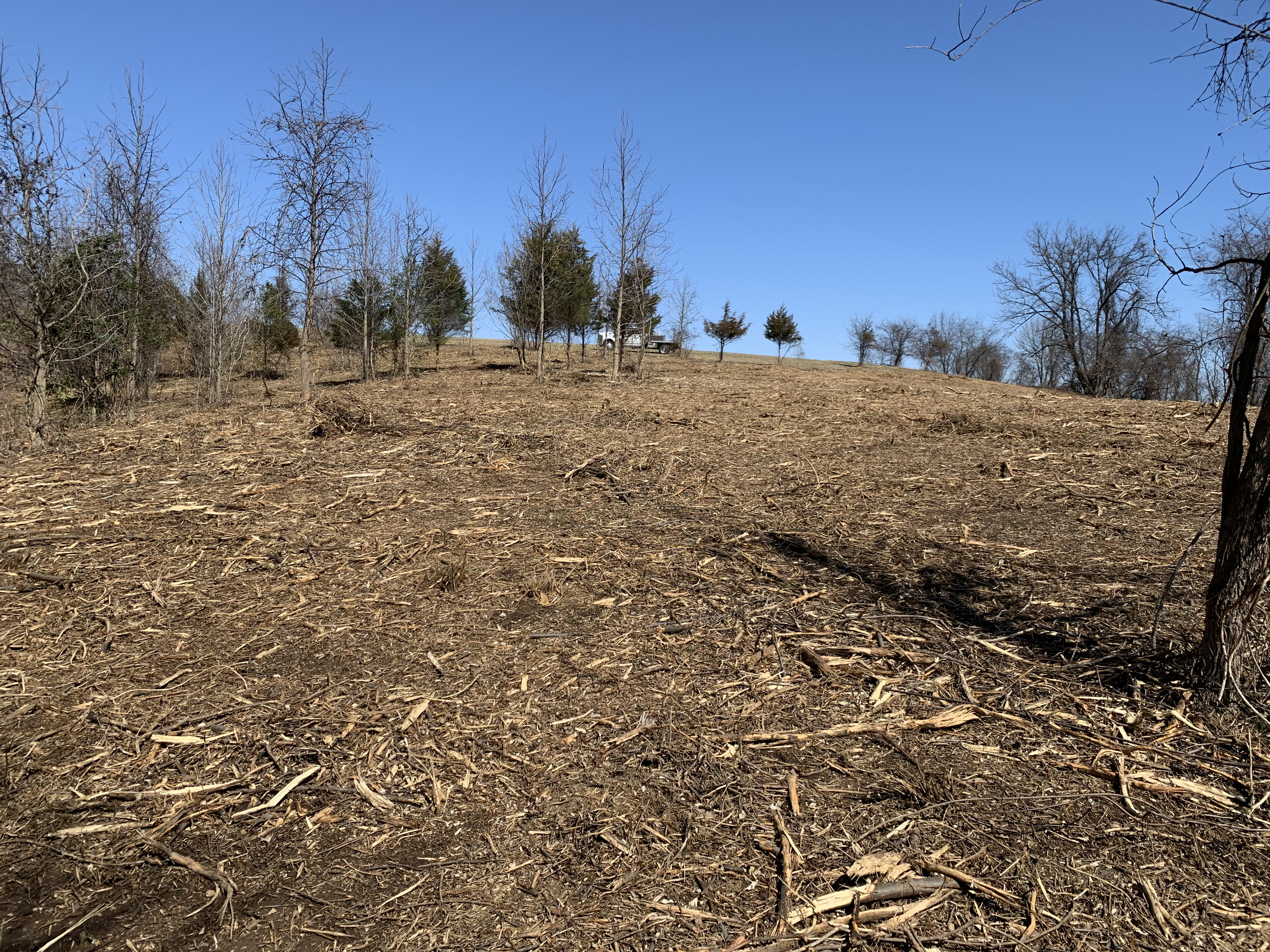

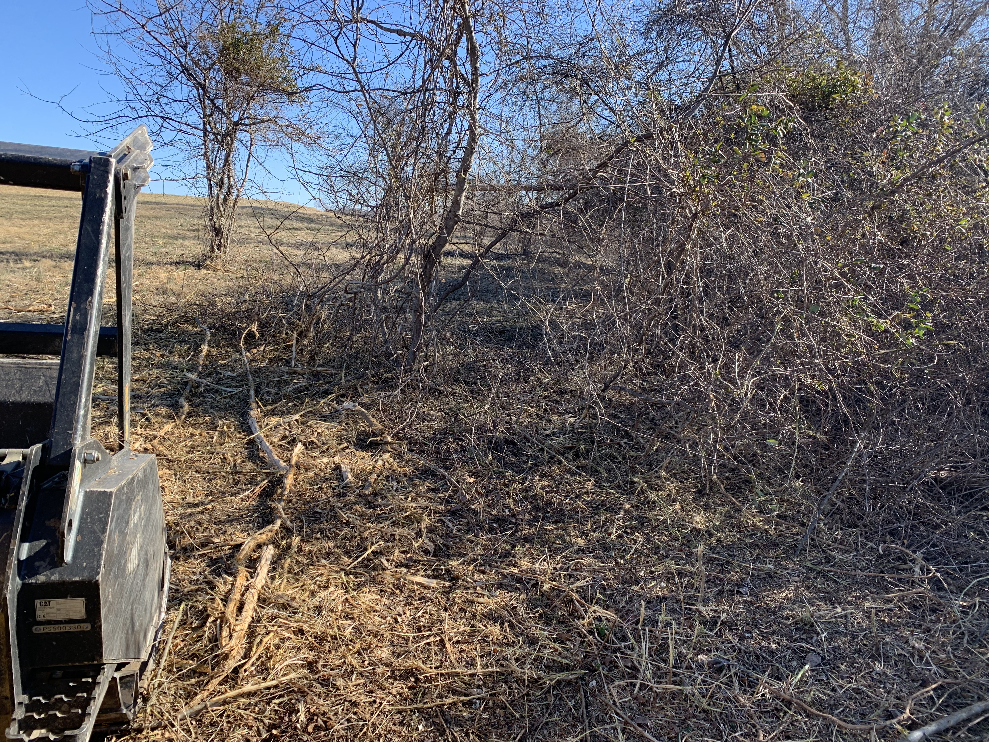

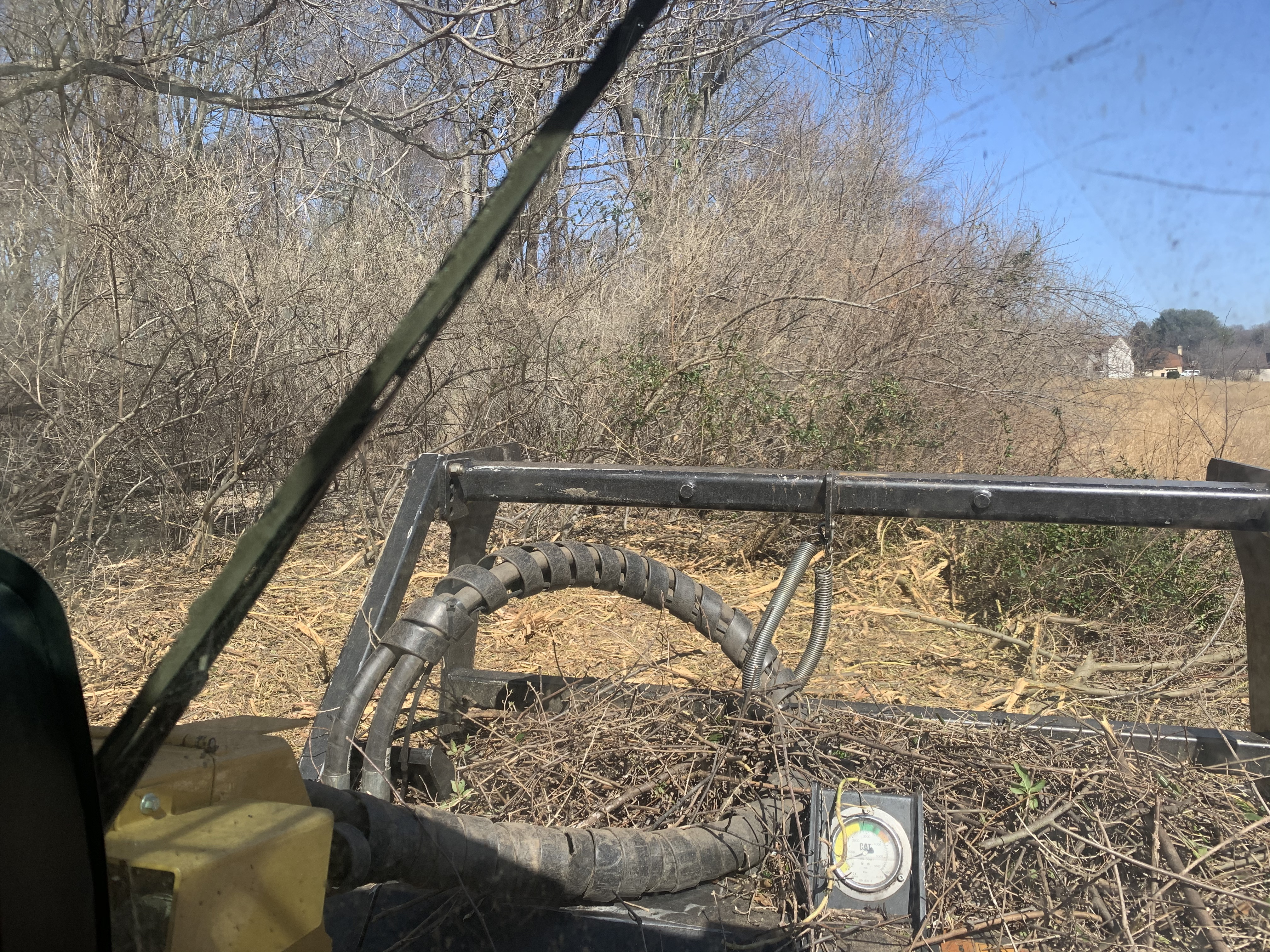

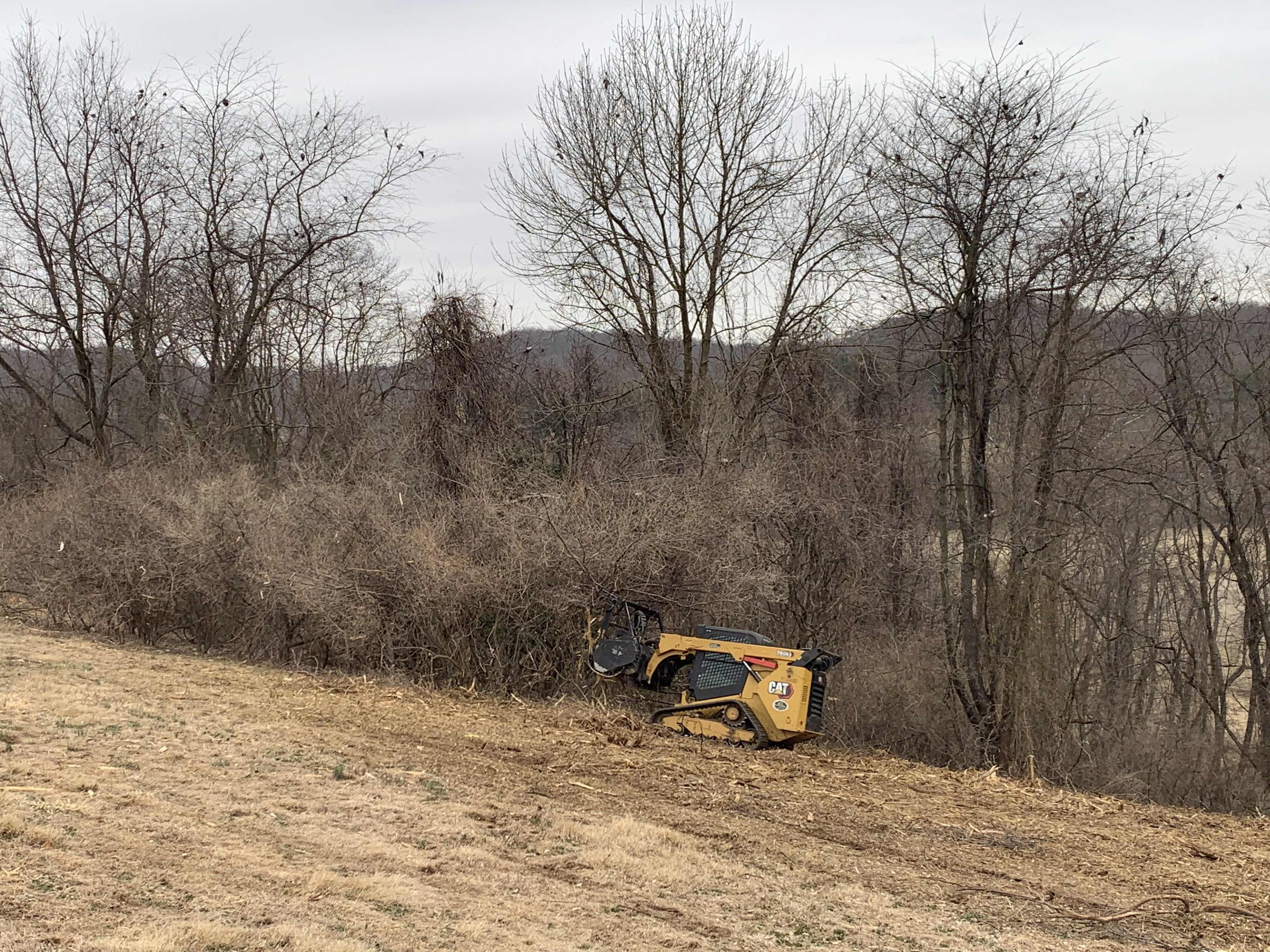

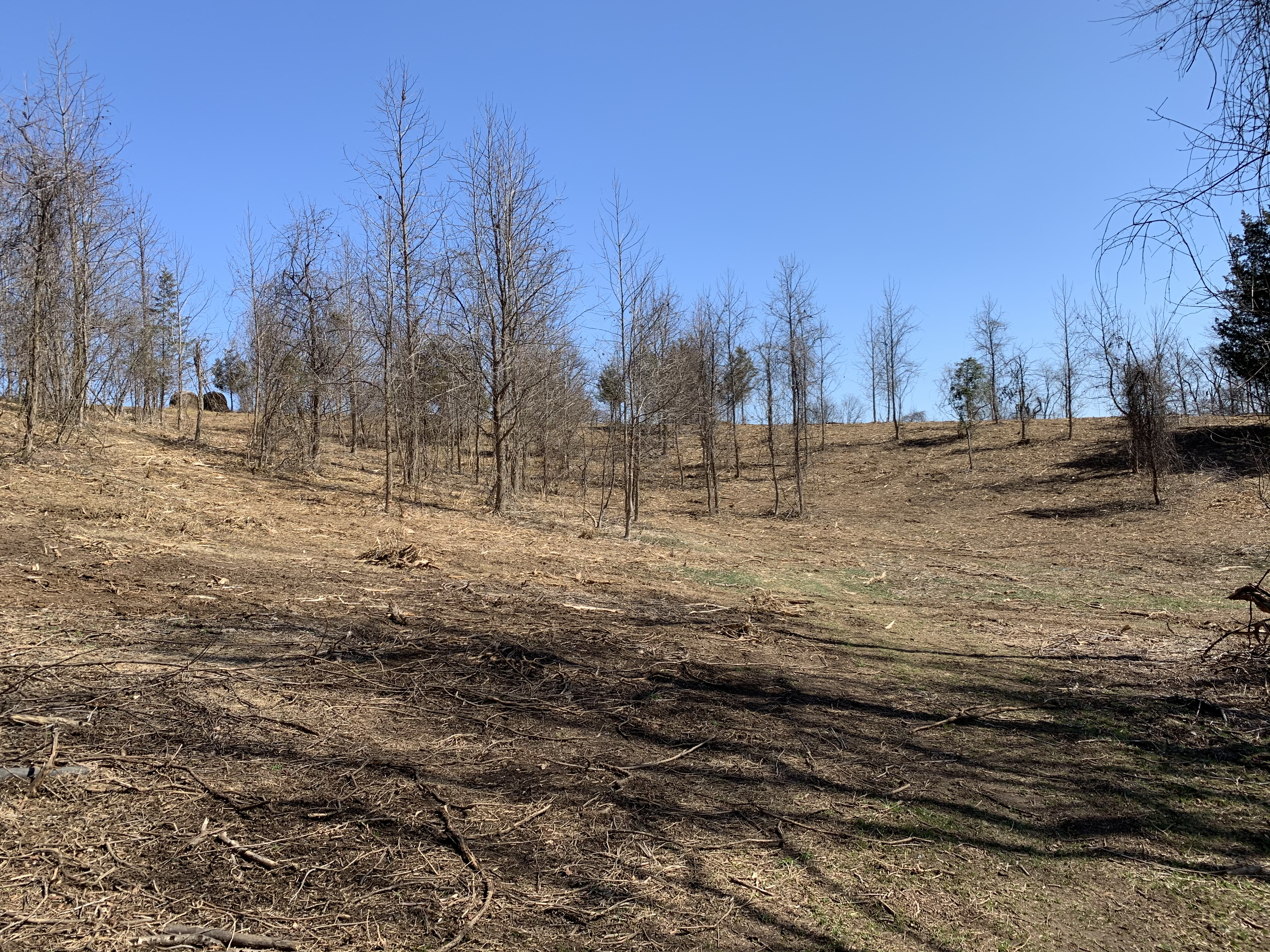

I took out mostly 2-4” autumn olive, Russian olive & sweet gum. Sometimes I would work around a 6-8” cherry or sweet gum, then once the brush was cleared around it, take it down.
We also dropped a few large hardwood trees and the property owners land manager would saw them up for firewood. Used my 24” Makita (Sachs Dolmar) for that.
I remember 1 or 2 were about 40’ tall and 8-9” at the base. That was the biggest with the machine.

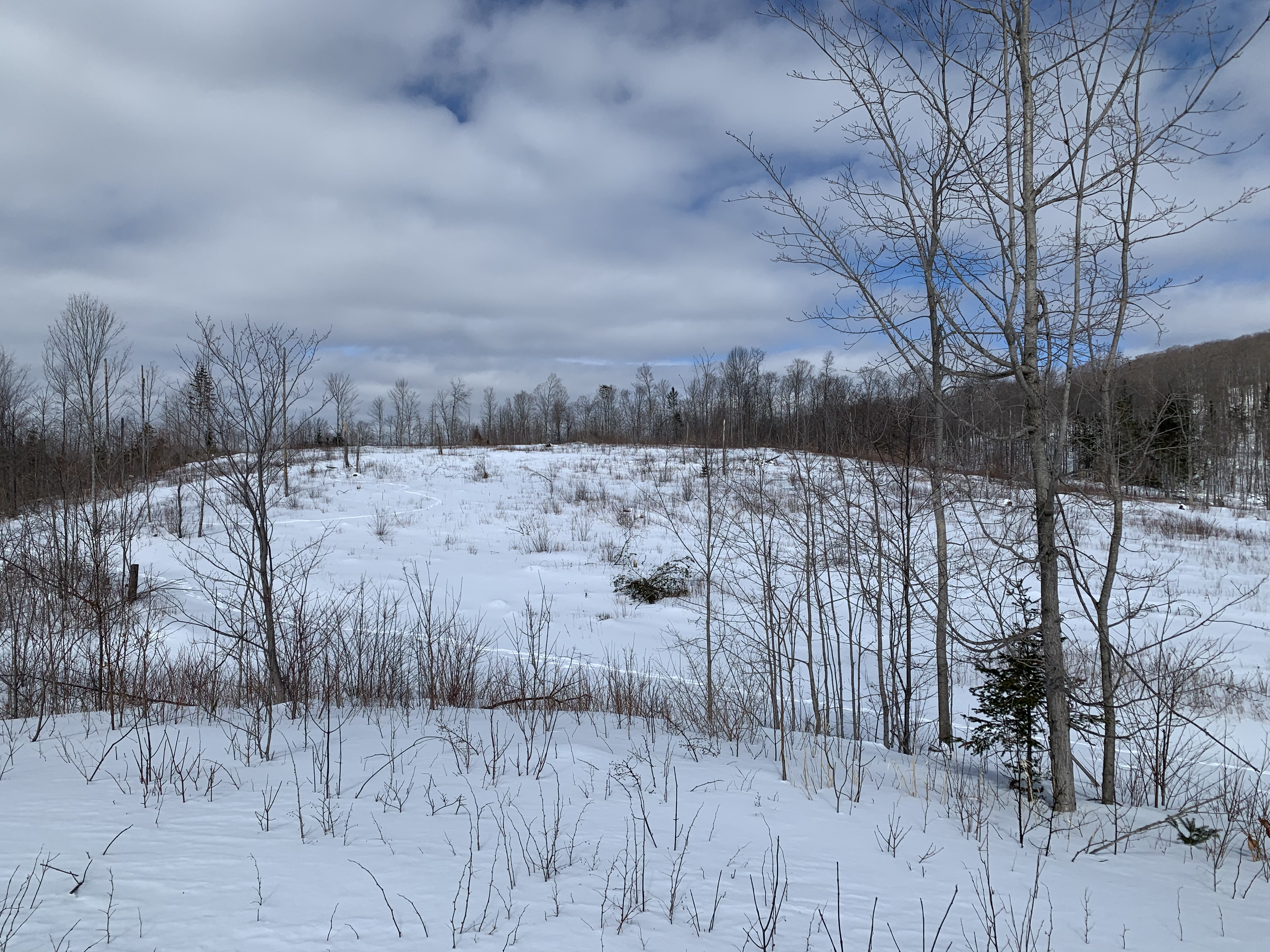

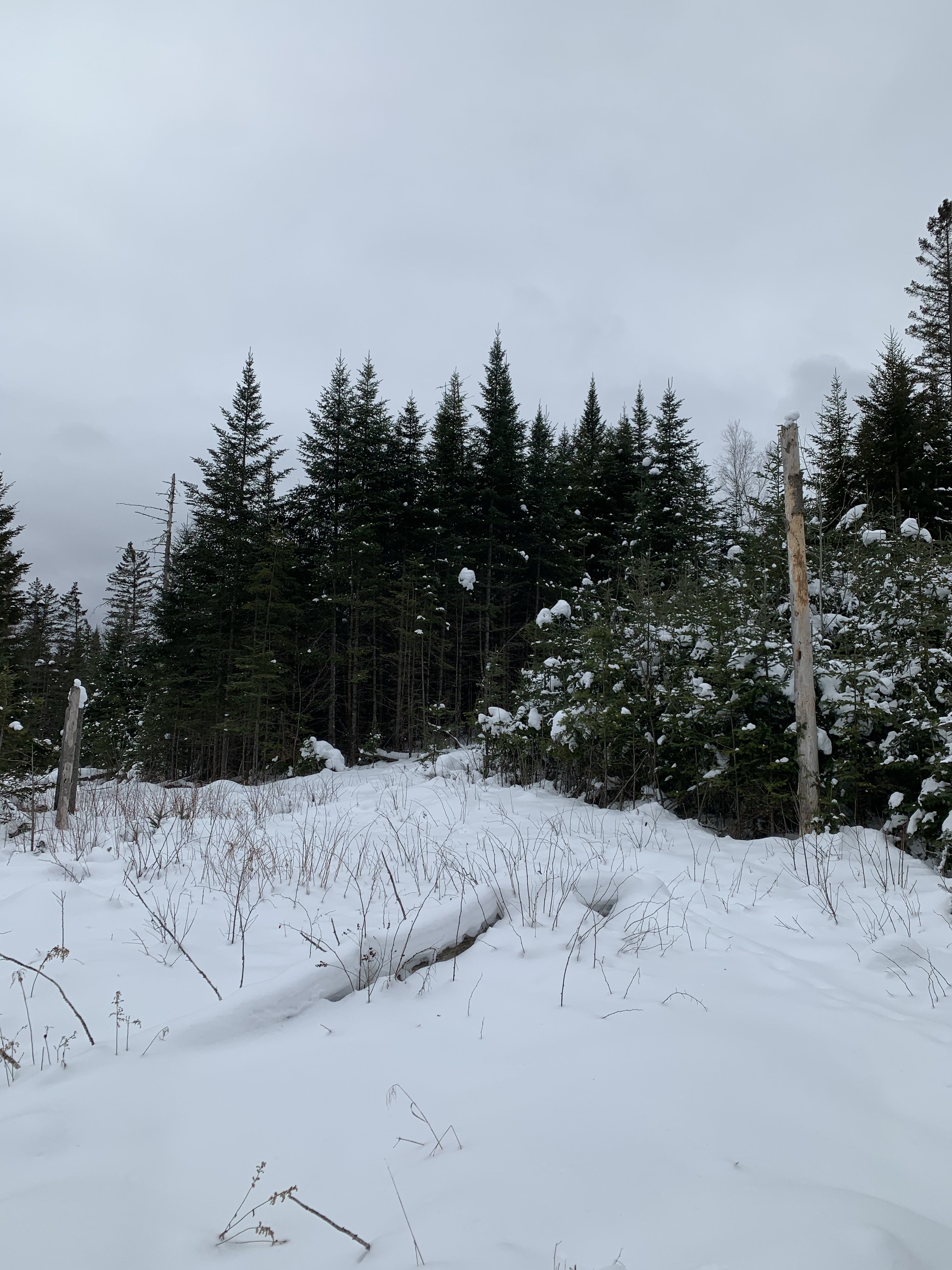

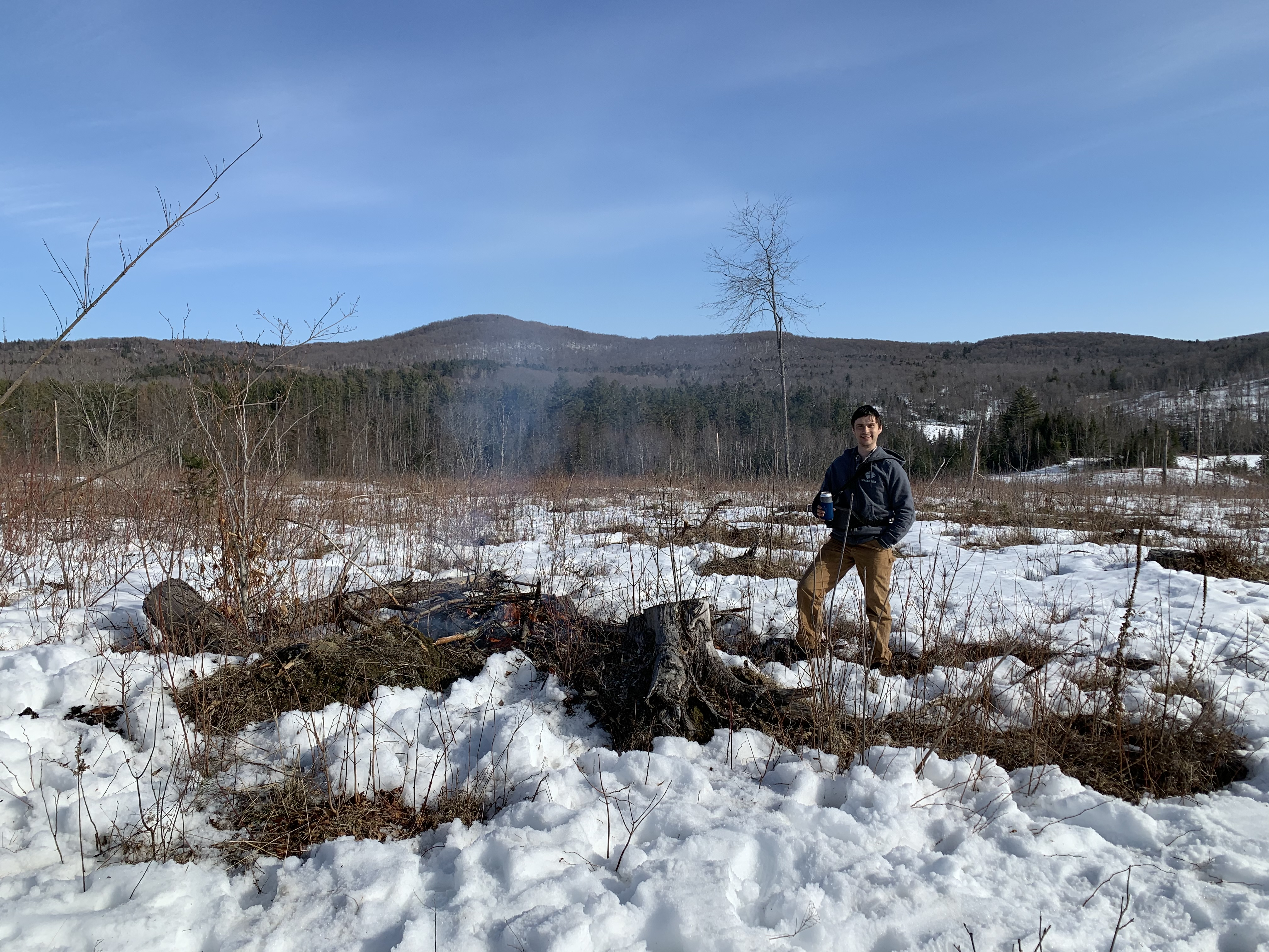

Did you consider buying a PTO mulchers for one of your tractors, instead of the skid-steer route? I’m curious as it looks like youve got some burly M-series plus that hoss of a Massey-Ferguson that should handle a PTO mulcher well.
I have a similar project on 224 acres I just bought (obviously not looking to mulch it all lol). There are a lot of softwoods that were heavily logged (basically clear cut.. ~40-50 acres in total) that I’d like to either clean up to replant or a establish a combination of food plots and pasture.
My plan is to buy a PTO mulcher for my 7060 this spring/summer and spend the year working with that in combination with a root grapple. If it’s too frustrating/doesn’t work out my contingency is to sell the mulcher, then hire out a professional next year to get it done. I like the idea of owning and then slowly working on this over the next 3-5 years.
The cost of the PTO mulcher (I’m looking at Seppi) is $22K plus tax, while hiring it out would be $1,600/day for a skid steer unit who said he can do about an acre a day under good conditions.... so I’d be looking at at least a $15,000 bill for hiring out the bare-minimum amount of work i need done.
Theres also a rental place about 25 minutes away from me that rents high-flow Takeuchi skid steers with FAE heads. They said “we don’t rent to homeowners” ... well I’m not a ”homeowner”, I have a small scale forestry operation with skid steer experience, so i imagine I could talk them into it (but I don’t have a goose neck and a truck that can pull the 15,000-18,000 lb weight of the equipment, and I’m not sure if they’re willing to deliver it). The cost is only around $3,800 for 45 machine hours (one week) which is quite affordable IMO compared to the other options, but I just don’t like rental equipment. Renting is the least-preffered of the three options, but still something I’m keeping in the back of my mind.
I’d love to hear feedback from others who found themselves in a similar situation.

After reading your post, the rate quote you recieved of $1600 per day for a skid steer with forestry mulching head is right in the ballpark. I paid $1500/day, and there maybe regional variations in cost. However looking at the pictures you provided, an experienced operator should do about 4+ acres per day. It's partially cleared, looks like good access for the skid steer, and mainly brush and soft woods.

Yes I'm happy with the quote and the operator I spoke to seems very knowledgeable and honest. He'd like to take a look at the land which I hope to schedule as time allows. Then perhaps he'd say he could do 2-4 acres/day. I told him I'm weighing all the different option; with hiring a dozer and renting a skid-steer/mulcher as DIY being more or less ruled out entirely.
Good point on the regional variations. While my land is (fortunately) not rocky by New England standards (Central Vermont) it's still nonetheless much rockier than much of the south or cornbelt. Unless you're in the Lake Champlain Valley virtually all of New England is rock-strewn. I imagine mulching up here will be a bit higher cost as there's more wear-and-tear on the equipment, teeth likely need more frequent replacement, etc.
