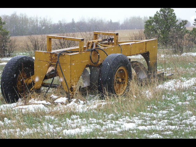

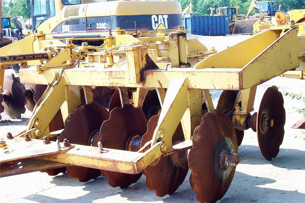

The root rake takes out the smaller ones. The u-blade digs out the large ones. Make a windrow of the stuff and let it rot. The root rake leaves the dirt behind. The heavy disk takes care of the rest. In fact for light bush the disk alone will work!!!!!!:eek:
Some place the trees are dozed off into windrows during the winter frost. In the spring the big disk will till it up. Breaking plough can also be used.

Actually a V-blade is more for busting out stumps and a KG-blade is perfect for it. A U-blade is made for moving dirt.
A Drum Chopper is also better for going over the debris than discs.

U-blade with tilt works for many things.:)
Does a drum chopper turn over the soil?:)
