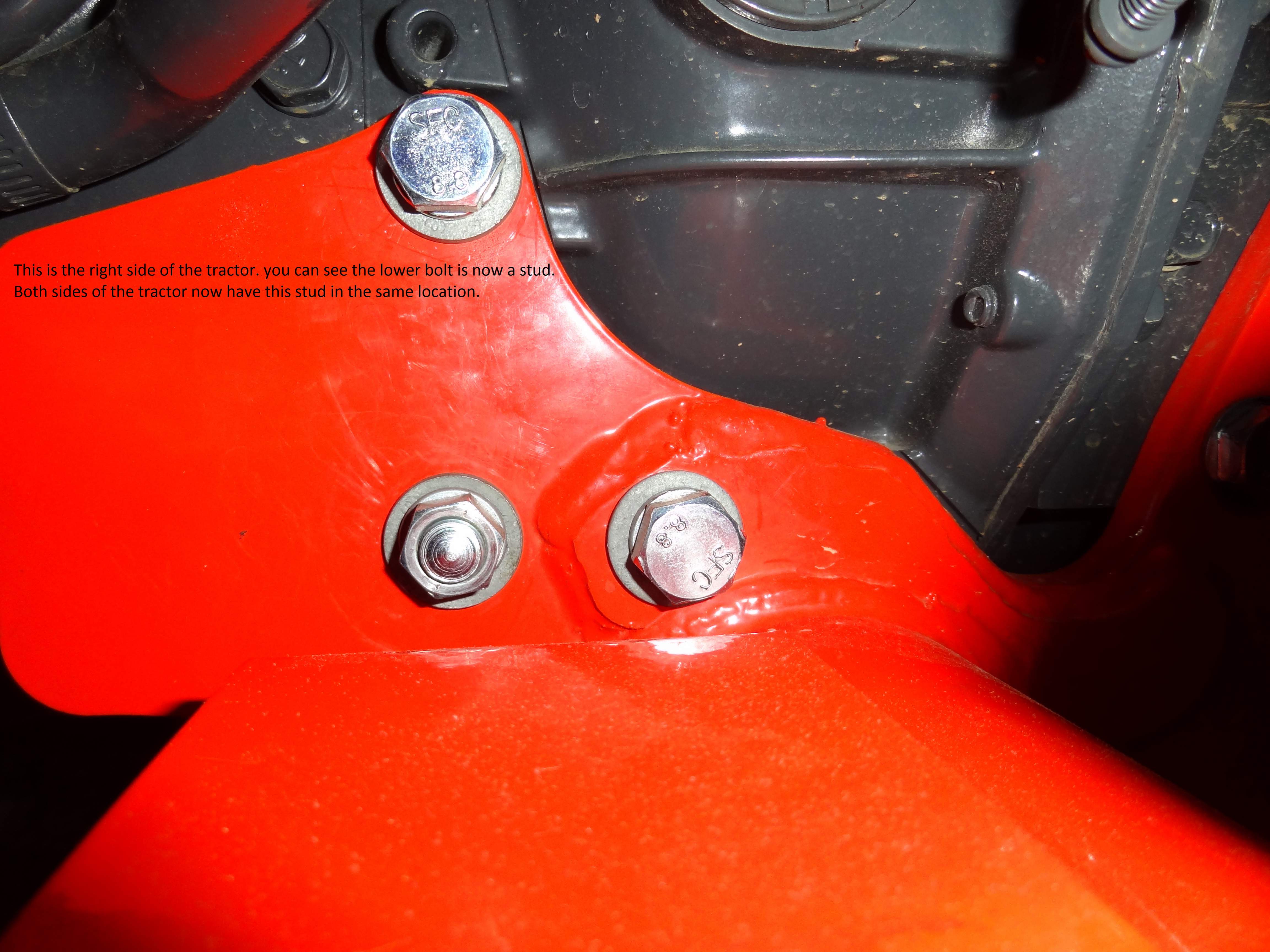

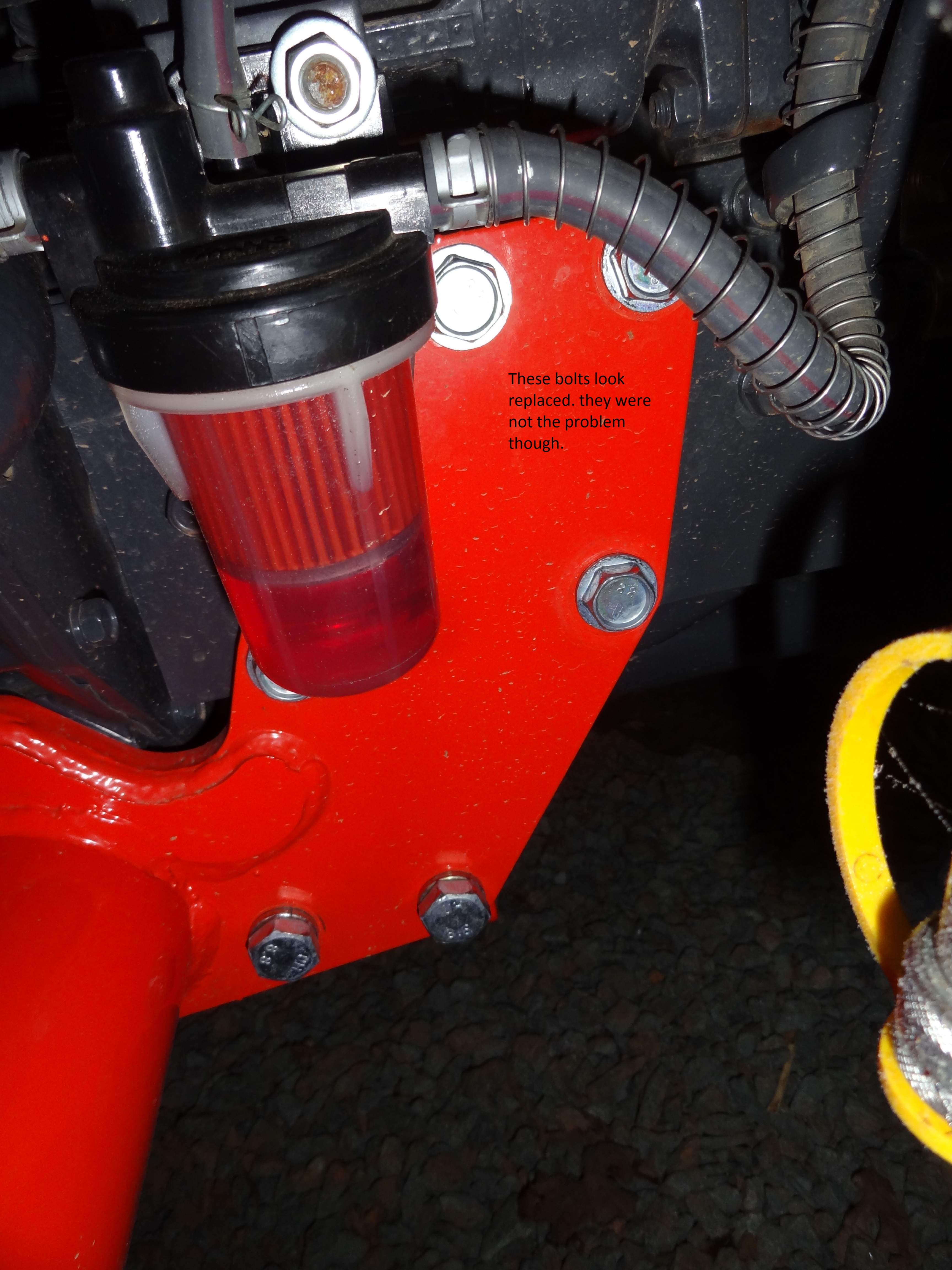

Well i will have to get some pics up tomorrow. my inlaws are still here and we just brought home some chickens. The bolts all look new and the two bolts that were stripped the worst were replaced with a threaded inserts with a large nut on the end. They said they used longer bolts in all the holes..

here are the pics,
There are explainations on both pics.
The stud maybe an issue if I ever needed to take the sub frame off. I do not plan on ever doing this. All bolts are replaced and loctited. I have yet to mount the loader to see if everything is level..
