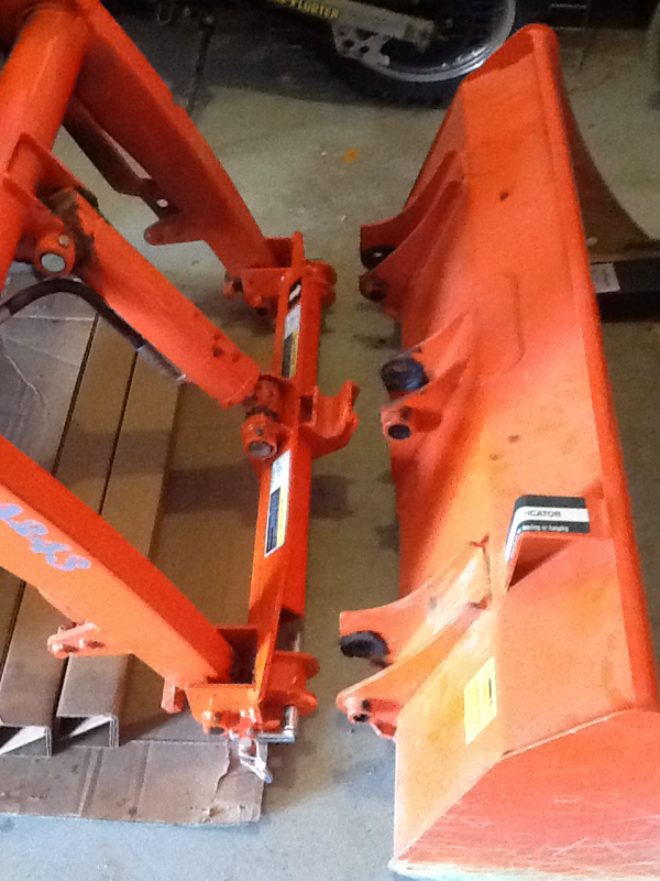

/ LA243 vs. LA243A and Quick Atach #7
Here are some pics from last year when I bought them. Yes, the 36" forks are solid.
/ LA243 vs. LA243A and Quick Atach #8
So is this quick attach merely an adapter that fits between the standard loader frame and bucket?
Look it up on Kubota. Its an adapter, but allows removal of the bucket to go to forks orva blade.
/ LA243 vs. LA243A and Quick Atach #10
Thanks. I guess I was looking for a pic of the adapter by itself not installed. I have a set of 3 point hitch forks (although tractorless right now) and was just curious.
