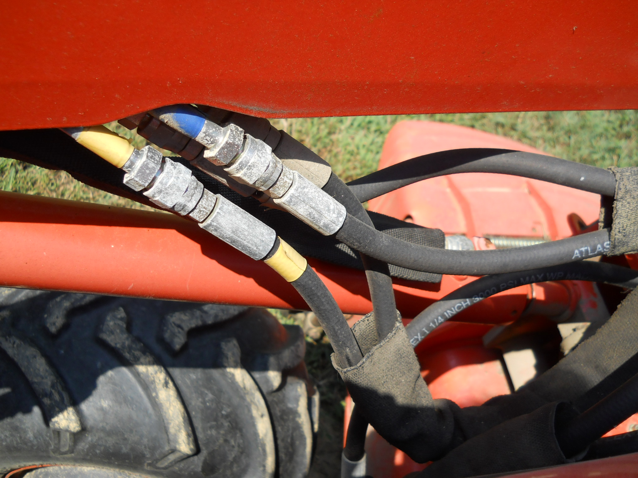

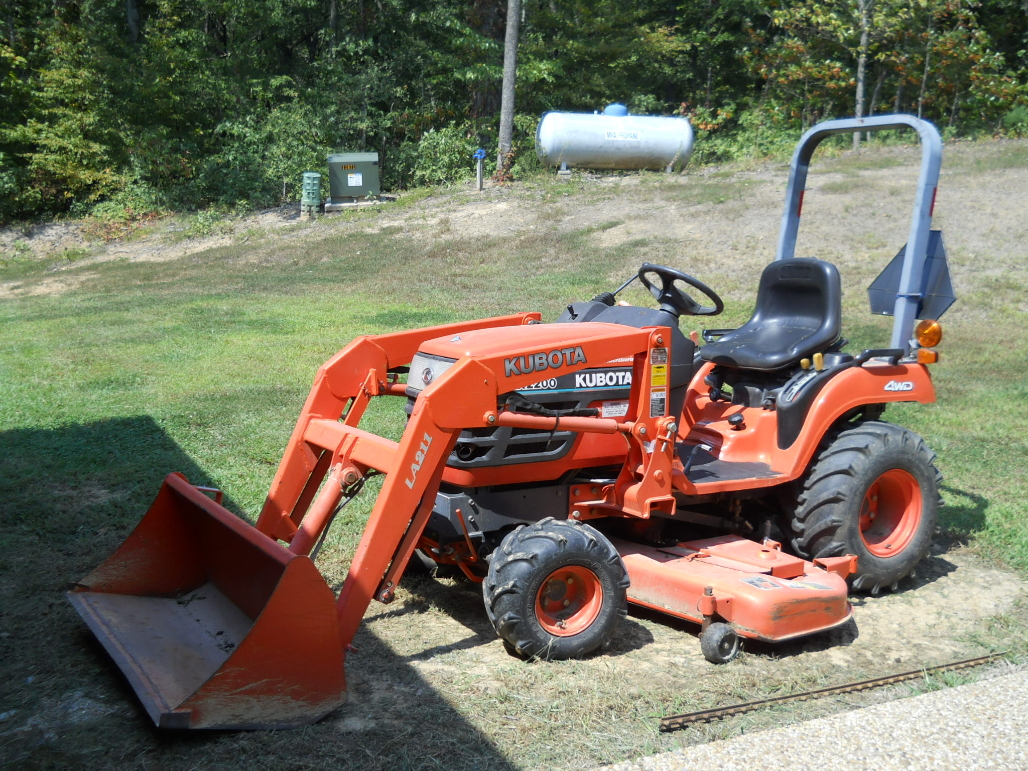

A couple of hydraulic lines blew out on my BX2200 last week, so I thought I would just replace them all while I was at. Good plan, until I forgot to take note of how the hoses were positioned and routed coming out of the valve manifold. It's a really tight fit. Unfortunately, the LA211 parts manual doesn't show the routing through the FEL frame and it's a little unclear about some of the hose ends. I did mark which hose connected to what line/coupler, but didn't take note of the routing in between.
Could someone please describe/post an image of how the 7 hoses are routed through the FEL frame to the 3 tractor quick-connects and also to the 4 steel hydraulic lines that are under the top frame bar of the FEL?
My feeble attempts at putting this back together aren't working and I don't want to force any hoses or put them back in rubbing/chafing on each other/the FEL frame, or the tractor).I started describing how I recall the setup was before I demolished it, but it got very long and too confusing - a picture would be worth at least a thousand words here!

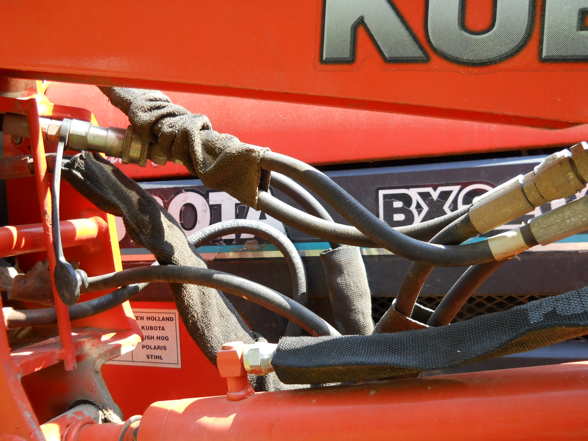

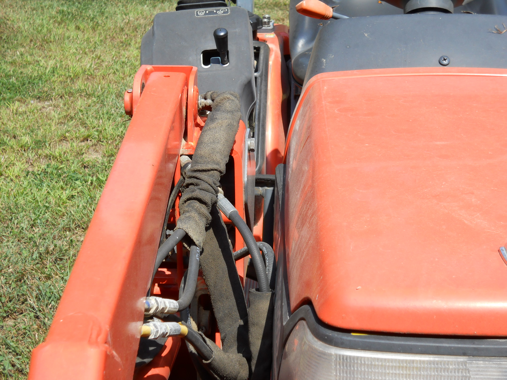

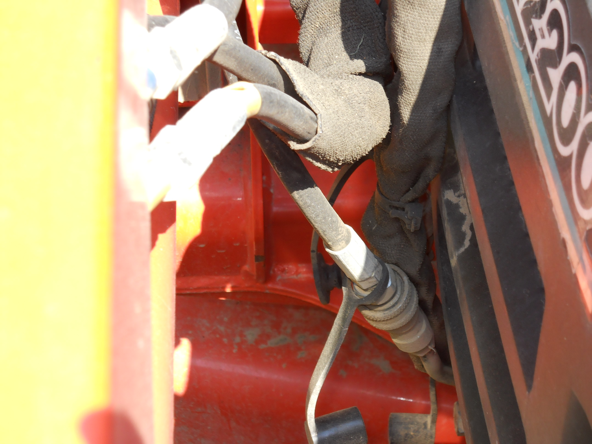

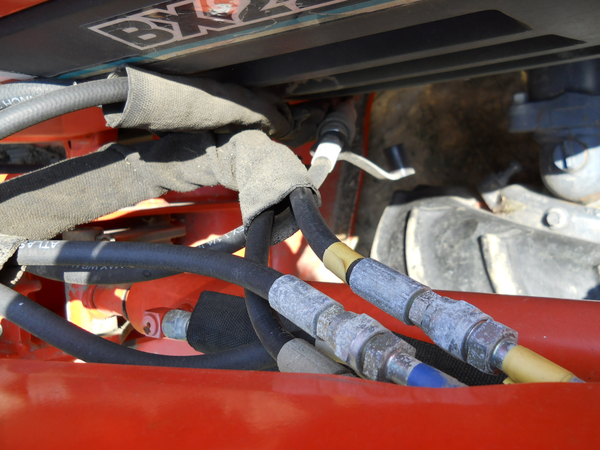

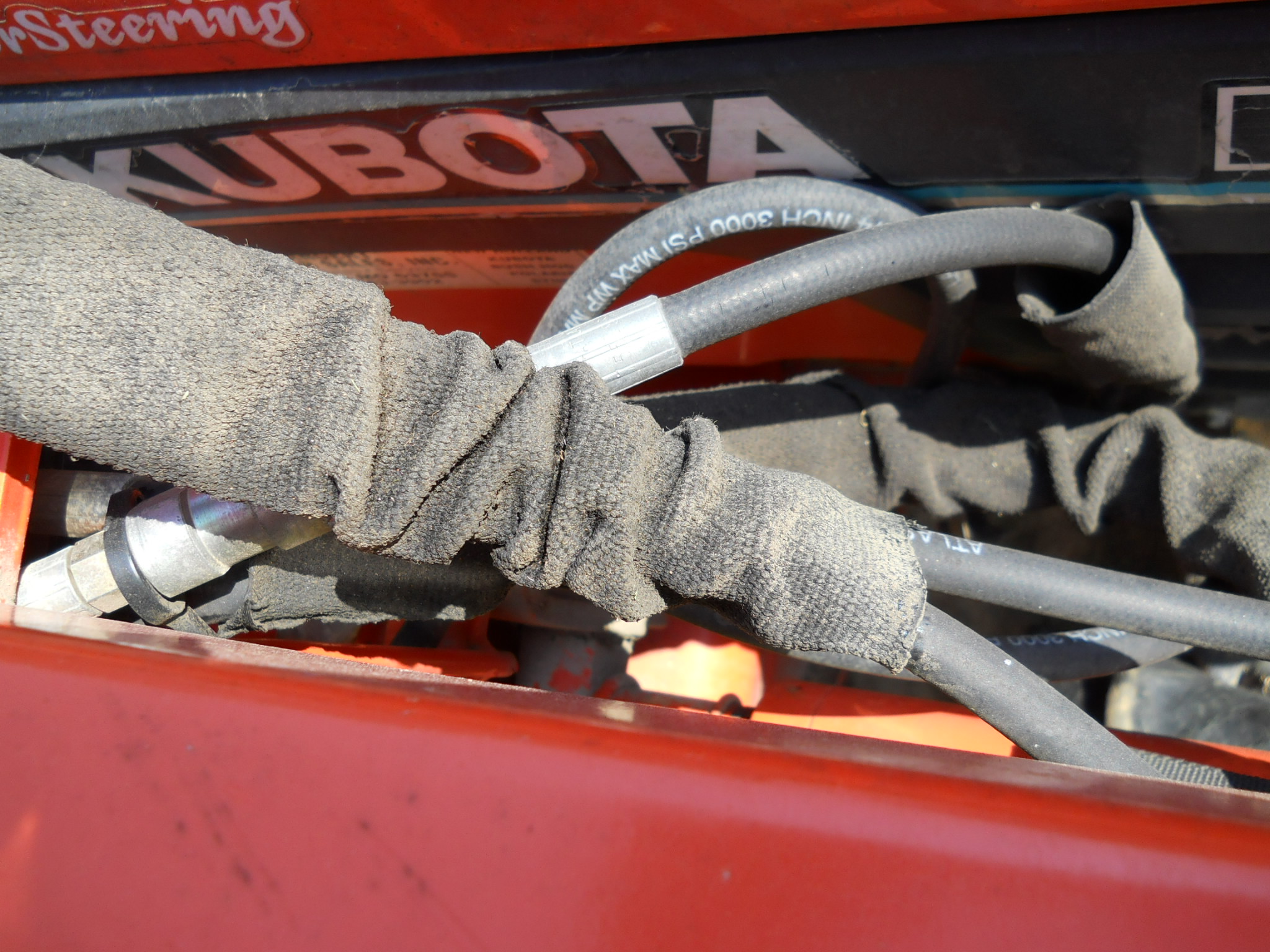

Don't know if this will help:

I believe it has with one item. It showed me that the blue and red tape lines got to the bucket.
I don't seem to have yellow tape on on my other two lines. I am assuming they are the arms for the loader.
It seems from comparing you pics to my lines that things work on the valve with out and return flow. Top to lines are out and bottom two are "return". Yes/no?
But, these pics have push me further and I thank you.
Doug

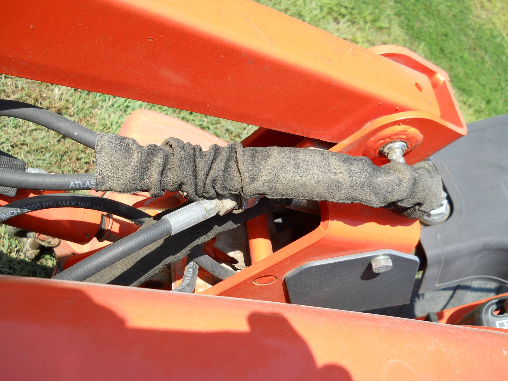

Wish I could help more, but I can't get to that tractor right now. If you can't figure it out, I'll try to get some more pictures, loader is off right now.
