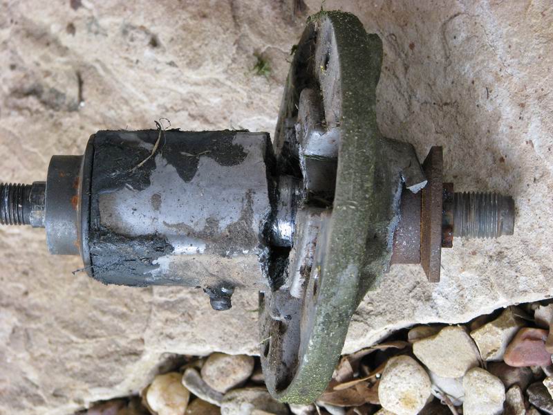

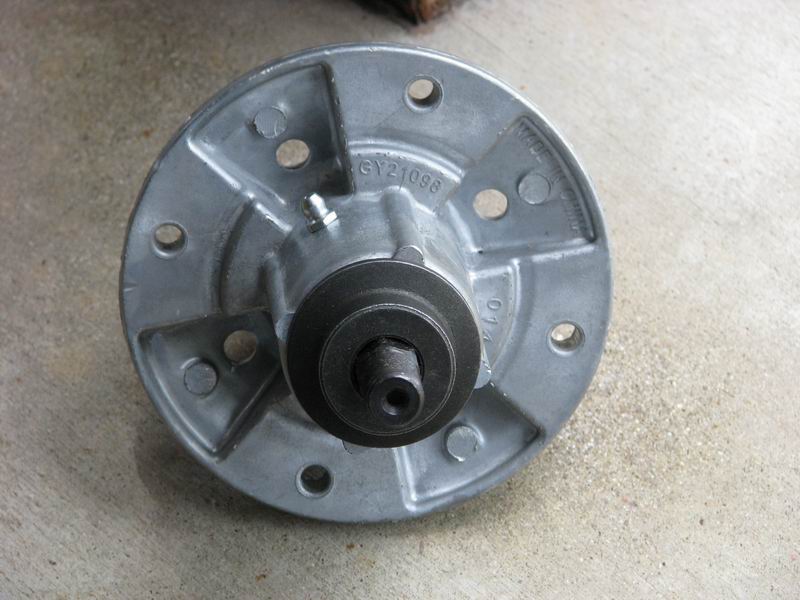

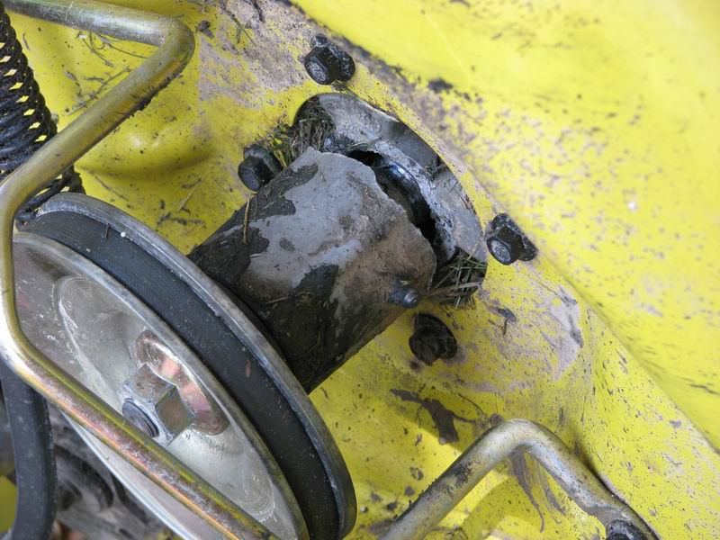

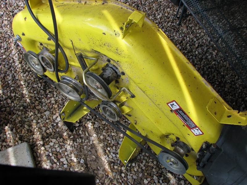

In general, I really like the design of my LA145 mower because it seems to perform well for a grass-cutting-only lawnmower. The problem I've had with the engine's carburetor and sticking float valve are more related to ethanol in the fuel than a problem with the B&S engine which performs flawlessly otherwise. However I have spent over $200 in repair parts on my mower deck in the first 90 hours of use. I think 10% of the purchase price is a little high maintenance on the costs.
I've now replaced all the idler pulleys (two small and one large) one time and just had to replace the center spindle because it blew up the last time I mowed. I grease my deck religiously as can be seen by grease on the outside of the spindle assembly. I also have never hit any big rocks with this mower. I'd say nothing bigger than a golf ball. It's life has just been spent mowing my 1/2 acre yard around my house.
The good news is that the spindle was only $60 complete and the small idlers are about $9 each with the larger one being $12. I'd gladly pay more for better idlers if I knew where to find them, but replacing these at least once per year won't break the bank. The deck is very easy to remove and replacement of parts is a snap, even if I think the parts are failing too early. Here are some pictures of my deck and spindle and the new replacement. I've got my fingers crossed as to how long the deck will go before something else craters. I'll soon order a replacement spindle and idlers to keep on hand for the next repair.

Jinman, those spindled are a lot different than the ones on my 44" mower deck. Looks like pot-metal, not good. My theory is that you may not be greasing them enough or they are a poor design and quality. When you grease them, how much do you put in and how often? My deck zerts are on the top of the spindles (where the nut is on yours) and I always shoot 8 or 9 punps from the grease gun three or 4 times a year. Make sure it comes out of the seals when greasing. I mow a lot toughter terrian with mine and hit a lot of large rocks and sticks and the spindles have lasted 10 years without failing. Ray

Ray, I have a battery powered greasegun. The zerks are on top of my deck and I grease them every 8 to 10 hours of operation until the grease oozes out the bottom of the deck at the blade or the top at the pulley. This deck has NOT suffered from undergreasing. Today, while we were mowing, my wife was in 5" Saint Augustine grass and heard a thunk. The deck immediately quit working. The strap that holds the electric PTO clutch had broken off and the clutch spun and jerked the wires loose. I know the broken pulley put some extra stress on that PTO clutch, but it never stopped spinning the other day when the spindle cratered. It just rattled and I shut off the PTO. I ordered the strap today. It's a whole $1.62 and the plastic grommet inside the clutch where it fits is $4.64. While I was at it, I ordered a whole new set of idlers and a new spindle. Total parts order before shipping is about $88. The mower is nickle-diming me to death.:rolleyes:
Have a look at the front of my deck in the photos above. Not only do we not mow in rocks, we hardly have the paint worn off this deck. We go out of our way to not abuse our equipment and I try to maintain it at a high level. I am on my third set of new blades. I sharpen them once and then they are worn out by the time they have been sharpended twice. This deck and its components are designed to wear out quickly. This is a terrific little mower, but the deck is wearing me out.:thumbdown:

Jim, you are using WAY too much grease on the spindles. This is causing them to run hot, expand and cause most of your problems. Of course the fact that they are a cheap aluminum casting made in China does not help. Sometimes less is better, give that battery powered grease gun some time off.

Well fellows, I'm going to have to disagree with you about the grease. This spindle has no seal and the bearing freely allows grease to flow through. I've looked at the illustrated parts breakdown for the spindle. The dangers of not insuring grease is in the bearings is far greater than any damage that might be done by too much grease in my opinion. I believe this part failed on my mower due to its aluminum casting having been weak or perhaps cracked when it was installed. I don't think I'll have anymore problems since I've replaced it. However, there is no maintenance on the idler pulleys and their sealed bearings. No amount of greasing of the spindles can account for three idlers failing in less than 90 hours.

Good luck jinman, the problem I see from the pictures is the design of the spindles and the construction material. From the point of where they bolt to the mower deck to the belt pulley is too long for the strength of the allum or pot metal (whichever). The belt then provides more torque that the design can withstand. So the end result is a weak 48" mower deck and not up to JD standards. The least JD should do is re-design the spindles and do a recall. I bet every owner of that deck is having the same problems.
The only other possible explanation is if when you install the spindle to the deck then install the blade to the spindle it some how binds up the bearings and causes them to be so tight that the heat/friction destroys the bearings. Again that would be a bad design. Ray

Ray, the spacers at each end of the shaft have a shoulder that bottoms out so you cannot overtighten the spindles. When I put the new spindle on the other day, I tightened it down and could feel the spacer seat. The blade spun easily and freely before I put on the belt.

I work on JD's all the time, and I've never seen a broken spindle housing like that. I'd call it a fluke. JD has built hundreds of thousands of those tractors, with 2 or 3 spindles on each - that's a lot of spindles. If there was a design problem, it would be all over the internet.

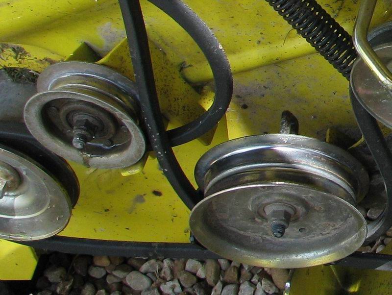

Well, it happened again. I lost a small idler while my wife was mulching leaves in the yard. We don't have heavy leaves because we stay on top of them and my wife just started in an area where the Saint Augustine grass has mostly stopped growing, but is very thick. After about 10 minutes, she smelled smoke and shut down the mower. I was nearby with my backhoe and she walked over to tell me the mower had a problem. I went back to the mower with her and had her start it up and engage the PTO as I watched. Sure enough one of he small idlers was frozen and the belt heated up as its back side slipped across the face of the idler.
I keep plenty of spare parts now that I expect problems. I keep two small idlers and one larg idler plus a deck spindle in my John Deere parts bin. The two new small idlers looked very different in construction. One seemed rougher where the two halves are riveted together with a black faced bearing and the other was more smoothly finished with a yellow faced bearing. I'm sure they are from different vendors, but the yellow-bearing model had "Made in USA" clearly on the label, so it was the one I chose to go on the deck as a replacement for the frozen idler.
I took the opportunity to grease the deck and the mower while I had it off and I removed the blades and sharpened them so they would do a better job of mulching leaves. The repair and service took about 1 hour's time and then it was time to start it up and test it. When the PTO was engaged, the deck sounded very solid and smooth. My wife gave me a thumbs up and went off to mulch leaves. Everything worked great, but this is again a higher level of maintenance than I would expect.
Maybe I expect too much. Our hour meter is now approaching 100 hours. I have replaced one deck spindle, three small idlers, and one large idler in that 100 hours. We are not rough on our equipment. We use it almost exclusively in our lawngrass yard, but I know we have very abrasive sand because the tips of the blades erode really quickly. The underside of the deck was as clean as if it were sandblasted. The combination of mulching leaves and the dust/sand picked up by the blades has removed all grass residue.:thumbsup:

The sand may be part of it, but I've worn right through a few blades without any problems. I'd be curious to see if you can find out what caused the failure. If it were me, I'd open up the failed parts and have a look see. Maybe there's an answer....... and maybe not. Where I live, we have good access to bearing suppliers. I've replaced a few failed ones with Fafnir (a division of the Timken Company) and never had a follow-up problem.
Unfortunately, the only way to replace this bearing is to grind off the rivets on each half of the idler pulley because the bearing is captive. It's placed between the two halves and then the pulley is riveted together. I'll try to get a picture to show. The bearing is just worn out and turns really rough. When it gets hot, it seizes. My wife said she heard it singing for about 10 seconds before she smelled smoke, so it went downhill pretty fast. I'm pretty sure I could drill out the rivets and replace them with #10 machine screws/nuts and then grind down the screws flush with the nuts, so I might buy a quality bearing and give it a try.
I found a photo of the idlers on a previous picture. You can see how the idlers are made from two separate halves and riveted together so the bearing is captive. The small idler in the photo is the one I replaced and the big one on the right was replaced when I replaced a deck spindle. It was still working, but I could feel the bearing getting rough.
