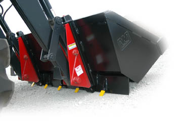

Back dragging with the front blade and a dumped bucket is very hard on your cylinders. In this position the Rams of the cylinders are completly extended; when you put down pressure on the cylinders you are risking damage. If you do frequent dirt work, this is an option we offer for our buckets and as an aftermarket add-on. The Back Drag Blade will allow you to keep the rams inside the cylinder (fully rolled back) for protection while back dragging. It will not bend or stress the rams of your bucket cylinders. For less than what it will cost you to repair or replace a cylinder, you can modify your current bucket to work better for this application. The Blade is available with or without scarifying teeth.

What does something like this cost? Where can I look more into this product?

If you're going forward or backward with the bucket in the rolled under (rams exposed) position you can damage the rams and or cylinders. If you go slow and are careful you minimize the chances, but it is still there. What N80 says is true, just make sure you have the loader in float. With the cylinders are fully entended they are still vunerable to damage. Consider for example, you have a 2-1/2" cylinder but the ram inside may only be a 1 3/8". The structure, stability and strength of the cylinder is reduced by half when the bucket is tipped under and rams exposed. By having a blade on the the back of the bucket or just using the back bottom edge of the bucket to drag, you are keeping the rams inside the cylinders, protected while retaining the integrity and strength of the cylinders.
In reply to the question - bolt-on or weld-on, the blade is a weld-on item. It does not interfere with normal bucket use. Anytime you drill holes to bolt something on - it weakens the steel; plus it could cause the bucket to leak.
