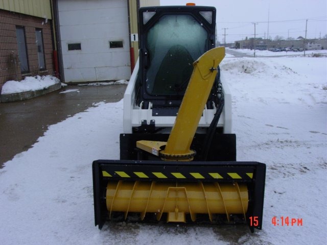

Smaller hydraulic drive systems are starved for fluid flow when attachments like high flow hydraulic drive snow blowers are added. The power most of these snow blowers require is with an independent high flow oil volume of 25-30 gallons per minute that will not be needed to provide oil to the wheel motors of a skid loader in the example.
Anything you add to the loader frame is going to stress it so keep that in mind, NO, bigger is not better and farm and utility tractor frames are not built heavy enough to deal with heavy compacted materials like deep frozen snow banks.
You could invest in a Reist series 1000 single stage snow thrower for the three point hitch changing the work order to make it a 6 foot single stage unit with added wings to make it 8 foot wide for much less money than a 2 stage unit of the same size or larger for less money.
You also need to keep in mind that the front mounted snow blower reduces your ground clearance and when 4 wheel drive mules get stuck they really get stuck and if your lucky you can use the loader to push yourself out but quite often you will have to drive forward and dig out and around so you can back back up the hill as driving forward will almost guarantee a roll over and more problems
Since you are all new to this and have yet to find that plowing snow is extremely boring and becomes a real chore
I will advise you to avoid a 2 stage unit as a single stage unit requires 20 percent less power and can throw the snow just as far or farther.
The single stage Reist units are less complicated to own and operate as they only have the snow blower rotor to spin and discharge the snow up the chute and out.
The two stage units are a bit more complicated as they have the impeller and the open cross auger to contend with.
Teh two stage front mounts require a lot of work to install them and they need a reversing mechanism to correctly operate the snow blower.
The open cross augers can and will become plugged with heavy wet melting snow and it will affect the 2 stage snow casters ability to clear deep snow pack.
This happens because the cross augers will push the snow forward rather than consume it and force it into the impeller housing.
Keep in mind that if you break a shear pin on the impeller or cross auger you have to dig the snow out to find where the shear pin broke and then take the time to replace it.
With the single stage Reist snow thrower the only thing you have to worry about is the roller chain that spins the snow blower rotor at 700 RPM and if the chain breaks all you have to do is install a new connector link.
The roller chain on the Riest Snow throwers is accessed by opening the access door on the left side of the snow blower and it is tensioned by a rubber mounted spring tensioner gear.
You will need to include hydraulic rotation and spout control to the sales order as you do not have an open station mule.
Many of the members that use rear mount snow blower owners sit side saddle on the seat and use the reverser pedal and just watch as they back up, many of the members use back up cameras to watch as they back up. many of the members use back up cameras and mirrors as well when they clear snow with snow blowers.
The rear mounted snow blower is riding on the pavement and acts as an anchor when stopped but you should always set your parking brake anyway.
Reist Industries has a dealer in or near Albany, New York I just have to find the dealer name again and post it for you.
Your new at this and I am not trying to spend your money I want you to have a simple to own and operate snow blower that will not plug as much if at all and also be able to use and repair if you have a breakdown from a broken drive chain.
A two stage unit will push snow forward while it is clearing snow.
A single stage unit will consume all the loose snow and packed snow it encounters without pushing it forward and the only snow that is left is what passes over the snow blowers cross auger housing if it is deep snow and it will not leave piles of snow that have to be picked up a second time.
The image of the snow blower mounted on the skid steer loader is a 48 inch single stage unit with a 20 inch snow blower rotor; you can order them with a wider width with a simple change order when you pay for the snow blower.
One of series 1000 snow blower rotors will not bog down on you as much as the PTO on you rmule will have no issues with providing the torque need through the gearbox to the chain drive of the snow blower rotor.
The series 2000 single stage unit pictured is is a front mount series 2000 unit that requires more horsepower than you have to run properly with the high torque needed to spin that size snow blower rotor.
My brother has a grand L and the tires are not loaded nor does he have snow chains and he gets it stuck
I would suggest that you talk to your neighbors and ask what they have on their tractors to clear snow before you make any sort of decision and I will suggest that you use a decision tree to make your final decisions.
Your new at this and your going to need to learn lot in a hurry but for light snow falls a manually adjusted plow blade on your loader bucket will be the best way to handle light snow falls and you can use a rear mount snow thrower like the reist series 1000 to clear the banks back as needed.
