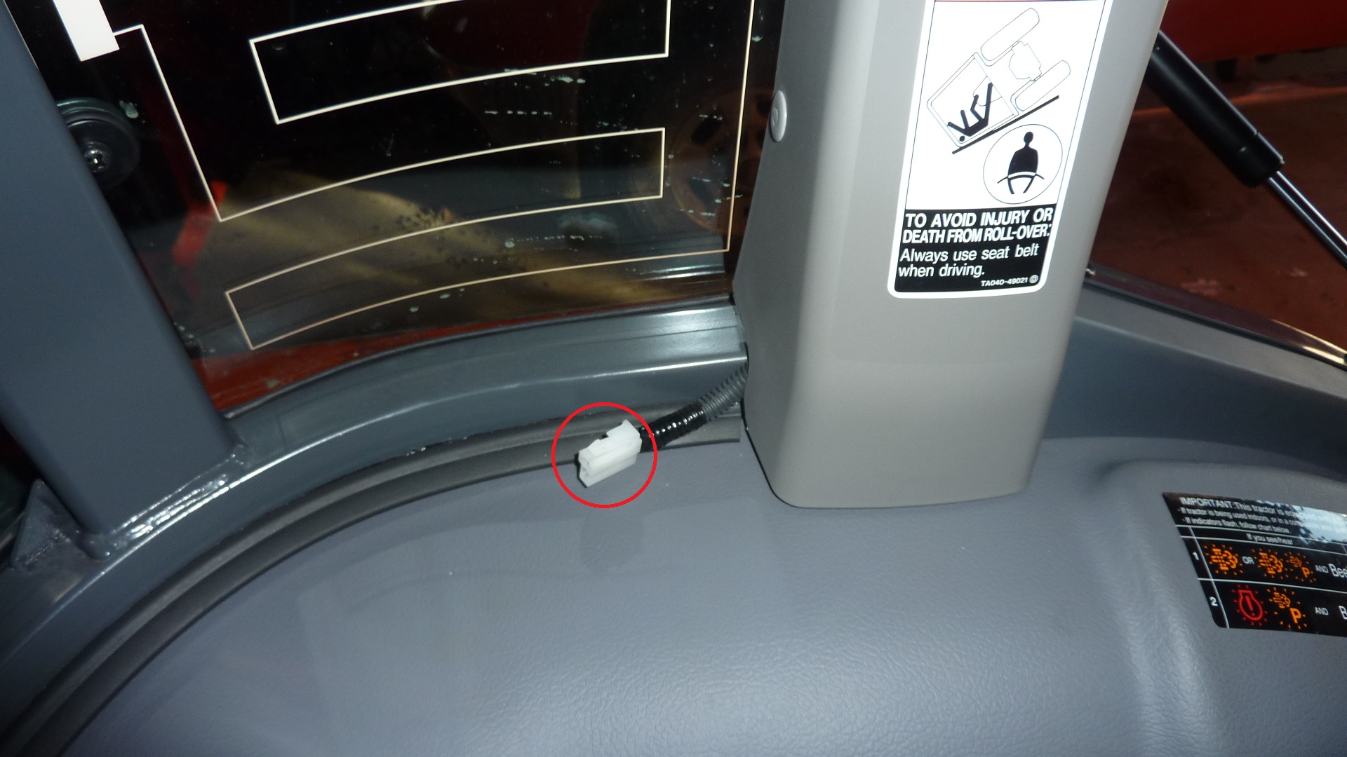

Anyone switch out the dome light for LED? Kubota part #3C581-54220? I have been unsuccessful in crossing an LED replacement and unusure of how big a job to switch it out.
/ L6060 Cab Questions
#86
I have the same question. The Kubota OEM dome light is pitiful and hardly throws enough to read by.
The 3 position dome light switch is also a mystery. I assume one position is "off", another is "on" but what does the third position do? I would think it would be a setting that would turn on the light when the door is opened like in a car. In my case, nothing happens. I looked for a door switch but can't find one on either cab door.
Anyone have ideas on either the bulb or switch?
/ L6060 Cab Questions #87
I had grand l in the late nineties and their used to be a pressure switch in the door frame that would run up to that third position and open the door the light would come on just like in your car and for the bulb I replaced mine with an led and I took out the bulb and went down to advance auto parts store and matches up the bulb with an led that would fit in my my yanmar 359c and big improvement in light inside the cab.
