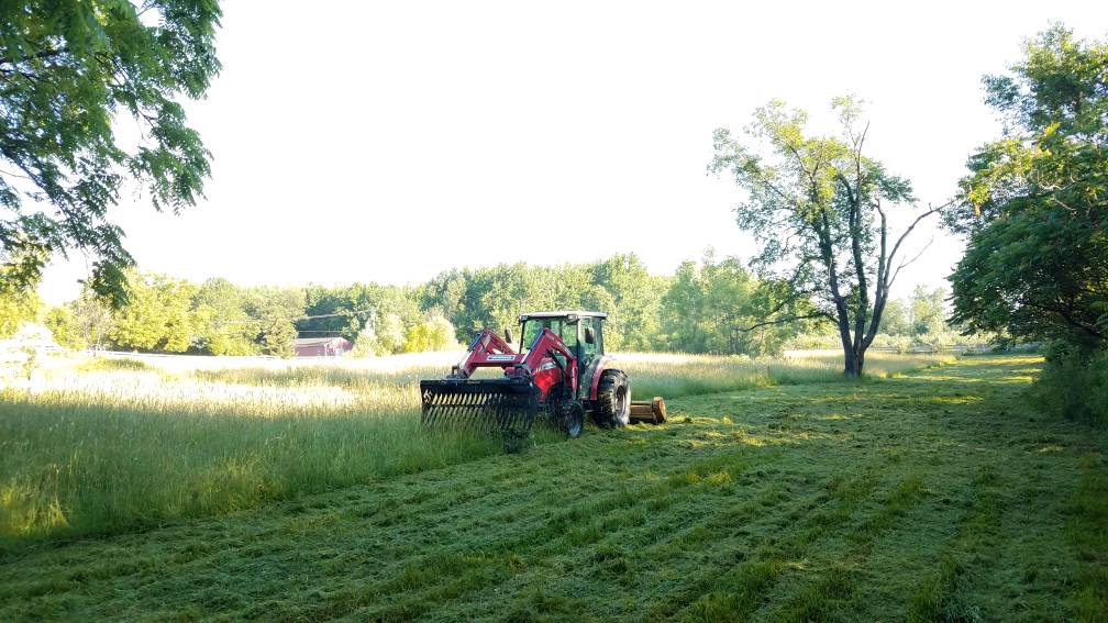

Good Morning,
Looking at some purchase options and wondering if this is a viable set-up:
L5740 4WD hst w/FEL using a 1600 lb twin spindle 8 ft pull type rotary cutter.
Terrain is 40 acres, clean/cleared pasture (1-2 ft) grass, rolling hills, nothing too steep.
Will the 5740 handle this, at a reasonable pace, without overly taxing tractor?
Asking because 5740 purchase just presented itself (used).
Other option involves m6800HD same cutter.
L5740 has BH 92, so purchase would be a swap for JD 110, while 6800 would be additional tractor, no swap.
Currently using JD 110 and 6ft pull behind (900 lb single), need to speed it up! HA
Thanks for any input.

Depends upon what you plan to cut and how quickly.
I use a Woods BB720X, 6' mounted cutter with my L6060 (replacement for the 5740) and it's all it wants in the heavy stuff.
Yes you can pull an 8' pull type cutter but you will not pull it very fast if the grass is heavy.

I run an 8' (7' working width) 1,700lbs flail behind my L4060.
A lot of it will come down to how fast do you want to go & how dense is the material. I'm a fan of wide & slow. Leff bouncing around for me & the machine going slow. Wide means I'm mowing the same acres per hour despite going slow.

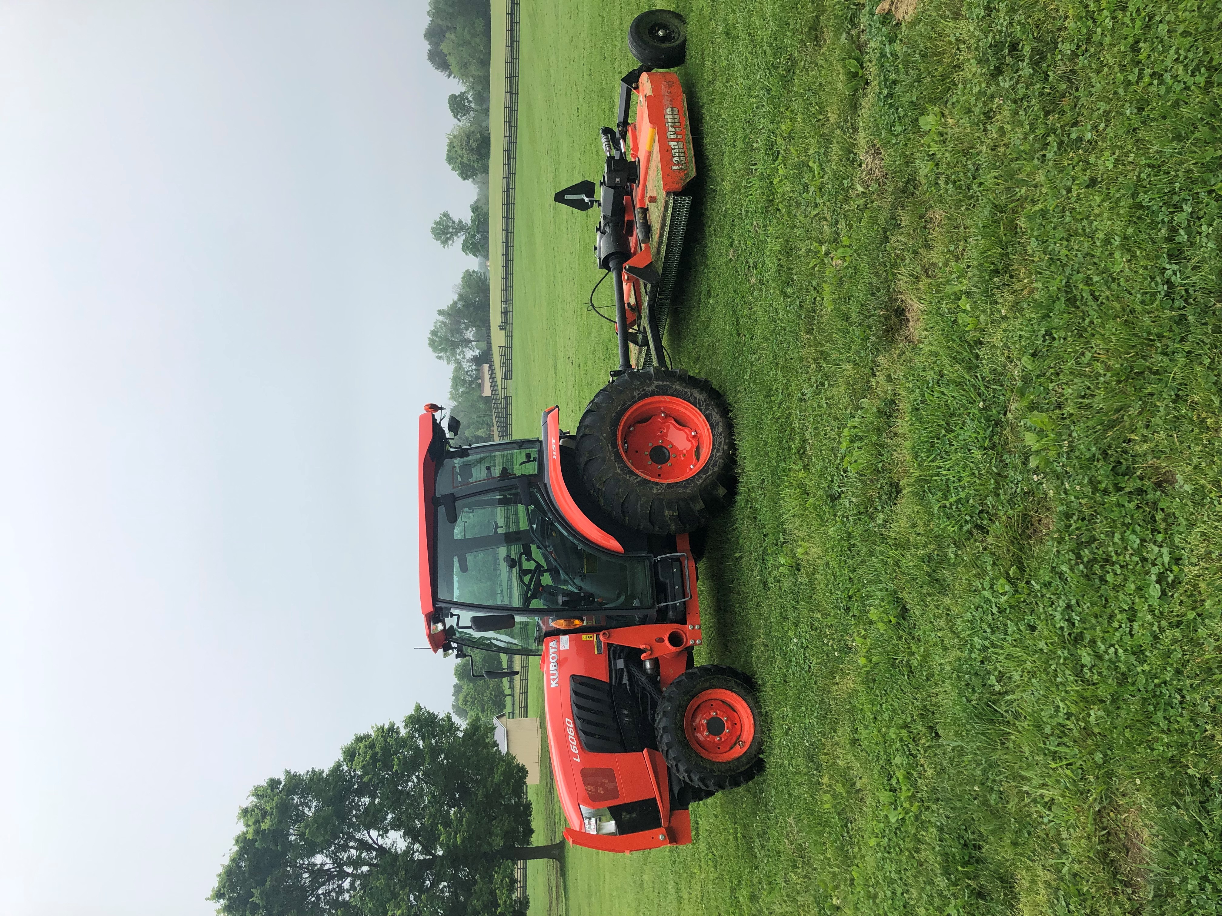

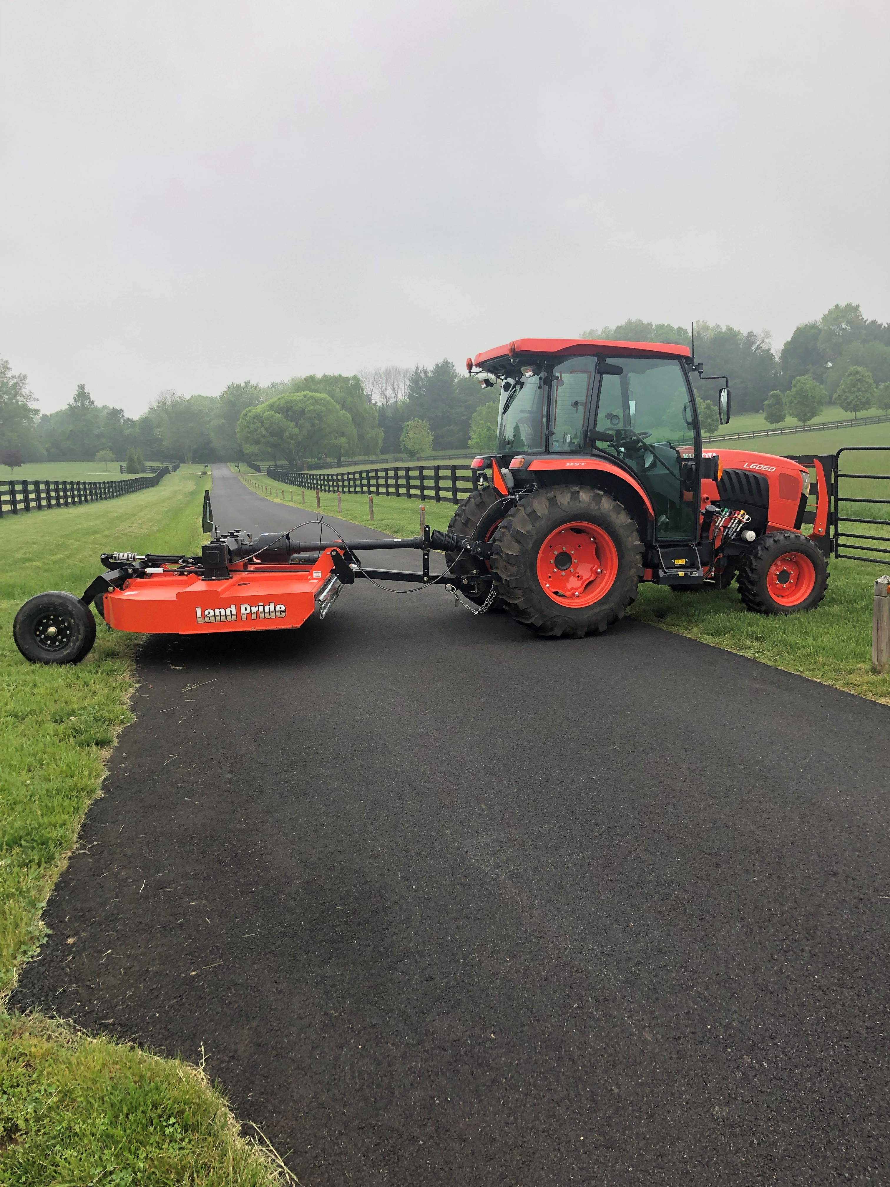

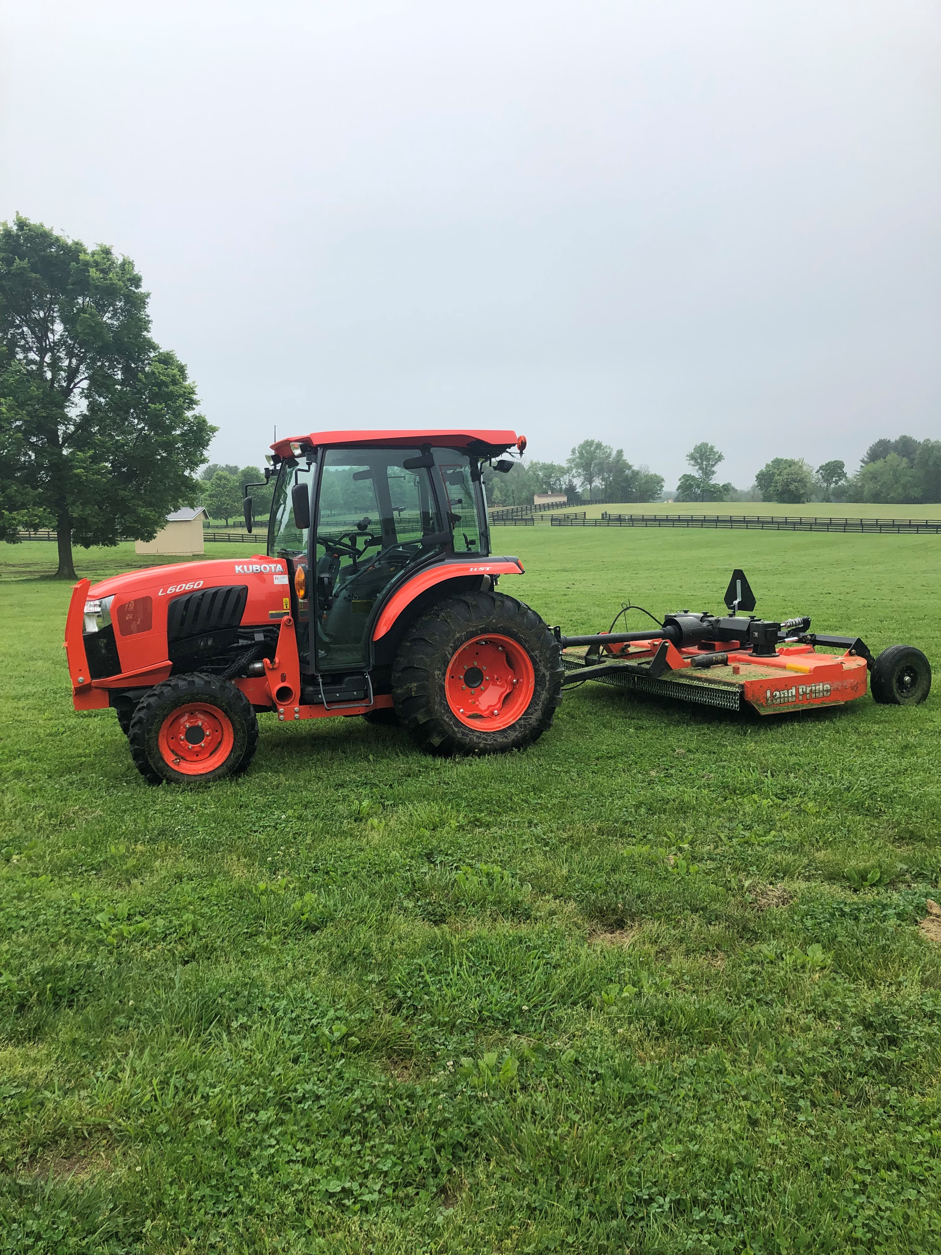

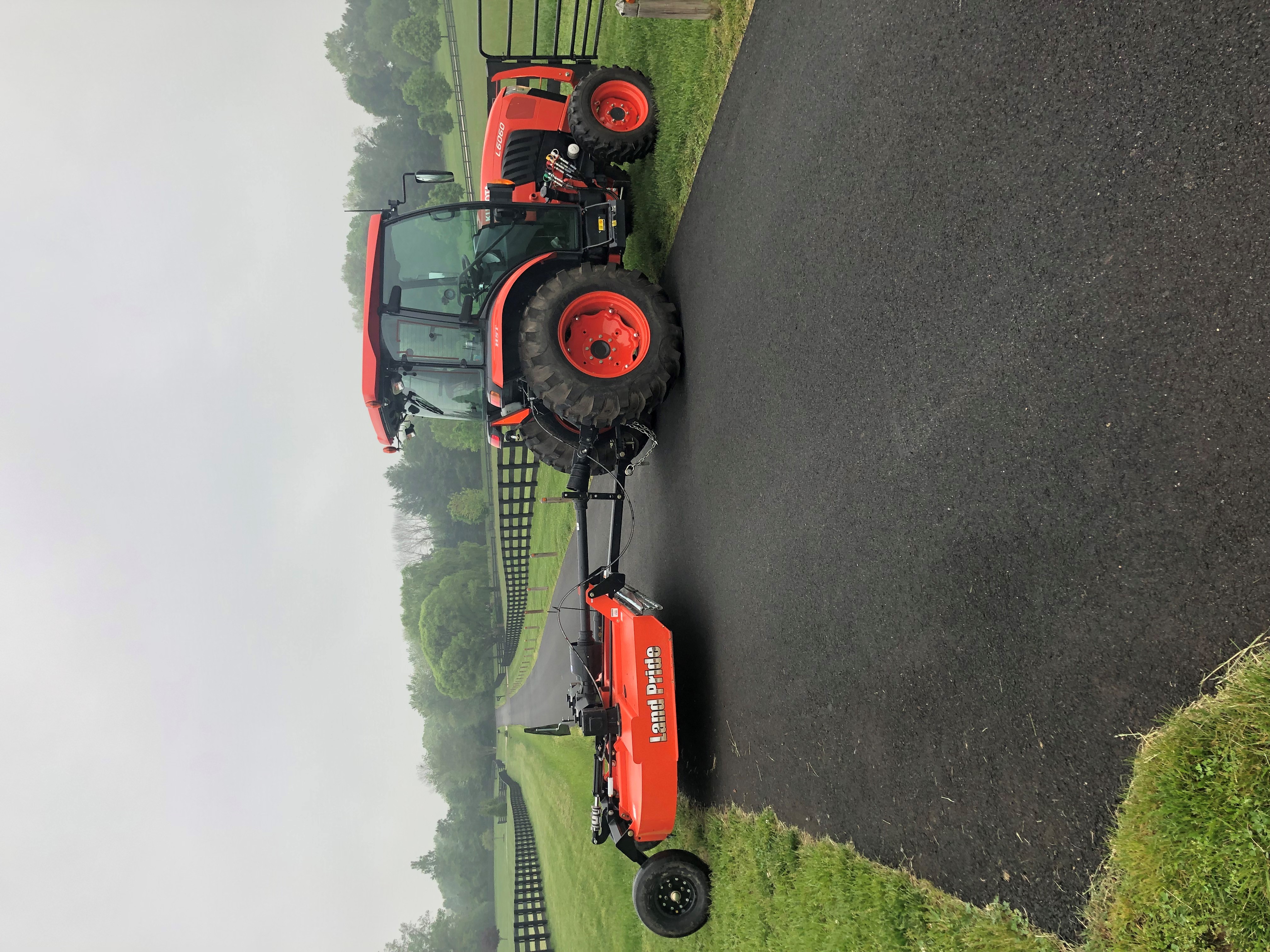

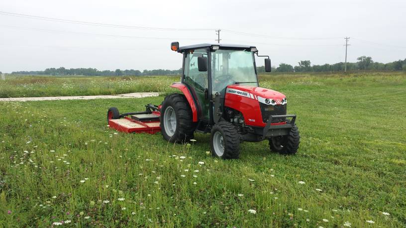

We have a L6060 and a Land Pride RCR2596 setup in pull style. First and most important thing is that this mower doesn't have a CV PTO line... and that was the largest mistake. Turning is a pain, due to the universal joints, I can only turn from center MAYBE 25 degrees before the driveline starts binding. I end up having to do a lot of 3 point turns. MAKE SURE TO GET SOMETHING WITH CV JOINTS.
As far as being a good match for the tractor, I have NO issue cutting with it. I can sometimes bog the tractor down in the wet, tall, thick bamboo style grass, but I do cut very short, and if I raise the mower so it can clear the cut material, I have no issues. I more relate this issue to a flawed design in the mower deck baffling/shape. Actually... I shredded the slip clutch in the PTO driveline without even knowing it happened, so I know the tractor has more than enough power.
NOW I am in the market to sell that mower and upgrade to a woods BW12 batwing mower. Due to having 12ft vs 8ft of mowing path as well as the CV driveline, it should cut mowing times by half.

50 PTO hp
"Here is what we know about the Kubota L5740 Tractor. It has a 4 cylinder Kubota Diesel Engine that produces 57 horsepower and is a four wheel drive model that weighs up to 4233 pounds with a cab. View Kubota L5740 specs below. The L5740 tractor has a category 1 and 2 three point hitch and a pto rated with 50 hp."
Tractor sales people usually recommend five (5) PTO Horsepower for each foot of rotary cutter, Flail Mower or finish mower. The 5740 is listed as having 50 PTO Horsepower. You advise you want to runs a eight (8) foot rotary cutter. 5X8 = 40. So you would have a cushion of 10 horsepower.
You will probably need to keep the FEL installed and may also want to scoop up a scoop of dirt or rocks to insure good front end ballast if the 8 foot rotary is one that you can pick up with the three point.
View attachment 641798View attachment 641799

Thanks one and all for the food for thought. I'll try to answer some questions. I cut all 40acres. Currently cut about every 5 weeks, would like to get it down to every 3 weeks depending on weather. Vegetation is mainly just pasture grass with a bit of dogbane. I have gotten rid of most of the gnarly stalky weeds and all of the Russian Olive. Clean pastures to date, not that rocks won't grow from somewhere. I take a pretty easy pace, I really enjoy it. My JD 110 PTO is just at the cusp for the 6ft pull behind. I would like to save a bit of time and not tax whatever tractor I end up with. I do like the 110. No complaints other than pto horsepower for mowing. My current backhoe use is down to 2 or 3 times a year. It is just nice to have when needed. I have considered purchasing a tractor just for cutting (m6800), but this L5740 just presented itself, I thought I should investigate and I thought I may save myself from maintaining a third tractor. As for baling, not yet, still improving the fields. Would like to though! I get the impression a twin spindle, 1600 lb, pull type is not too much for the tractor to handle or not to put me in any more harm's way. The CV suggestion is a great, I would have not thought of that. I run into the binding every now and then with my current set up.
Thanks again for all the input, it is truly appreciated.
