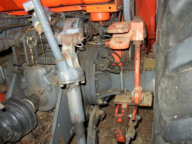

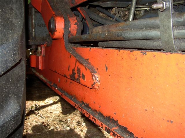

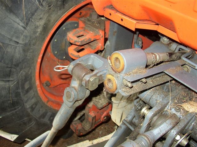

/ L5450 Backhoe #4
Hi Larry - the subframe is just like mine. It installs in place of the rear parts of the loader frame. It has members that come up over the rear axle to the upper wedged pin locations. It is clear from the pictures that whoever put it all on the pallet kept track of the pieces so it would be complete. I can see the wedges are there and the upper adjuster rods, etc. There's some surface rust on the pieces but they'd clean up fine.
Edit - Here are pics of my rig. The subframe is very rugged and engineered to fit the tractor close. Dick B

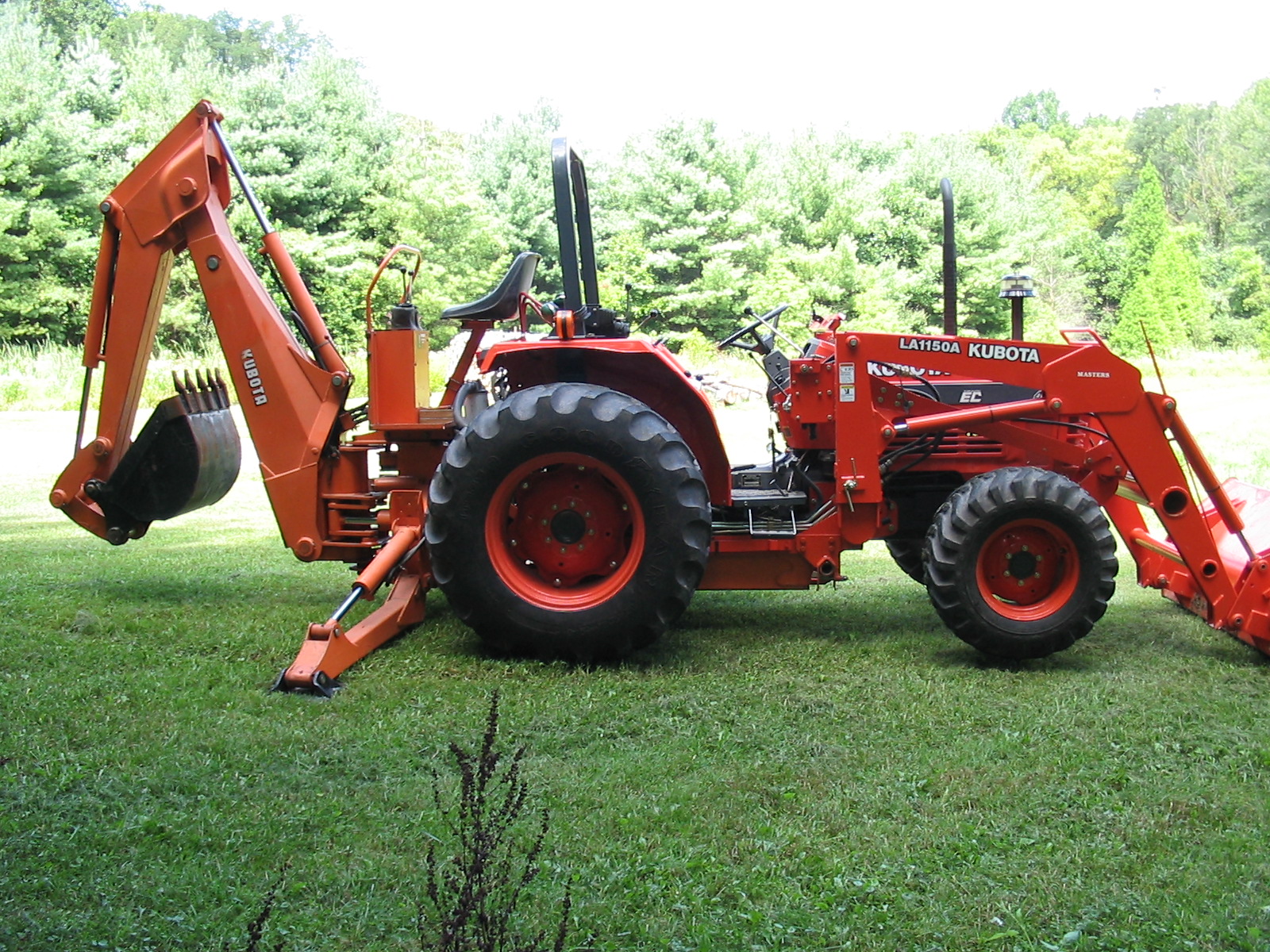

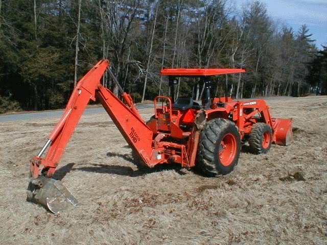

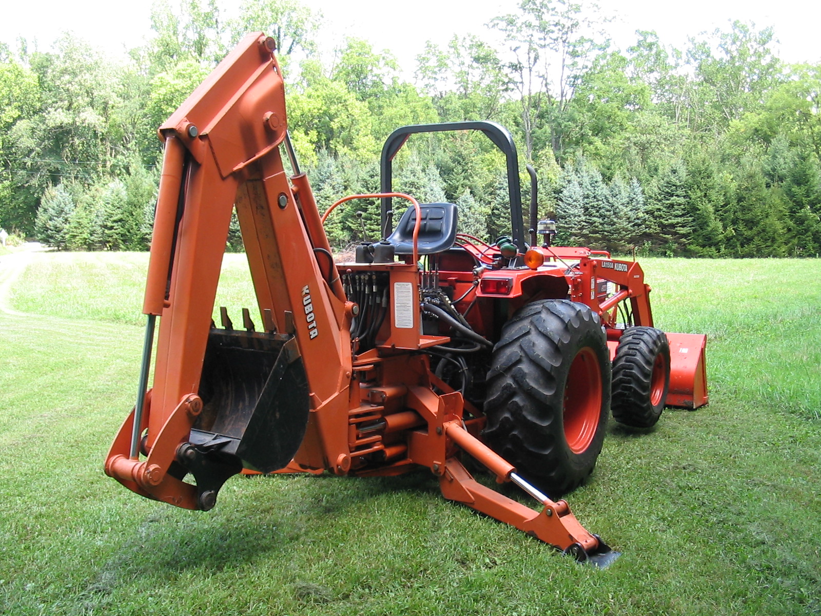

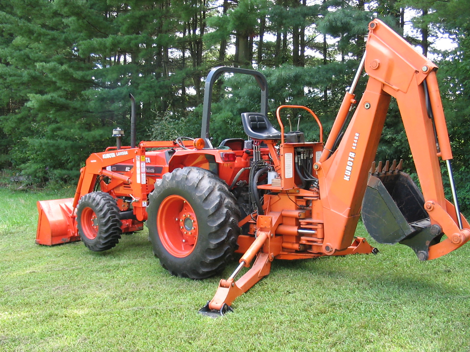

/ L5450 Backhoe #6
I'm admittedly quite late to this thread, but in the event you're still looking for that elusive L5450 backhoe, you might add the L4540A BH to your list. The L4540 and L4540A fit all the L3 tractors, six L models as per Dick's listing above. Here's a few pics of my L4540A on my L5450. I previously used this same backhoe on my L3350. I purchased this BH new around 1990. While this hoe came in several configurations, mine has self contained, internal hydraulic tank and separate Prince 22 gpm PTO pump, thus it does not require remote hydraulics.
