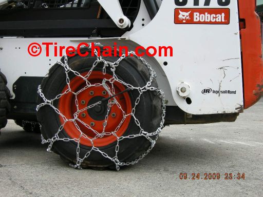

I just got a set of net chains, or European truck chains, from Tirechains.com, which weren't what I orginally thought I wanted, but of course everybody is out of stock after this winter's storms, and I think they would be great for lugged tires. These are really well made chains, and I found Tirechains.com super to work with- quick, helpfull replies, quicker shipping, etc. Maybe now it won't snow again this winter now that I am equipped.

TMC2318, I have a 3240 (same tire size as 3540) and am purchasing chains from tirechains.com for my R4s. What style chains do you have, is the clearance OK, and do the chains fall between the lugs like others are saying?
Thanks for the info.

I purchased two link ladder chains for my B3030 with R4's. I found that the connection link rubbed the back part of the fender well. After removing the rear wheels and trimming about an inch and a quarter off the bottom of the inside fender ... no more rubbing. Of course I primed and painted the exposed steel. Next month I will be upgrading to a L5740 HSTC, I'm tired of being wet and cold!
   / L5240 and tire chains (for snow) #9
I think I got the DUO-GRIP V-BAR but would have to look - it takes a bit of modification to make them work as the width is fine but the length was about 16" or 18" too long. Had to cut off a section on both sides but after that they were fine. Just keep them tight and across the outside of the tire I use 2 tie-straps in an X to also keep them tight.
