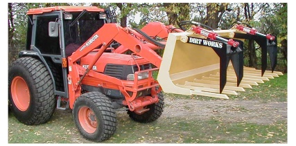

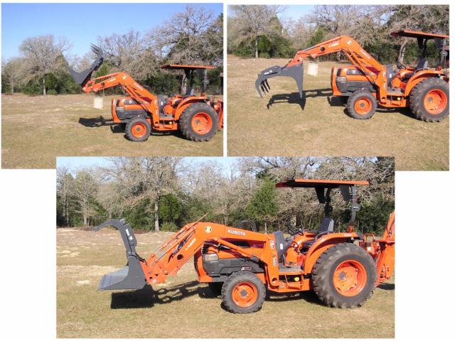

Just upgraded from a l3010 hst to a new /forums/images/graemlins/grin.gif5030 hst , r4s quick detach . heavy duty bucket. I installed 3 kubota remote valves. running a Gannon box scraper with hydraulic rippers , top and tilt.
in the process of fabricating a quick detch brush/ rock Grapple with hydraulics.
Question? ---- what width of grapple are other tractor owners using out their? i dont want it to wide and massive for it's lifting capacity of the tractor. Building it out of 2" round solid 4140 Chromemolly for the bottom rake.

This is what I bought for my L4200… I am sure it is larger than I really needed… I have actually not used it as my 4n1 is too handy. Specifications
• Overall Width..........76-1/2"
• Overall Depth..........36"
• Grapple Width..........17-1/2"
• Tine Spacing..........6-1/2"
• Grapple Height - Closed.....30"
• Grapple Hook - Open.....37"
• overall Weigh..........750#
• Clamping Force.........1250#
• Number of Grapple Teeth....4
• Number of Cylinders......2
• Tines......1-1/2" Solid Square
• End Plates.......5/16"
• Bore...........2-1/2"
• Stroke..........6"
• Rod Diameter.......1.125
KennyV.
PS… Your L5030 sounds nice /forums/images/graemlins/laugh.gif…

I'm also thinking seriously about an Add A Grapple for my smaller tractor. If what you are planning to use it for is primarily brush it seems to be by far the most cost effective way to add grapple functions. If you are a professional landscaper, you might want one of the bigger dedicated grapples, especially if you are picking up big hunks of trees regularly.
Ask CT Tree Guy. John has the same tractor you do and LOVES his big ole grapple. He is a pro so your needs may differ but he'll have more specific advice.
   / L5030 hst #6
Thanks, there is no doubt John will be very thorough AND specific. He does a good job of answering and conveying ideas.
