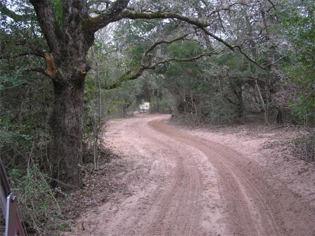

dmltrc, what really impressed me about the HST was the smoothness and the ability to move very slowly without holding in a clutch. I think RaT hit on the wrong ways to operate the pedal, mainly to keep the heel on the floorboard and use lower RPMs. I usually operate my 5030 at about 1800 RPM also except when I mow. To get the 540 RPM I go to a little over 2300 RPM. At 1800 RPM in Low I can push brush and sand till I loose traction. I hardly ever bog down unless I'm in the wrong range.
Since we all love pictures, the attachment is a road I just made by clearing all the underbrush with the FEL and then dragging the box blade. What Fun!
Have fun tractor shopping. /forums/images/graemlins/smile.gif
