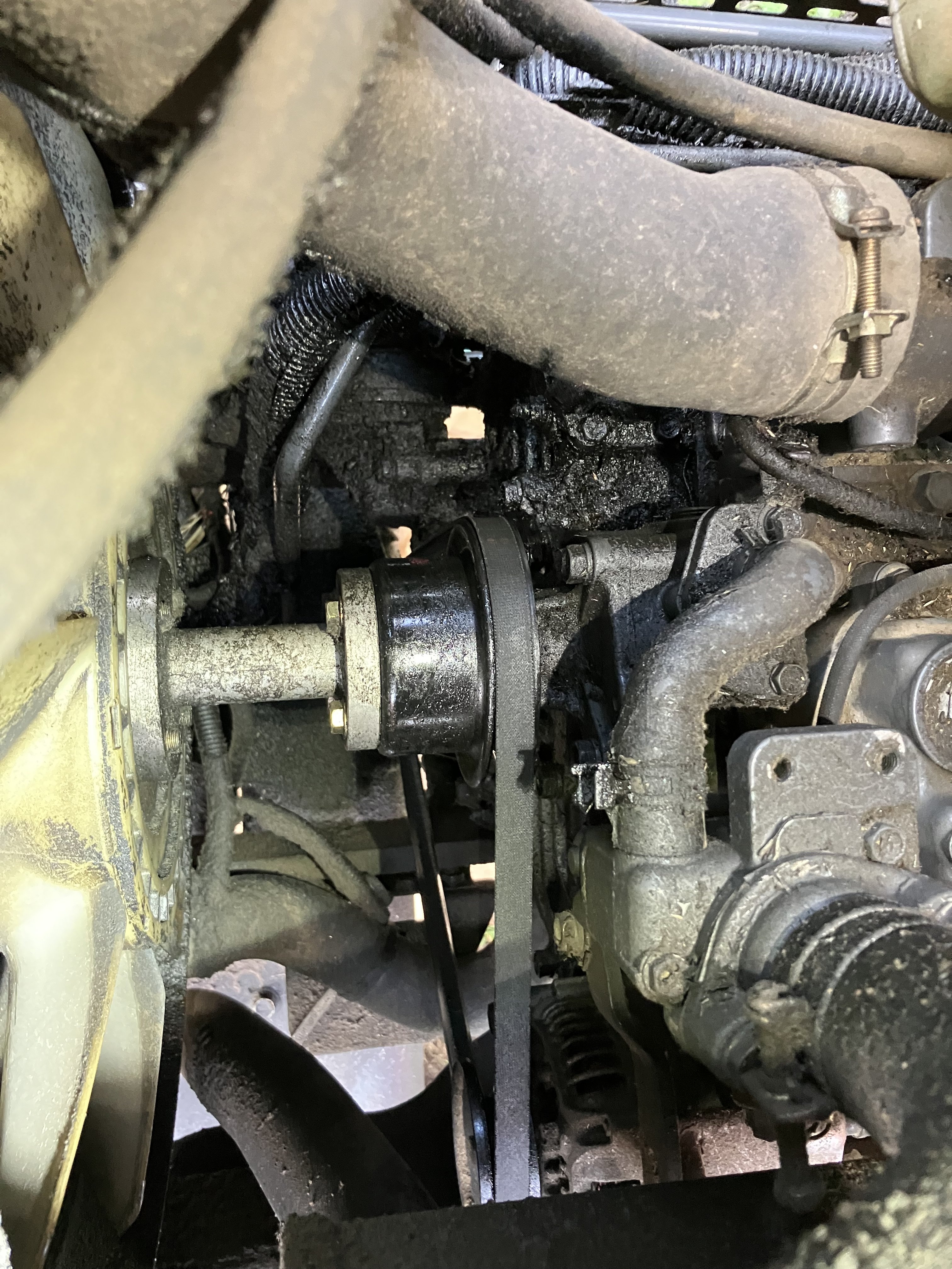

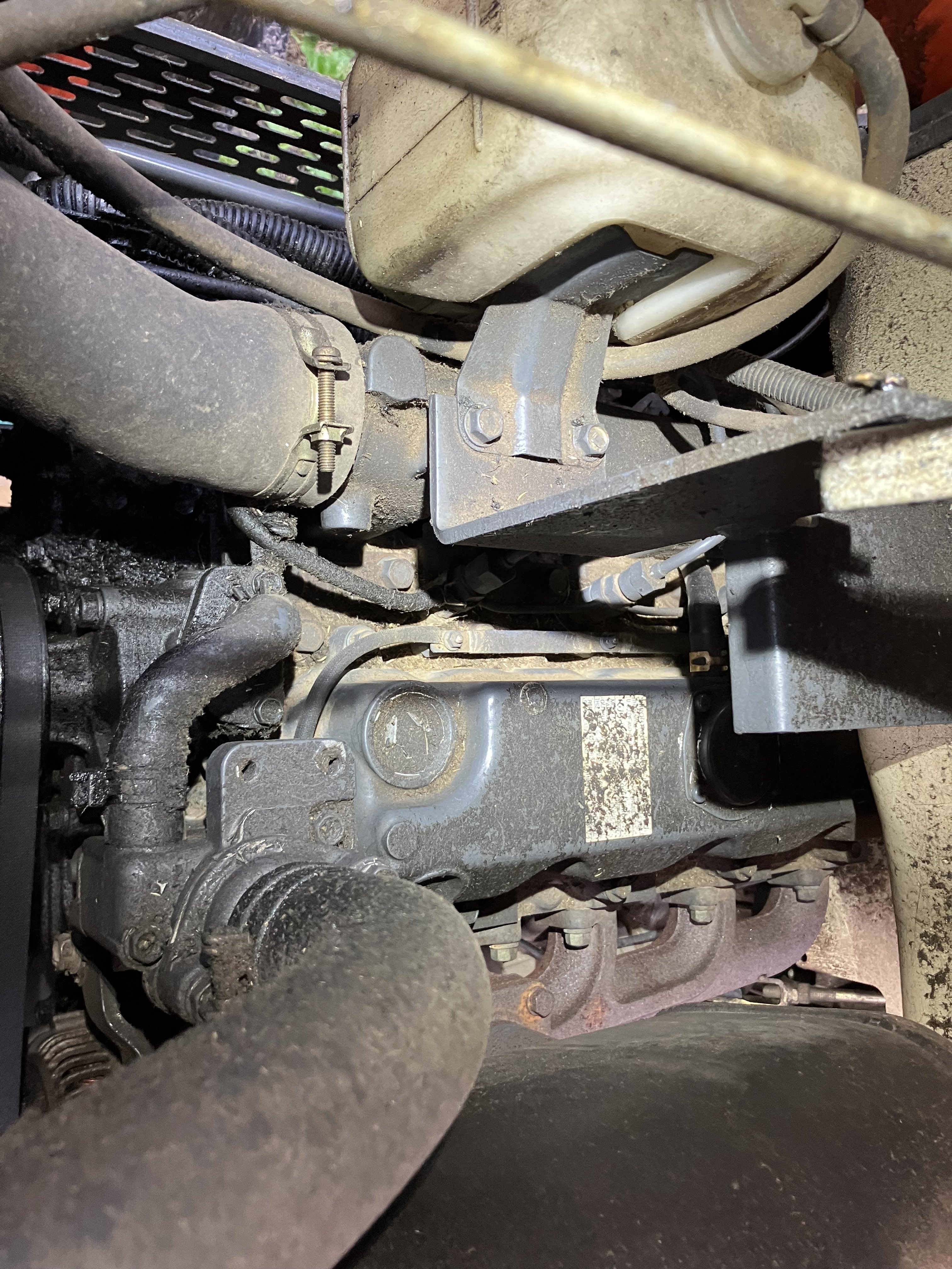

My L5030 has a slow oil leak somewhere at the front of the engine. The oil has leaked enough over time that the radiator fan has caused the oil to splatter across front of engine and even out the right hand side vent of the bonnet cover. There is also some oil that got onto bottom of radiator itself and collected dust/dirt. When I park the tractor after heavy use there is probably a tablespoon worth of oil that drips onto the ground. I'm having trouble determining where this engine oil leak is coming from. Any ideas how to identify where it is from or if there is a common gasket that needs to be replaced? If I recall correctly the tractor has less then 1500 hours.

Here is some pics.
Top of engine is clean of oil:
Definitely seems like more oil collected on the part underneath the air intake hose:
   / L5030 engine oil leak #6
Well, yeah, but I could also think that there was just as much oil on top of the engine but it dried up due to higher heat in that area. The accumulation under/around the air intake hose may be because of getting trapped there when thrown back from the fan and not dried out/burnt off because of lowwer temps there. Say, does this 5030 have an oil cooler by any chance in front of the radiator?

I can say with certainty there was never oil on top of the engine. I've had the tractor since new. There is no oil cooler. Going to see if can identify that one part.
