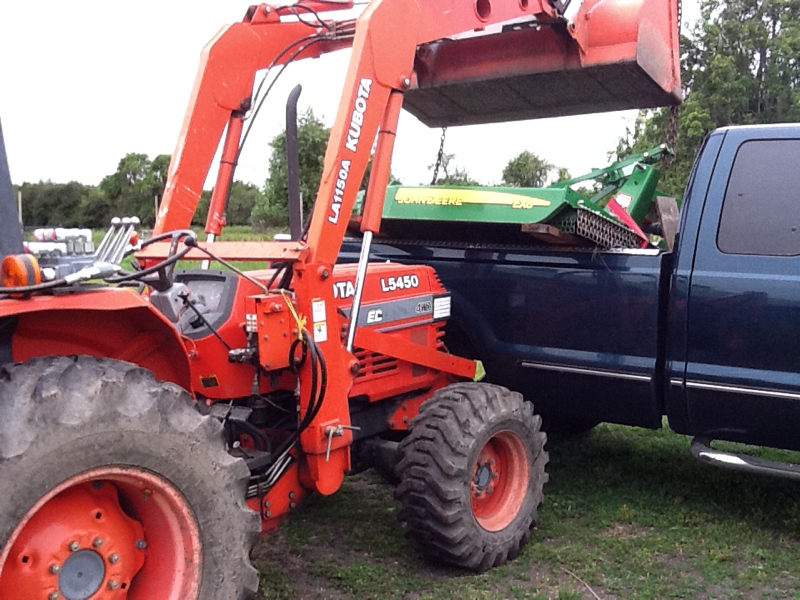

Sounds like you guys have the problem pinned down. Here is my LA1150A with ample clearance above the 6'6" high cab on this pickup. My curl cylinders are extended in this picture so the bucket edge can actually can raise higher. I have R4s so I am not as tall as those with tall ag R1 tires.

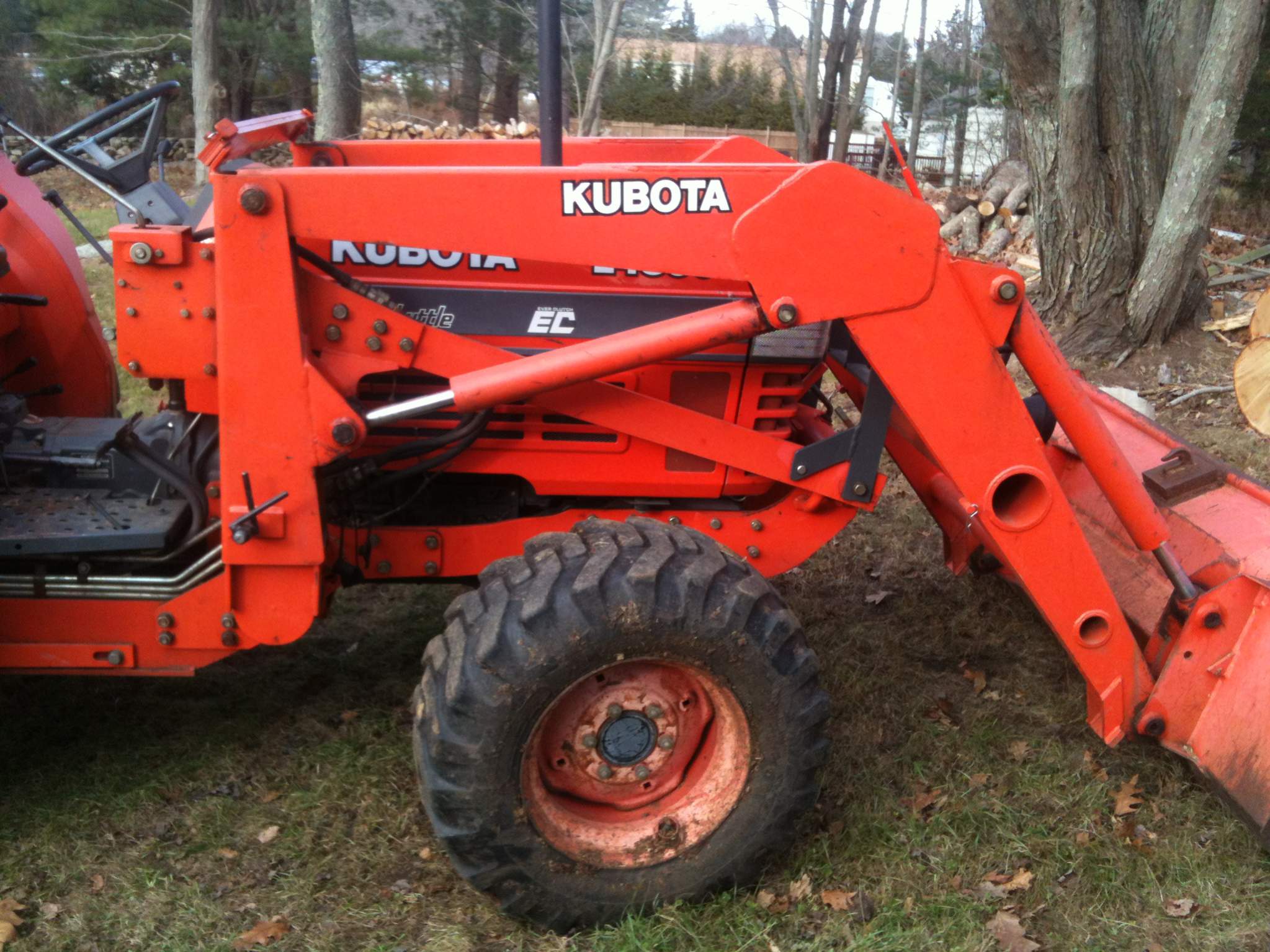

Sorry guys! I had family in from Chicago for the holiday, including my 94 year old grandmother. We turn my office/computer room into a downstair bedroom for her...so I wasn't really able to spend any time at the computer.
First, the loader still has a tag on the side and it is model LA950a (serial 20500), the bucket is model L1774.
The lower lift cylinder pin to main pivot pin is 18" (center of pin to center of pin). The upper cylinder pin to main pin is 39 3/4".
When the bucket is down and level with the ground I have 7" of piston rod still. I am not sure what that would equate to in downward travel, but I can't see why I would need to dig more than about a 12" below the front tires. Based on this it seems a longer cylinder would fit.
My lift cylinders measure 3" OD and 2.375" at the upper pin (where its squared off). One of the brochures had different cylinder sizes.... but it still doesn't make sense becuase the brochure has the cylinder travel at 21.65" which would seem to mean that my cylinders are corrrect...?
clint
   / L4850 with LA950a loader - does not go very high #33
You got er! Your lift cylinders are the wrong length. Seems strange but someone must have swapped them at some point.
#34
my upper lift cylinder to upper bucket cylinder is 17"
Ok, just studied all the different pics... and yes, clearly the other LA950 loaders have longer cylinders. I scaled off of three of the pics using the steering wheel as a know 15.5" and interestingly it seems two of the 950 loaders have 32" long cylinders (from upper pin to end of orange cylinder) and the other had a 28" long cylinder. the 28" cylinder does infact end short of the 5 bolts (support bracket bolts). They probably had ooodles of identical cylinders in the factorys for different loaders and it wouldn't be too difficult to get them mixed up.
I attached a picture of my machine again.
So the million dollar question.... How/where do I get longer cylinders that don't cost a fortune?
   / L4850 with LA950a loader - does not go very high #35
If you take the cylinders to a welding shop, you can get a 5-6" extension welded onto the butt end (non extending end). With the bucket level on the ground, you want about an inch of extended cylinder showing, not the 6-8 you seem to have! That's a "work around", the proper solution would be to get the correct cylinders, but a pair from Kubota will run you enough to cause a serious indigestion where the weld fix is probably a hundred bucks.

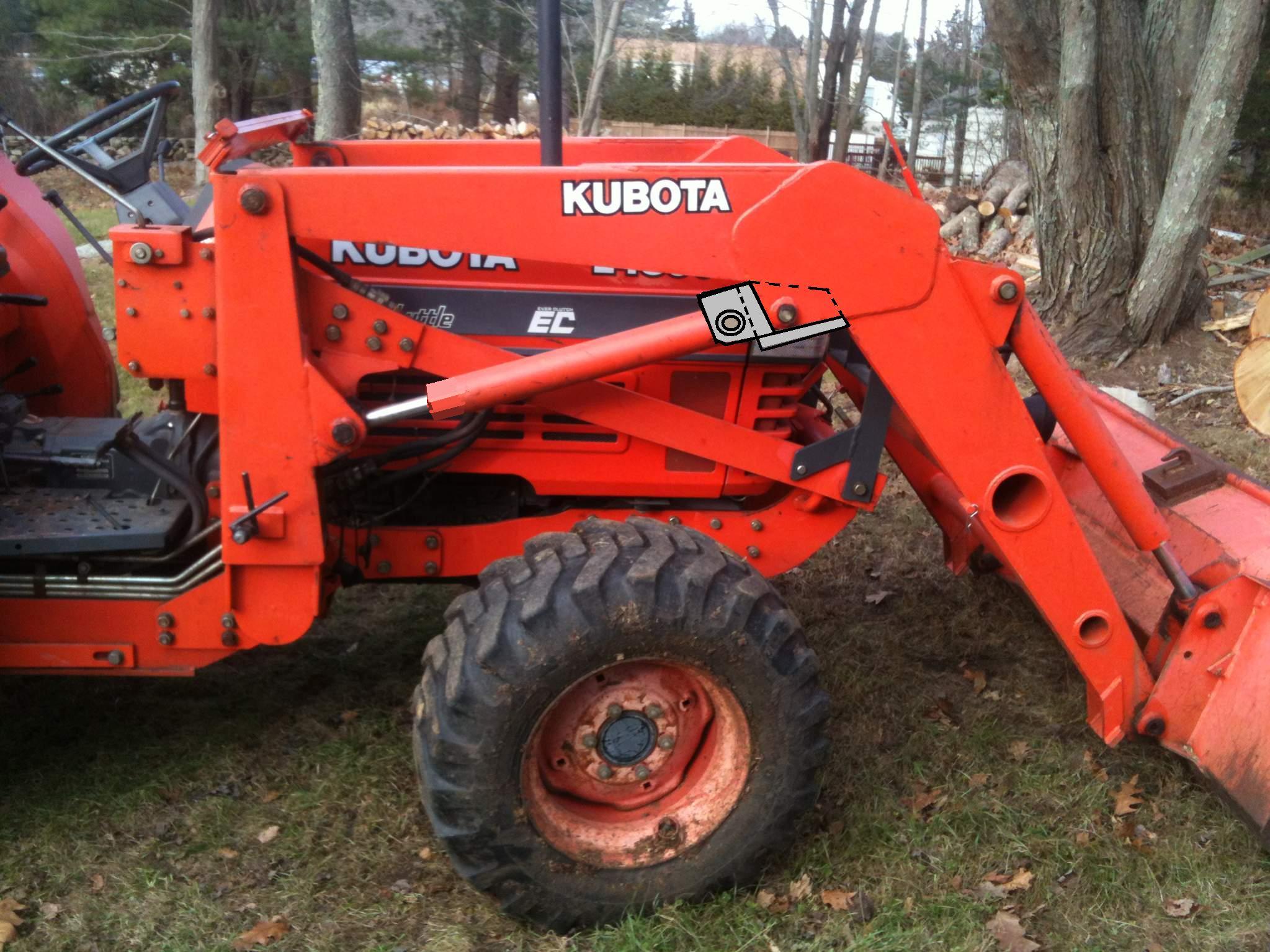

I was thinking that a local fab shop could make a couple extension brackets that would move the pin back a couple inches. They could lock in place using the existing pins, and have new pin locations for the cylinders.
They'd be cheaper than new cylinders and removable in case you change your mind. (see picture markup) You would still have full thrust, just less bucket travel below grade.
