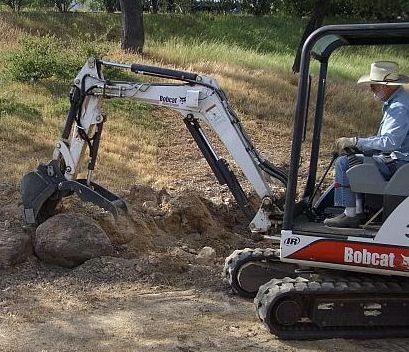

A hydraulic thumb is very versatile, especially if you are going to use it in a landscaping business. I rented an excavator with a thumb to tear down and then rebuild a boulder retaining wall. Attached is a picture of the excavator about to pickup a boulder.
The thumb needs to have the same pivot point as the bucket in order to be able to rotate the boulders when setting them into the wall. After a little practice you can set the rocks fairly accurately the first time. Get a 6' pinch/pry bar to move the rocks those few inches the hoe operator can't seem to get just right.

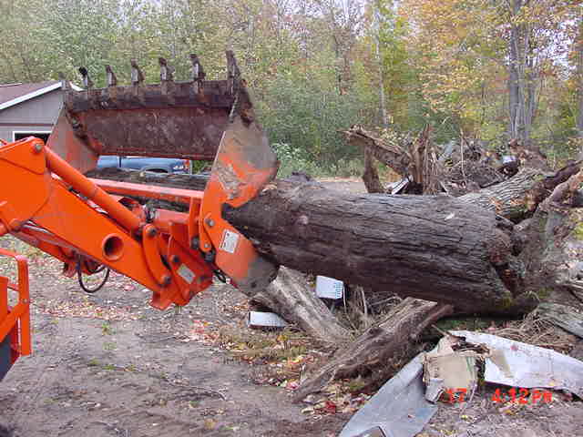

Consider the 4in1, I know you will not be disapointed. The weight will be less than a grapple and the dozer settup is usefull. You can add mods to the edges of the bucket if you need to have more agressive grapple action.

Having the thumb on the boom or using the thumb did not hinder any other backhoe work I did with that excavator. The hydraulic thumb on that Bobcat excavator could be moved out of the way (folded back on the dipper).
You should check what the thumb does on the L48 backhoe. If it can't be folded back up out of the way, it should be easily removable.

I figured out how to post pictures so I will put a couple up to show the L48 in action and the 4in1 bucket with new hooks I just put on it.

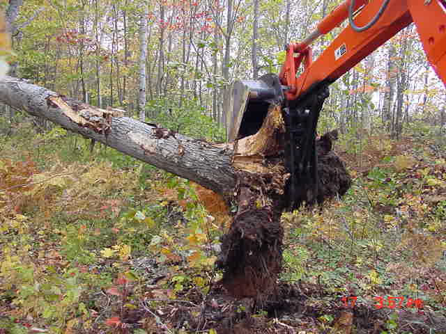

this one is the BH in action with the thumb used to lift and move a 12inch aspen tree. This cause a slight tweek of the hinge pin center plate showing a slight week point in the thumb design. Nothing to lose sleep about but I can see that a 2 plate design would be prefered. The thumb has shown me a great deal of function that I will be using often. Great for pulling brush out or even small trees with little ground disturbance. I used it to lift many large water logged logs out of a drainage ditch. I would have had to use a chain and lots of hard wader work to do this task.
More when weather allows..
