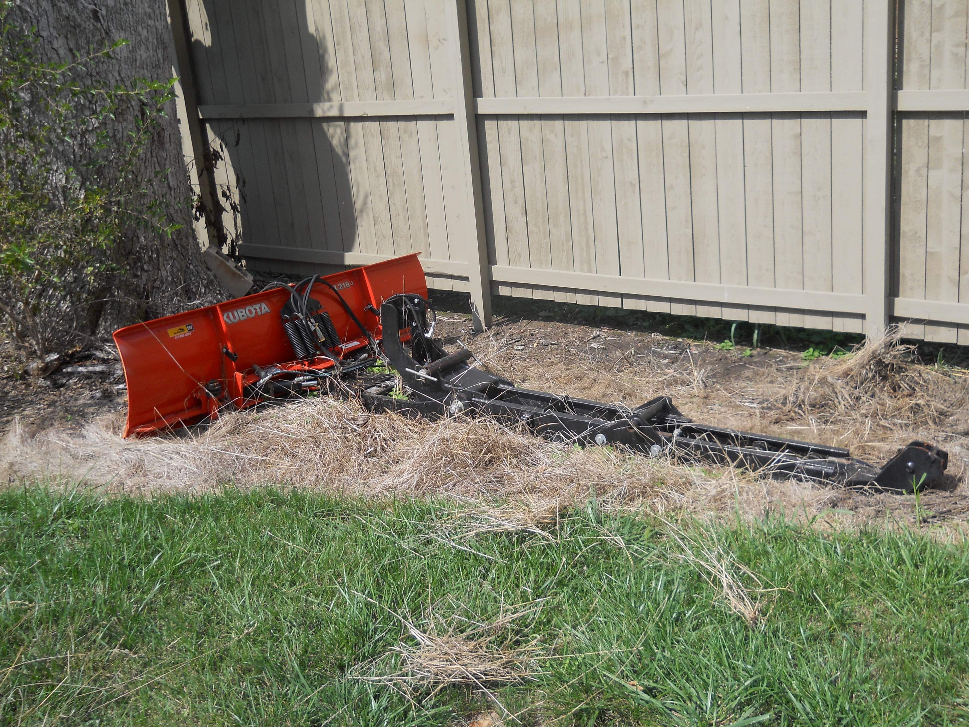

   / L4740 Snow Plow #6
I hardly ever remove just my blade. I almost always remove blade and sub-frame together. I normally try to put 4x4's under the front of the frame so it does not sink in the mud. Are you sure it is a 72" blade? Mine is 7'. Philip.

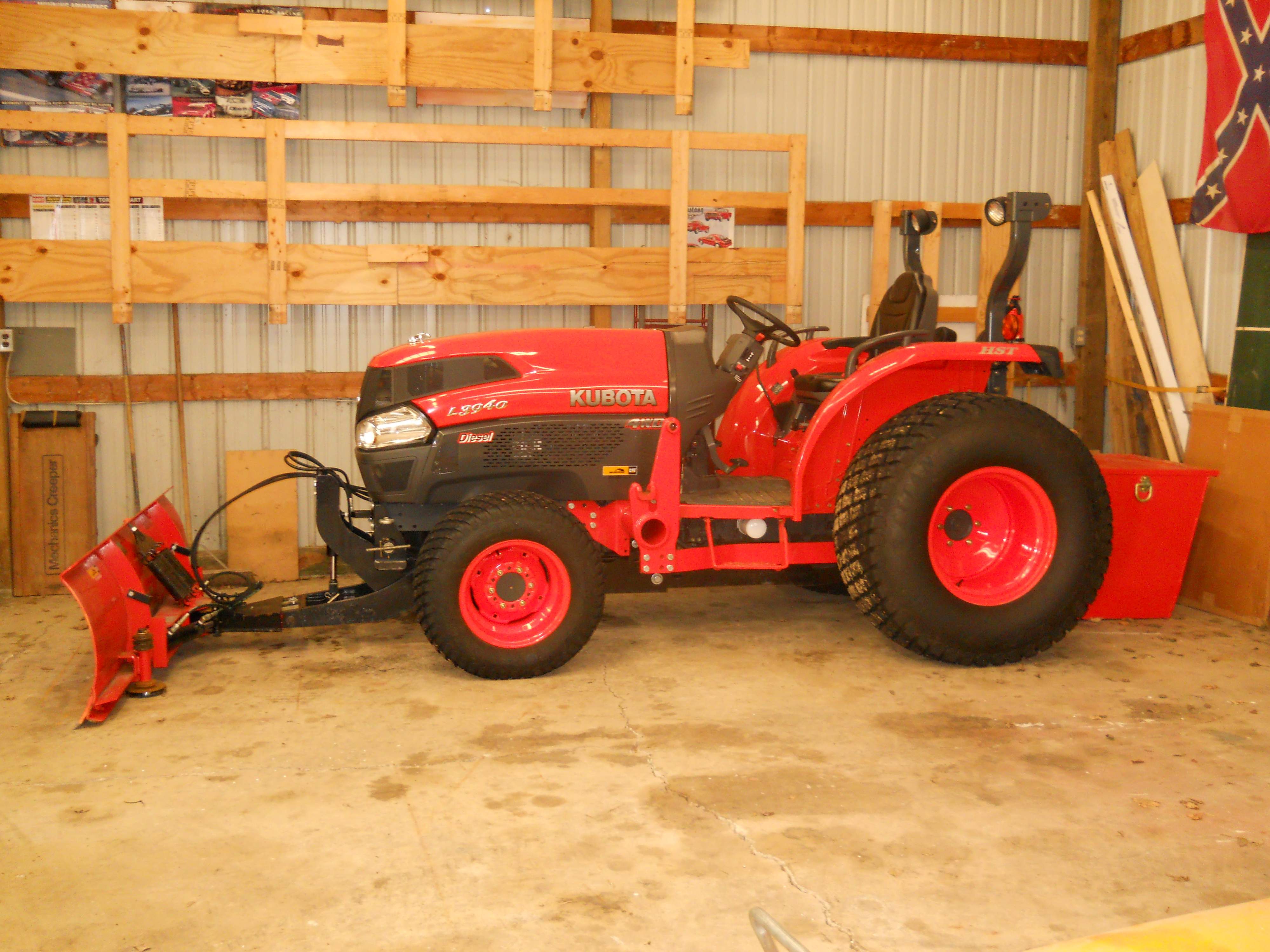

   / L4740 Snow Plow #8
My L3940 with 7' front blade, 1200# rear ballast box, and turf tires do a really good job for me in the snow. Philip.
